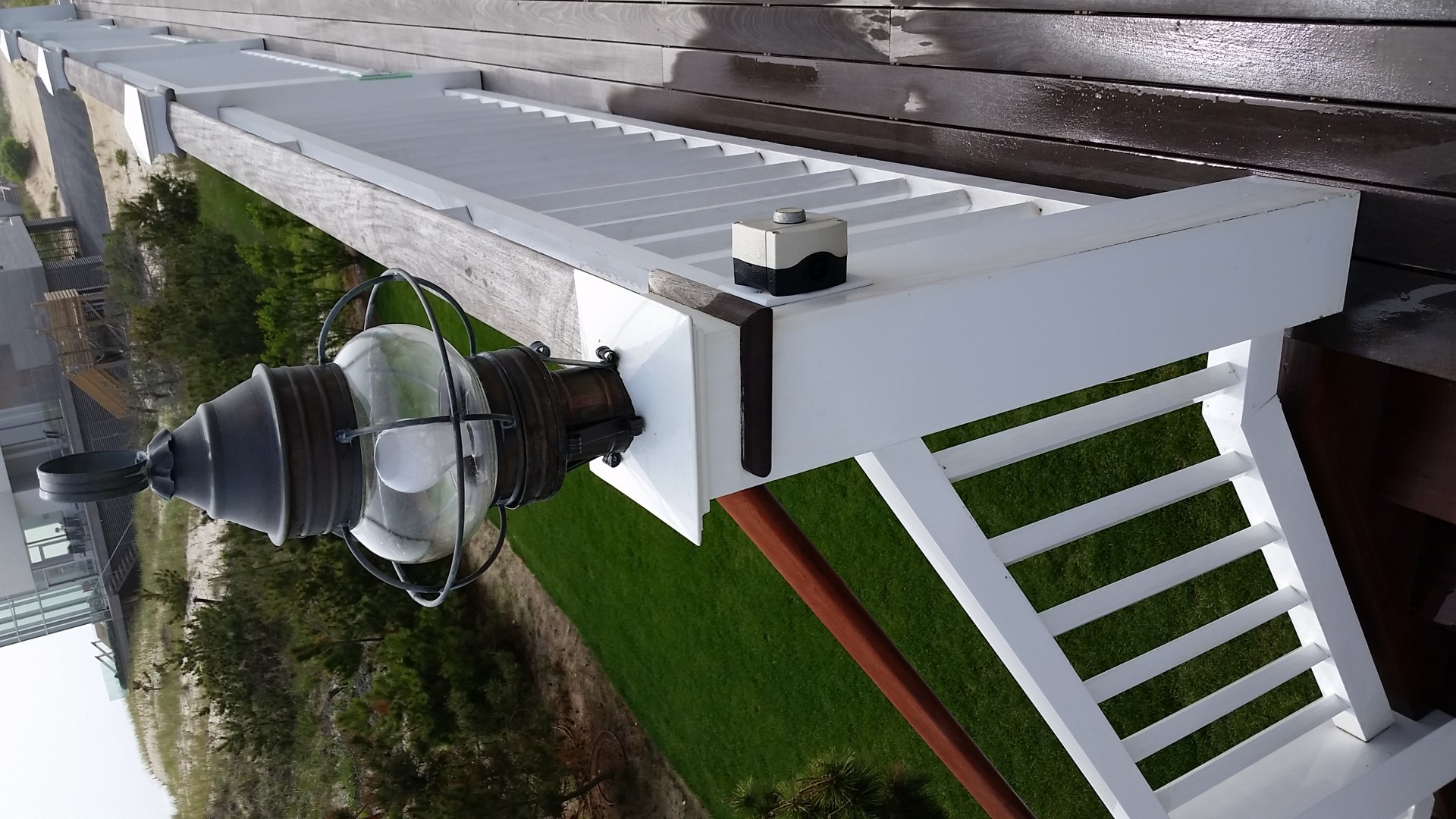

SH is not recommended for decks,
Careful power wash followed by oxcilic acid (brightiner) scrub off deadwood then rinse with white tip.
SH breaks down the lignin but that's the quick way most do, but if just want to "bleach" it, percarb is the safest way and can be softwashed that way.
Notice the difference between the oxcilic acid tread handrail and the untreated?
Just finished this one on the ocean.
