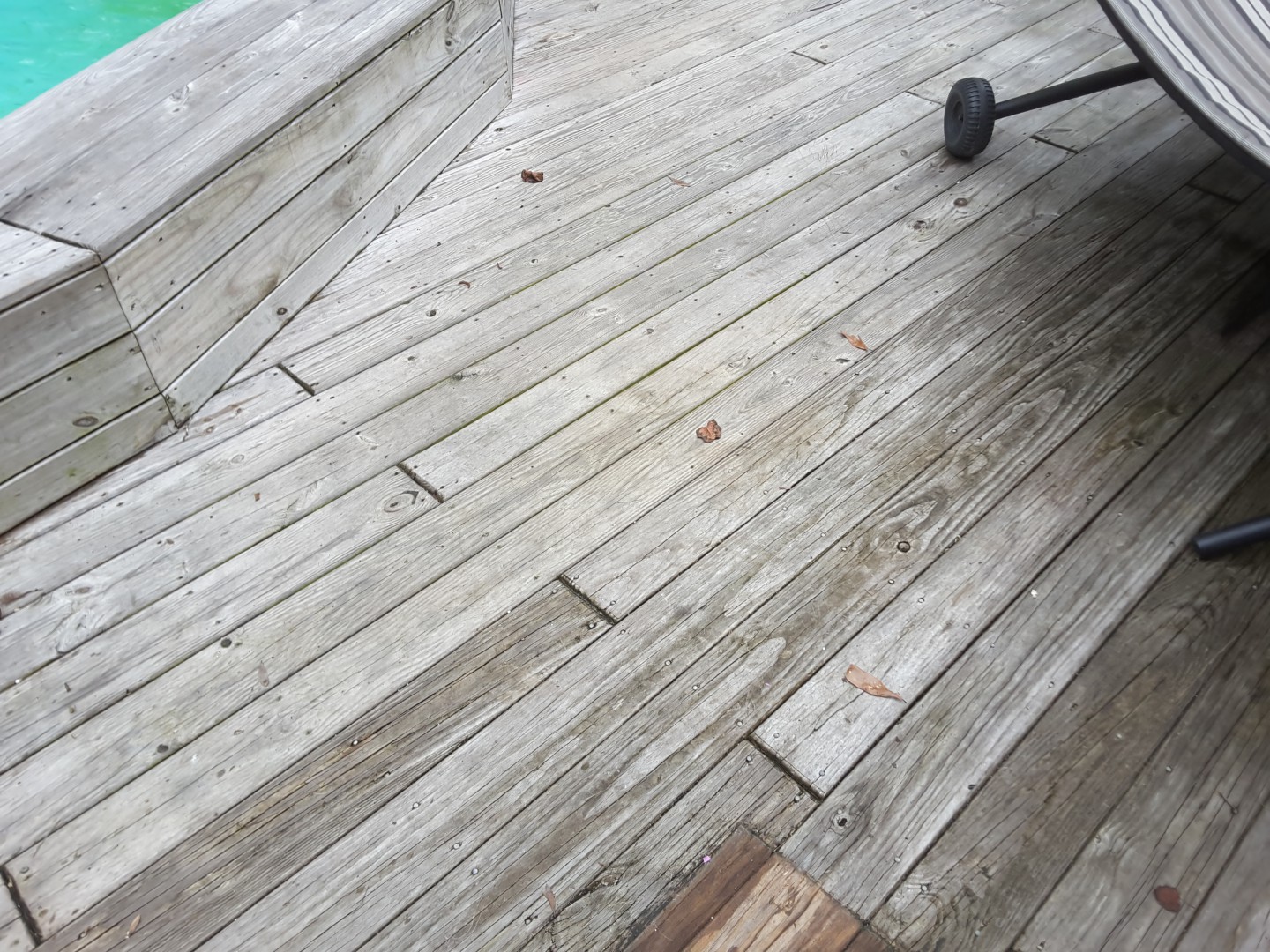

Started softwashIng a deck today and the soft wash just isn't working . So I went and started pressure washing it (old school).
But the wood is still holding black marks. Here is the spots I'm talking about. And another picture of the deck when it's dry. Plain wood as far as I can tell. No stain no nothing.
The first picture looks like "garage" type grease spots? The second picture looks like it hasn't been done yet?
What is your chemical choice on the second picture?
The first picture looks like it's gonna be tough,..because I just don't think that's mold or regular dirt.
Jun 6, 2016
I'm using a deck wash from EMS and 4% sh. Yes the 2nd picture was not done yet, was just showing what the wood looked like.
First picture is by the back door, and I don't have a clue what the black spots are.
Jun 6, 2016
Almost looks as if the grill was there at some point.
Jun 6, 2016
Not a whole lot of choices on those black spots. If it were me,..I'd lay down some degreaser like Purple Power and let it dwell for about 15 minutes and then hit it with medium pressure and see if any at all comes up. That isn't typical deck cleaning. Ask the owner of the deck if they can give some insight as to what it may be,..knowing what you're dealing with in this business is the biggest part in knowing how to deal with it. Maybe a stiff bristled deck brush to work at those spots would help,..likely when this is done,.it will need sanded,.and then even a medium colored stain to help hide the remnants of the cleaning.
Second picture,..Sodium Hydroxide 8 OZ. per gallon,..DS'ed and then rinsed away,..and then use oxalic acid mixed about 12 OZ. per gallon and DS'ed And it will be good. Or Sodium Percarbonate mixed about 8 OZ. per gallon and applied direct and neutralized like above mentioned with oxalic.

I put 1 gallon of SH and 2 gallons water in my soap bucket for Downstreaming. Plus my detergent. Think it's two weak?

Weak and the wrong product.
