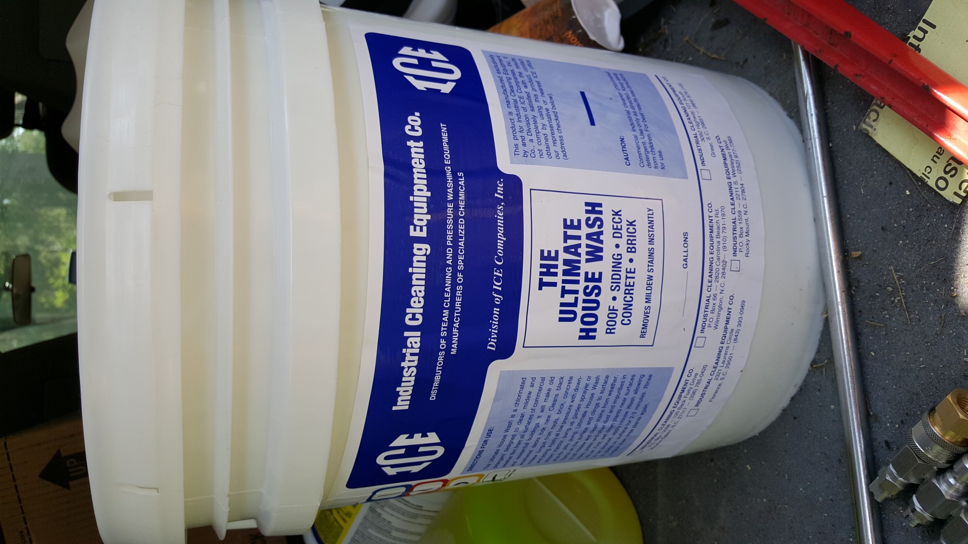

We just got in out new house wash to try out. I'm very excited to try this stuff. Straight out of the bucket it already has the 12.5 SH in it and is a foaming agent.
Right now I'm paying 109.00 for 4 gallons of wash deliverd. And I still need to buy the SH.
The new stuff from ICE cost 200.00 for a 55 gallon drum. And no need to buy SH..... really hope this stuff works! THEY WILL ALSO DELIVER IT FOR 15 BUCKS. WOOHOO
Supposed to clean vinyl, wood, stucco, concrete and roofs. Not sure about the roof though. I've been told plenty time that you can't clean a roof with DS. But that is what the salesman is claming.
IS IT TO GOOD TO BE TRUE?

ICE stands for industrial cleaning equipment.
They are all in NC And SC.
I went there and there were 4 other softwash companies there as well picking up parts and such for there equipment. I talked to them and they love it, so I don't know well be using it tomorrow on my house to see.
I'll do a video for yall.
Instructions say to add 2 gallons to a 5 gallon bucket and fill the rest with water.
So that's exactly how in going to use it. I'm not going to add any extra SH to it. Just to see if thier claim is true.

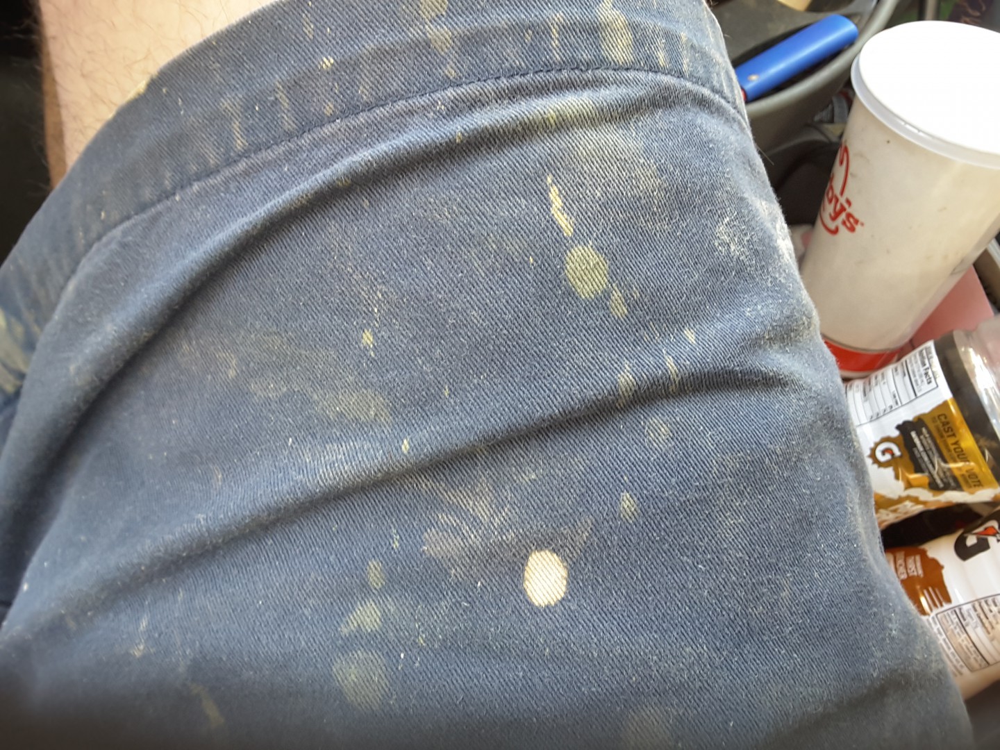

What can I say? You guys were right agian!
I washed two houses today, and used the last of that house wash to do the first one. On the 2nd one I used my own mix like yall suggested. And my mix is much stronger.
My mix was 1 gallon of 12.5 sh and 2 gallons of water plus 1 cup detergent . Then downstreamed.
My mix is much stronger. In the picture you can see 2 distinct bleach marks on my shorts. I'll let you guess which one is from my mix lol

Here's a picture
And 55 gallon is 200
