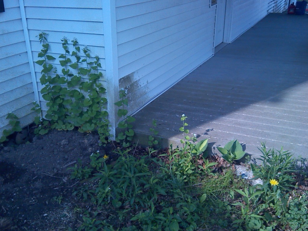

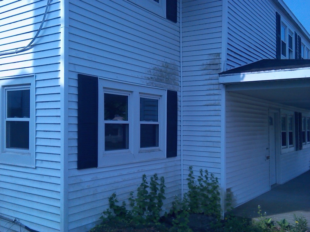

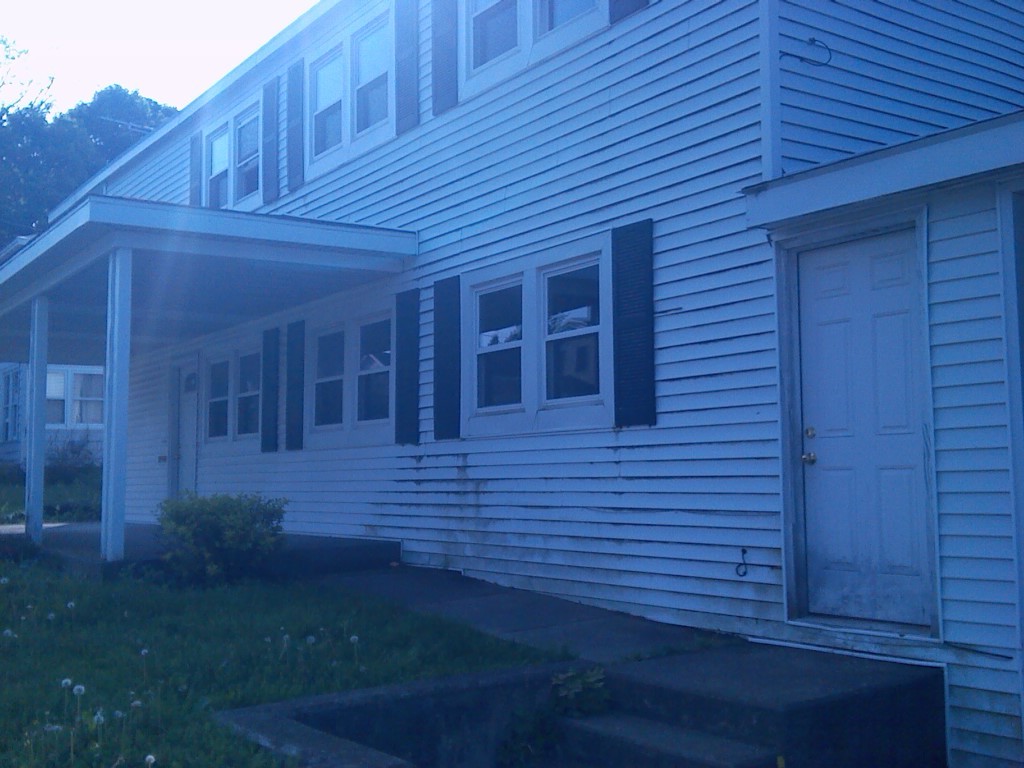

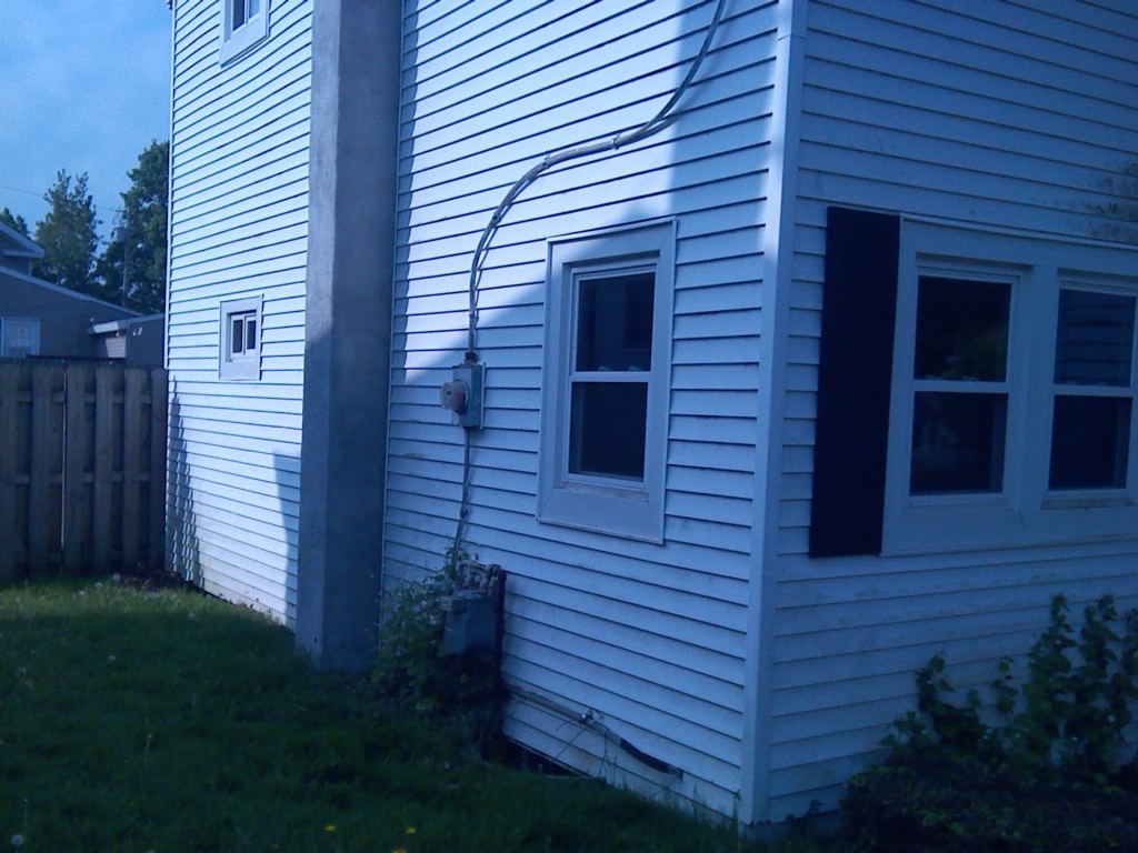

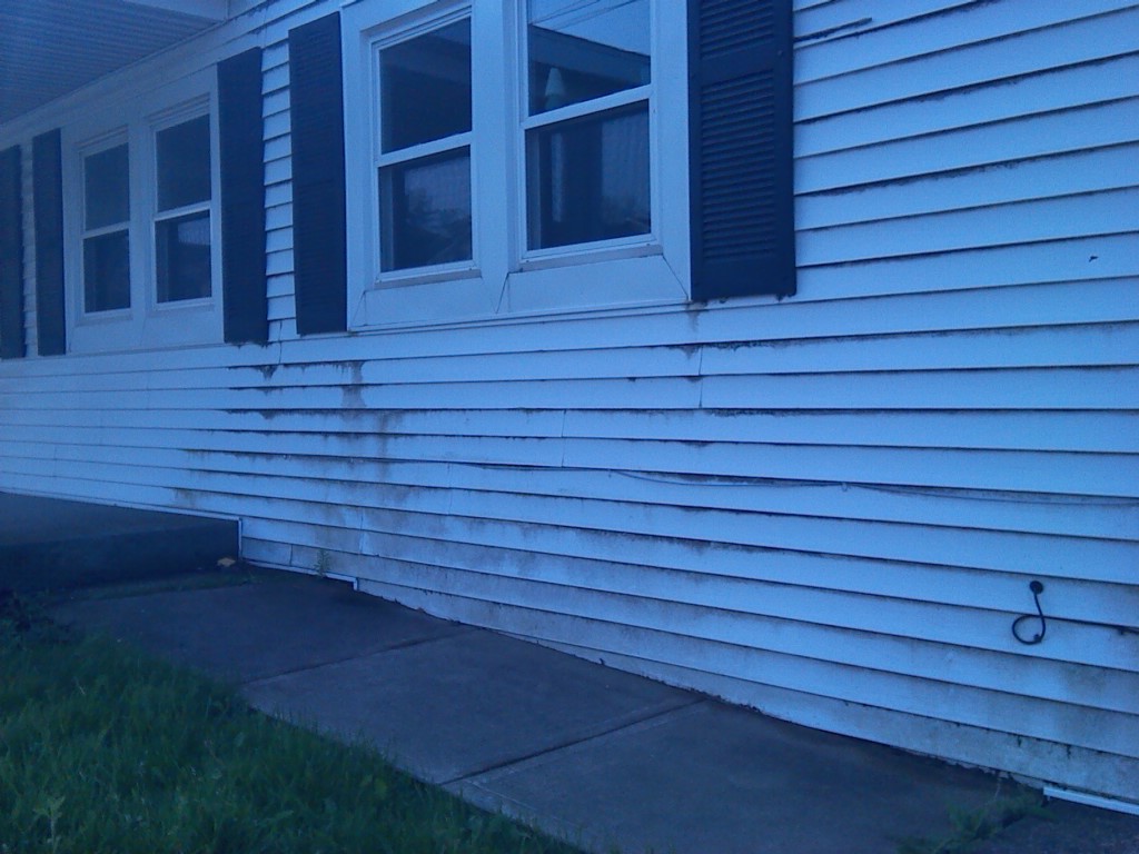

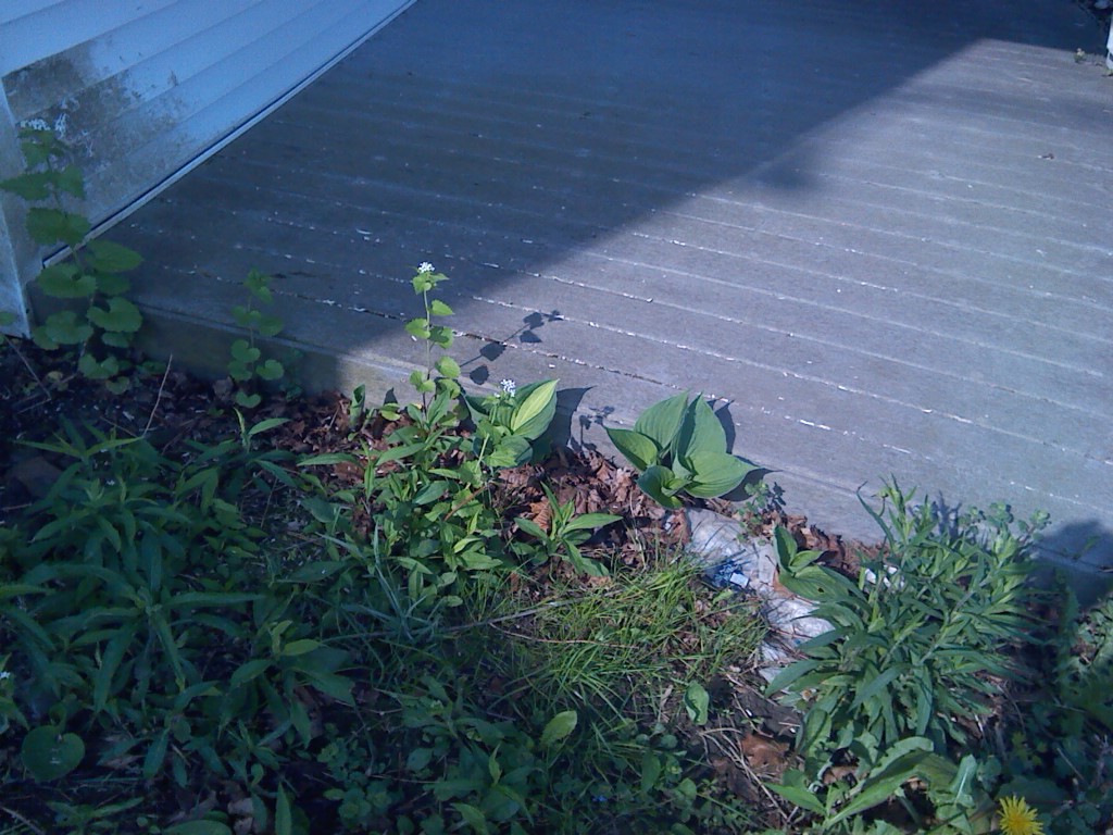

Some before pictures of a cleaning job we did. Spent to much time cleaning this house and decks, couldn't just spray on and rinse off had to power wash everything. House has been sitting for about 5 to 6 years with nobody living there. Hit the siding with 3% SH with some gain in it. I think i should of went with a different mix.
I think you may have bad bleach. I've had that problem a time or two lately. You should have been smoking that algae off the house with a 3% (assuming you mean 30%) and Gain works pretty well, actually. I use a 1% mix on vinyl. I literally just get it wet and let it dwell then rinse. The algae dies almost instantly.

We see this type of conditions very often around here. A 3% mix should have done it. Worst case... a reapplication should have done it for you. Perhaps you could share how you mix your chemicals and how you applied your mix(dedicated pump, downstream or x-jet.) Was your SH hot when you got it? What was your dwell time? The more info you share the better so we might help you.

3% should rip the algae off and is way too aggressive for vinyl siding. Art's question makes me wonder.....Did you use Clorox and if so did you dilute it at all? When you say 3$ do you mean you started with a higher concentration then diluted down to 3% or is 3% what the bottle said?

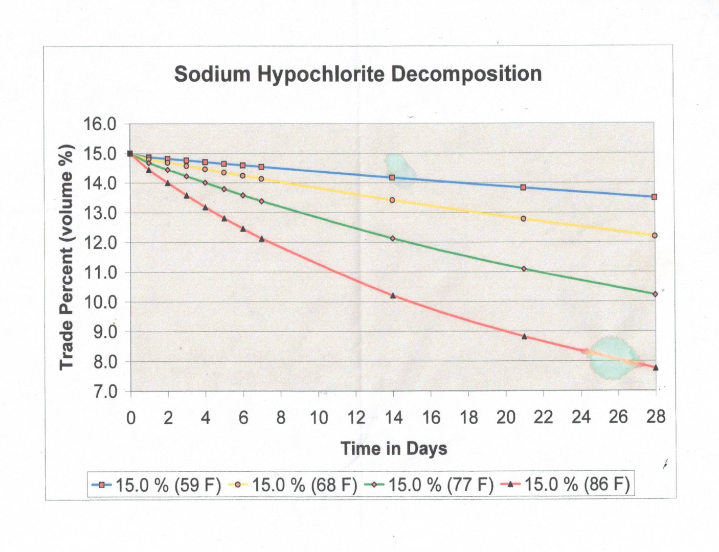

What the bottle Says percentage wise does not mean what it really is as SH degrades due to time and heat, UV etc.
5% on label may be 1% by the time used.
You can find charts all over the Internet related to degregation but here's a interesting read
I do have some Superchlor it's 12.5% to 15% but i didn't use it. I was in a hurry and i picked up some concentrated bleach from Lowes and cut it in half.
I had some bleach that was so weak it wouldn't clean a roof last week. I had to cancel a job on Monday due to a truck accident and left the bleach on my truck for two 94 degree days. On Wednesday I had 25 gallons of useless bleach. I just kept adjusting it until it worked...had to spray it almost 100% but it cleaned. Sometimes you just have to get creative and use what you have. I wish you had a do-over on that one...I bet you'd get it right.

Byron, 2 days out in heat can affect SH very much, the higher the % the faster it degrades. When first produced it is roughly 15+% but quickly degrades in days to 12-10%, it's instability is why it's kept in white containers.

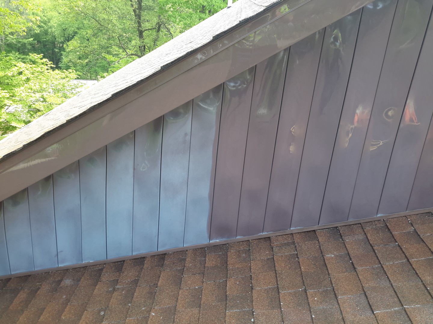

I used Agent Blue that I get from Powerwashstore the other day on a really badly oxidised brown vinyl siding that was 15 plus year old. It immediately removed the oxidation and restored the color back to looking like new. Really surprised us!
The other product we use that is very good but can be pricy so you have to charge for it is
Vinyl Renu. they make a oxidation cleaner that works great and is a prep step for applying the Renu Sealer
www.troublefreepool.com/threads/60837-Breakdown-of-bleach-over-time-by-storage-temperature
I see it didn't work like i though.
Bleach Decompose Chart
@ days should not have degraded your bleach Bryan, if its in a sealed container. Even if you were referring to your mix tank 2 days is pretty fast. If you were refering to your mix tank than I would question the surfactant.
No it was in a holding tank (like a water tank) on my truck. Just bleach...nothing mixed. All that said, I'm questioning that a valve on my proportioner is screwy so I'm gonna have to check that out. It may be that the valve wasn't giving me enough bleach. Need to talk to someone with a proportioner to figure it out.
