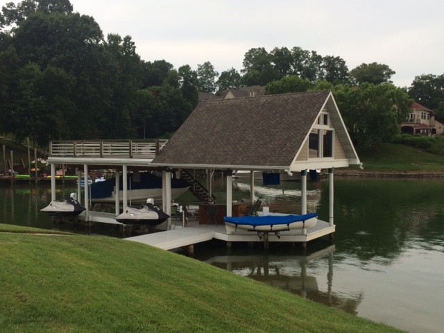

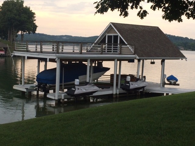

Saying no to this one really isn't a good option for me. It's a customer from my other business that wants me to do this too. I know you're not supposed to use bleach over the water...it would be easy to clean that way. Any suggestions? This is cleaning algae, spider webs, dirt, etc. of all the siding gutters, support posts, etc.
I think just water and a broom. Maybe hand wipe. I'd like to know as well since I have walked from two of them.

Ha! Well, I'm not cleaning the roof. It's the gutters/soffit down both sides, plus the gable on the end with all the windows. It's covered in spider webs and algae. Anything I sprayed there is dropping right in the water.

Maybe if I pressure washed it with just water first to get all the big stuff of, then went back with light mix to kill the algae. I'll keep thinking on it. Thanks for the input so far. One of the hard things is access on that gable end. He said the last tied himself to the post and leaned out over the water.
