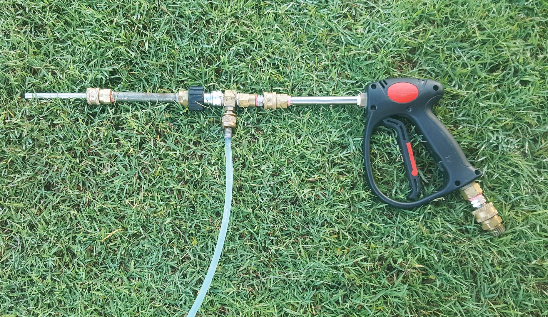

I haven't tried the assassin but somehow ended up with a ladder saver nozzle and it works well.
I don't run chems through my pressure lines as it shortens their life, but I run up to 5500 psi.
That set up below shoots a good stream 2-3 storeys and that's what I use for many jobs.
Haven't looked lately but think it is still shooting at about 600 psi. Fantastic for blowing spiders off two storey buildings.
Pretty impressive how many fittings you cobbled together to go from the wand socket to the ladder saver tip. Bonus points for throwing a screw connect fitting into the mix as well
