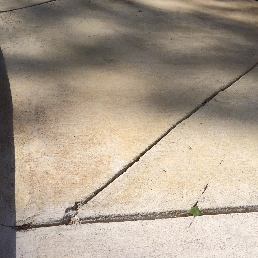

Anyone know anything about stripping sealer from concrete. Owner doesn't know what was used, but it is yellowed and splotchy, so I'm guessing some sort of polyurethane.
If you've done it, I'd like to know if this is a "no. never again" kind of job. Seems like a lot of tedious work. Scope of work is to strip existing sealer, clean and reseal. about 4000 sq. ft. of driveway.

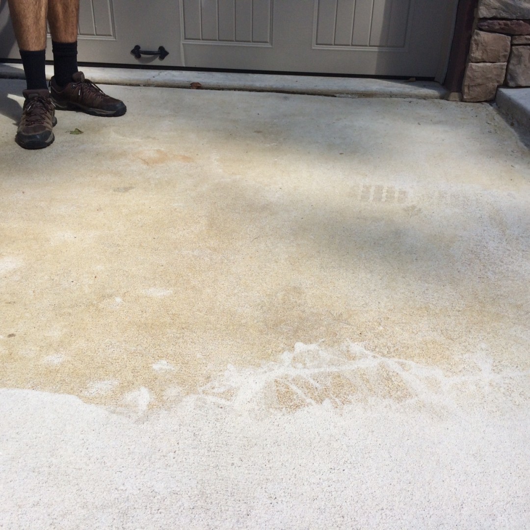

Here are a few photos. The one photo (the guy's feet are in photo) has a section that he did himself using a product called SureKlean. It seemed to work but only works for 50-75 sq. ft per gallon!
Personally I would run from that. You could bust your hump for 2 or three days and still not deliver acceptable results.
