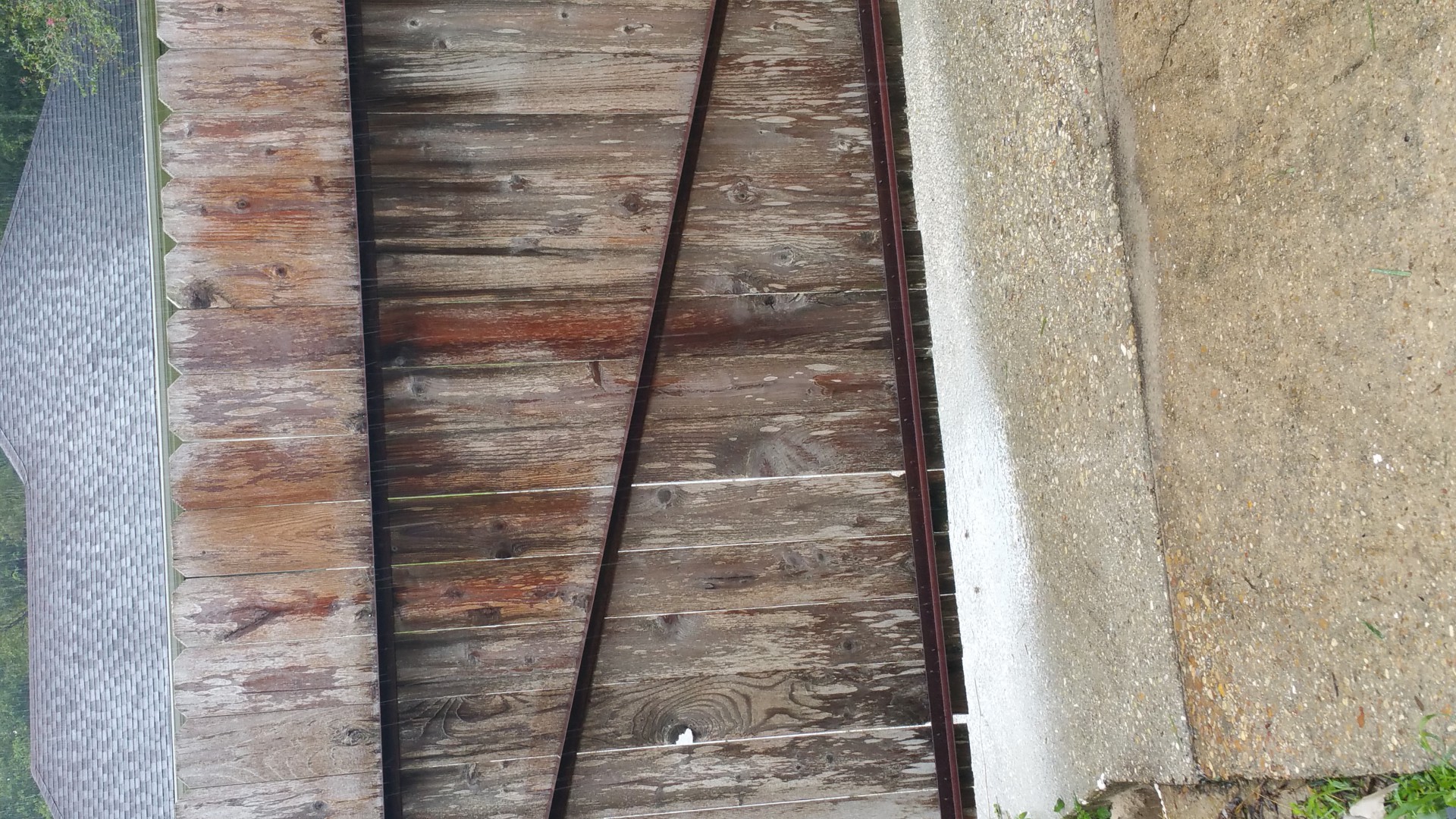

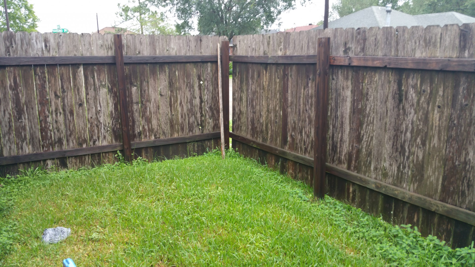

Hello everyone I have a small problem l. I was cleaning my fence with a 2% mix and the fence now looks better but it's kinda white and if I scrub with a brush it seems to come off. Do you think it is a coating that is coming off? I am not the one who had this fence put up so I don't know if they put a coating on it or if its the pressure treatment that comes with the fence boards from home depot
-- Edited by Trent Blanchard on Friday 12th of August 2016 07:38:40 PM
It is likely the pulpy wood,..caused by the bleach.
I'm not criticizing,.just stating what your dealing with.
If I were cleaning that fence I would have either DS'ed NAOH or applied Sodium Percarbonate at 8 OZ. per gallon direct,..and then neutralize with oxalic after either cleaner.

Did I use to much bleach? I have seen people use a bleach mix to clean fences.
Aug 13, 2016
Always pre wet first and Brighten with OX last
Aug 13, 2016
You need to be careful with wood. From fences to doors, decks and even siding. Pre-wet to start then listen to those above. SH is not the end all be all and is only good for certain applications.
Time and experience will tell you what to clean so it's awesome that you learned this lesson on your own fence. What I would suggest is to do smaller areas next time. In other words.......do 1/4 of the fence and see how it comes out.....then adjust as needed.
I often cover a wood front door and hand clean with more appropriate cleaners. At times it's best to pre-wet, spray, then rinse rather quickly.

Thanks for the input. Yea I only did one side of the fence and only about half of the side. It was also raining for 2 days so the fence was already soaked. Do you suggest I use sodium percarbonate?

probably need to scrub, the dead layer of wood like Jeff said. definitly use a brightner (an acid like oxalic or critrus) to nuetralize the SH (a base). percarb is the choice oxidizer for wood (basically creates hydrogen peroxide) followed by a brightner.if you dont put a finish on it, it'll turn grey again real fast. I mean weeks.
PS, Arts right, looks like sealer, better off with penetrating oil or a good sealer like Sikkens Cetol
