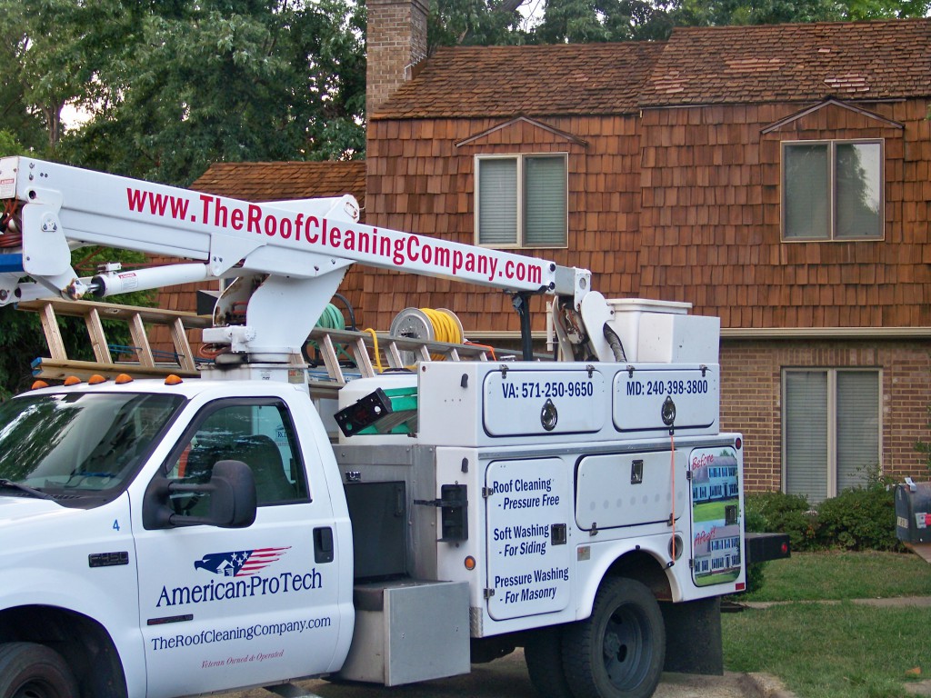

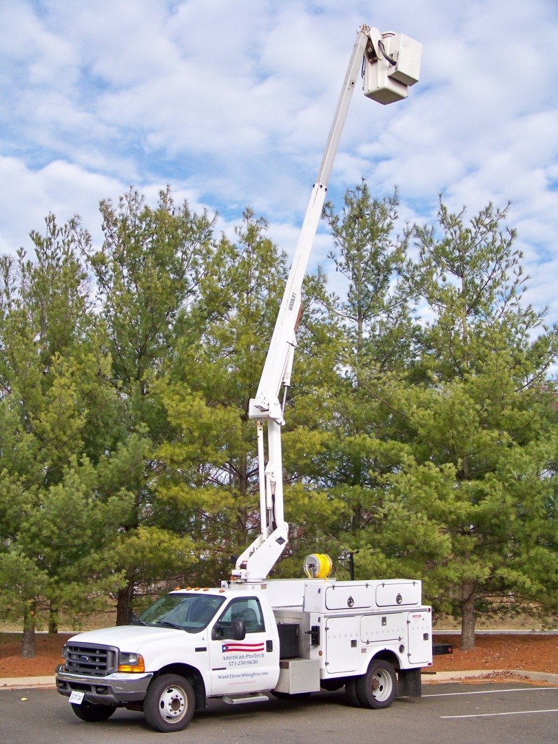

Hi Eric. I had one for a number of years and loved it - mainly because I'm terrified of heights. It was a great work truck and sent the right message to our client based as far as I was concerned. To me, it sent the message that we meant business. And being logo'd up, it was good for marketing and branding too. The down fall is they tend to get showered in SH when in use, and it takes it's toll. The corrosion started to really get bad on mine and I sold it before it became a rust bucket. I would have purchased another, but I've gone a different direction, and no longer need one. I may get one again anyway. I'll see if I can find a picture to add to this post.
Here it is again with revised graphics. The URL on the boom was the best money I ever spent. Choose very carefully. A lot of 37ft lifts out there. I'd go 42ft working height, up-and-over at a minimum That extra 5 feet makes a huge difference. This truck was powered by a 7.3 diesel, and the boom was PTO powered, and it had 12v back up emergency power. Some require generators to run the hydraulics.
Ok Brett, I'm sort of in the same boat, I will keep in touch as far as the direction and design we decide to go with.
Ted I'm glad you chimed in. I was hoping to hear from you since I remembered your truck. That's some good insight. I will probably be contacting you with some questions.

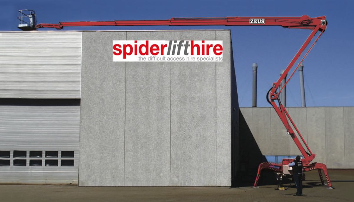

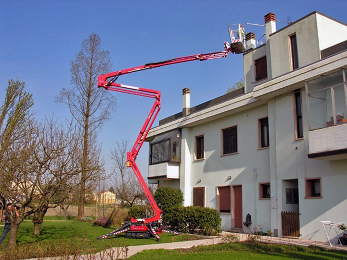

I love these spyder lifts, the one I use is 6 pounds per Sq ft I think so it's safe over sprinkler pipes etc. 30 inches wide goes thru door and gateways.
-- Edited by Maverick Contracting on Saturday 17th of September 2016 02:46:48 AM
That's a monster. Little more than I'm looking for. Nice Though.
