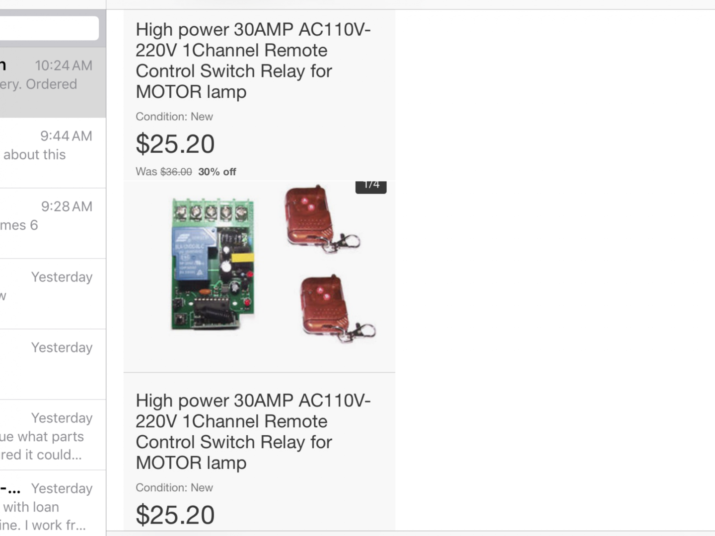

Any ideas on how to start and stop a booster pump motor with a remote?
Andy,.there are AC wireless remotes,.you just have to search for one with the correct amps. I'd think maybe one that operates a garage door could be used. I know they are also made for things like security gates. Here is one used for lamps.
http://www.ebay.com/itm/1x-Wireless-1-Way-ON-OFF-110V-Light-Lamp-Digital-Wall-Control-Remote-Switch-US-/311354992533?hash=item487e342795:g:imYAAOSwBahVS3X4
Going to try this

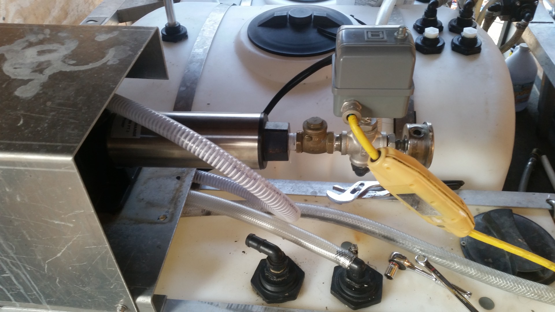

Andy that will work but a pressure switch will actually work better and you won't have to carry a remote around with you.
I must plead ignorance. I'll study up on a pressure switch
In order to install a pressure switch you will need an isolator to keep the SH out of the switch. If you just install the switch it will fail soon.
