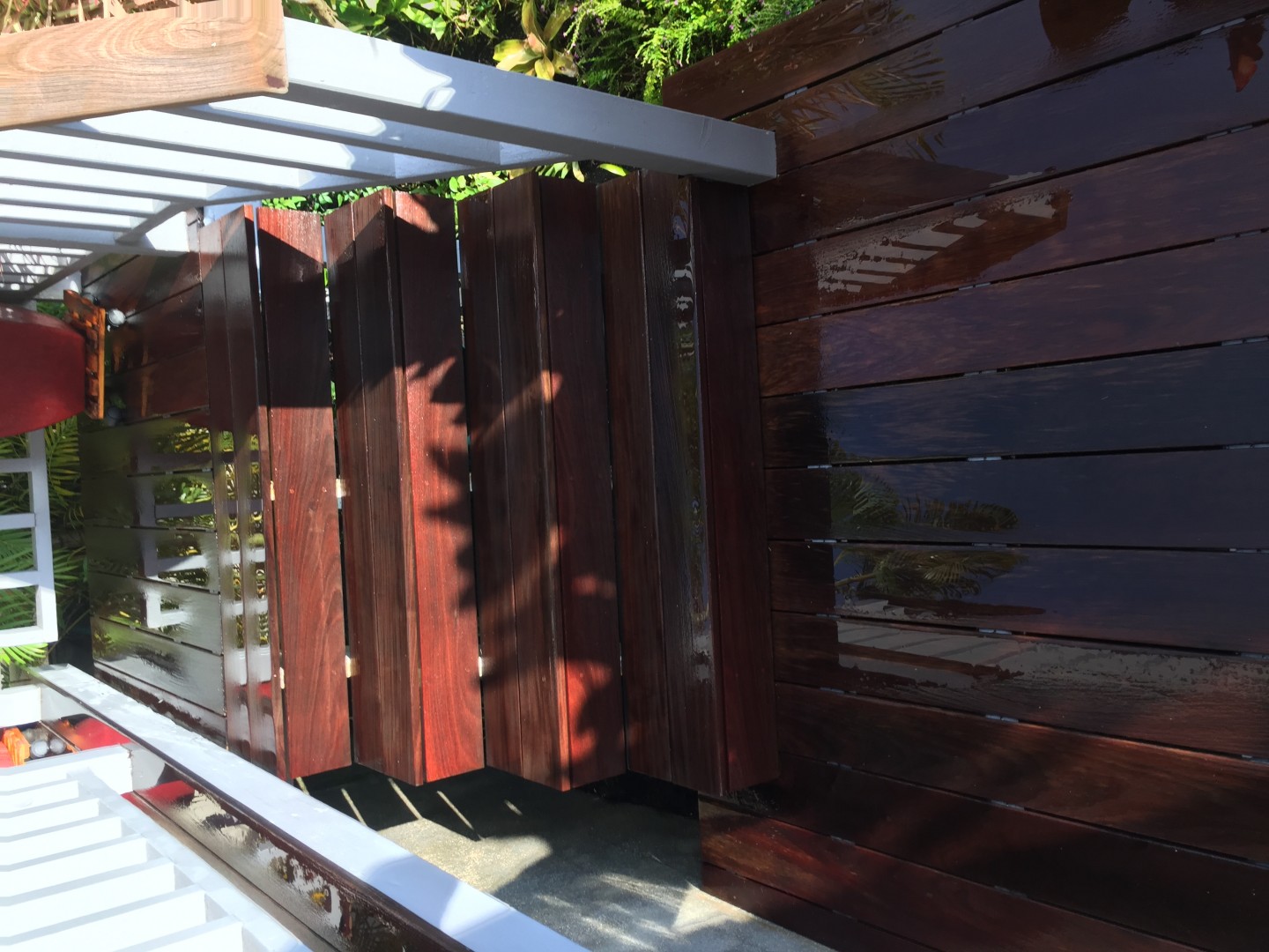

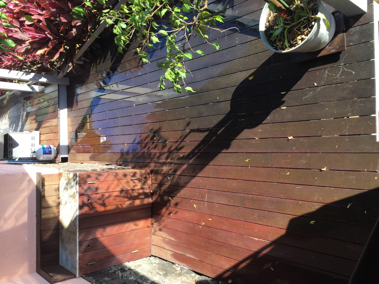

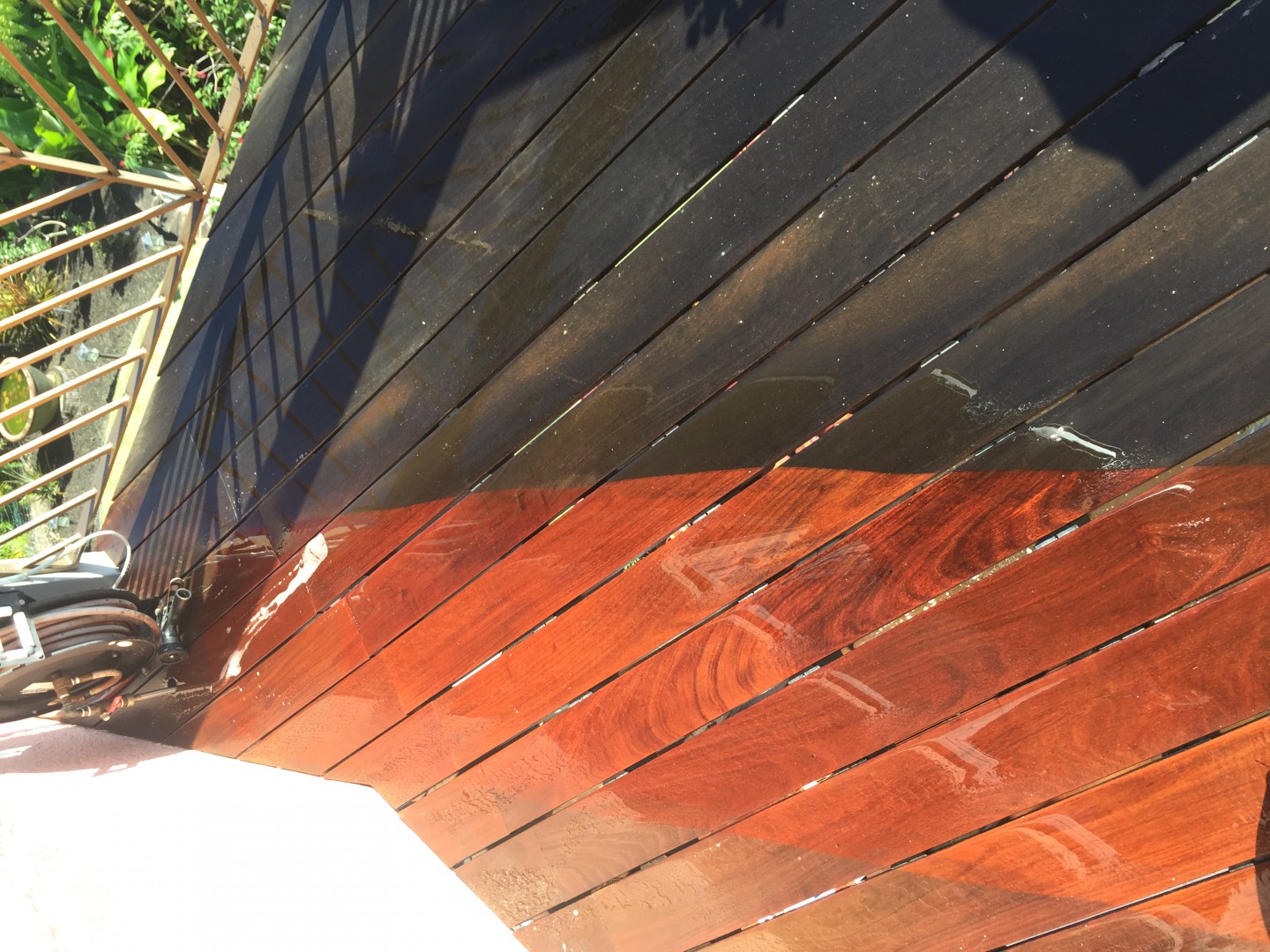

Aloha, here is a few pics of an IPE deck we brought back to life today. This was 1000 sq ft on three different levels and on the side of a mountain. This took us about 6 hours to complete with some challenges.

We used a product called penofin and yes it will wether in a few months but the customer is aware and wants a regular maintenance on this. We softwashed with a 1% mix then rinsed and applied a very light coat of oxcalic and let dwell for 10-15 minutes the key is not to let the oxy dry keep wet then rinse a lot.
