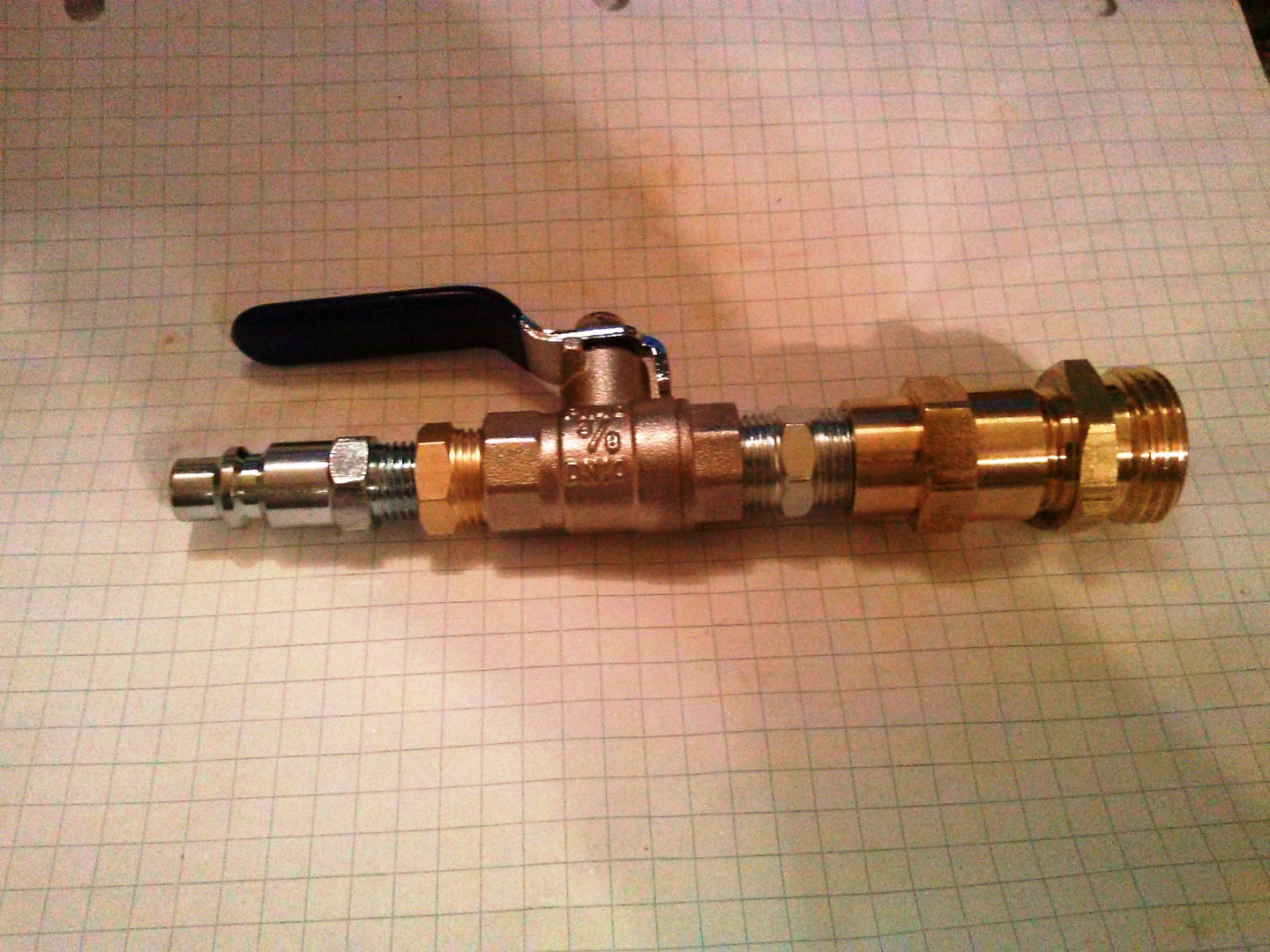

For those that like to blow out their lines and or pumps we use this. I believe Art has a neat set up as well.

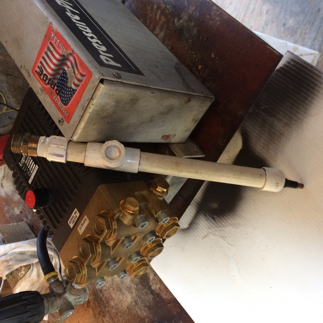

Here's what I use. I blow everything out and then fill the tube with antifreeze. Give it 2 shots and I'm done
