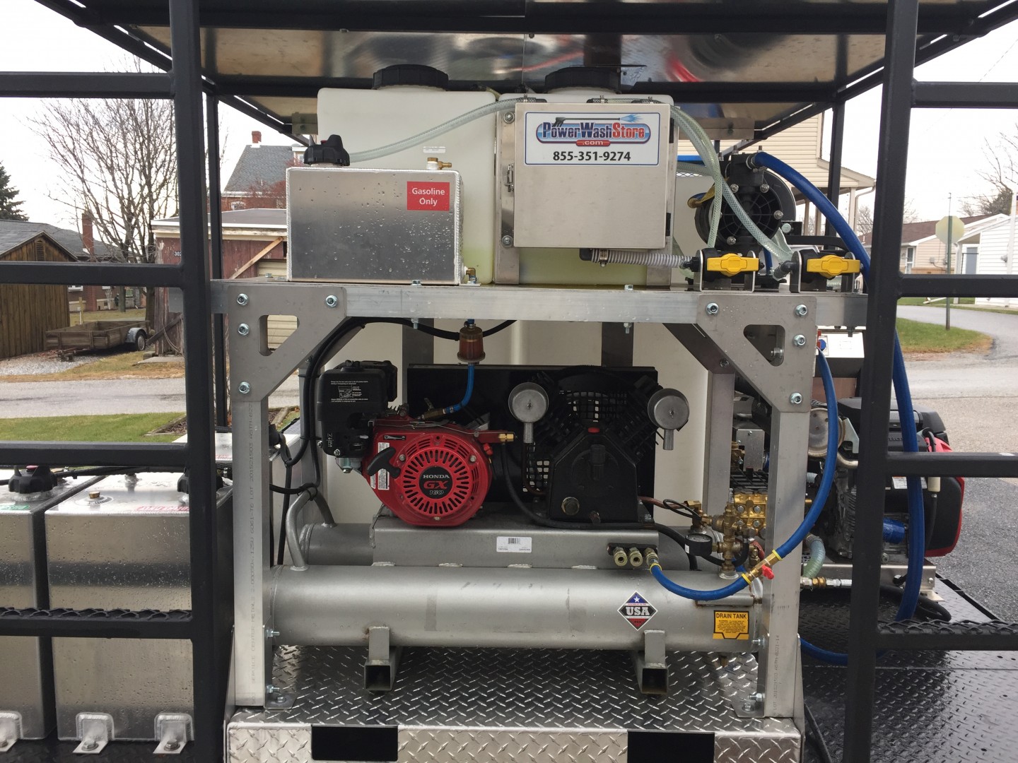

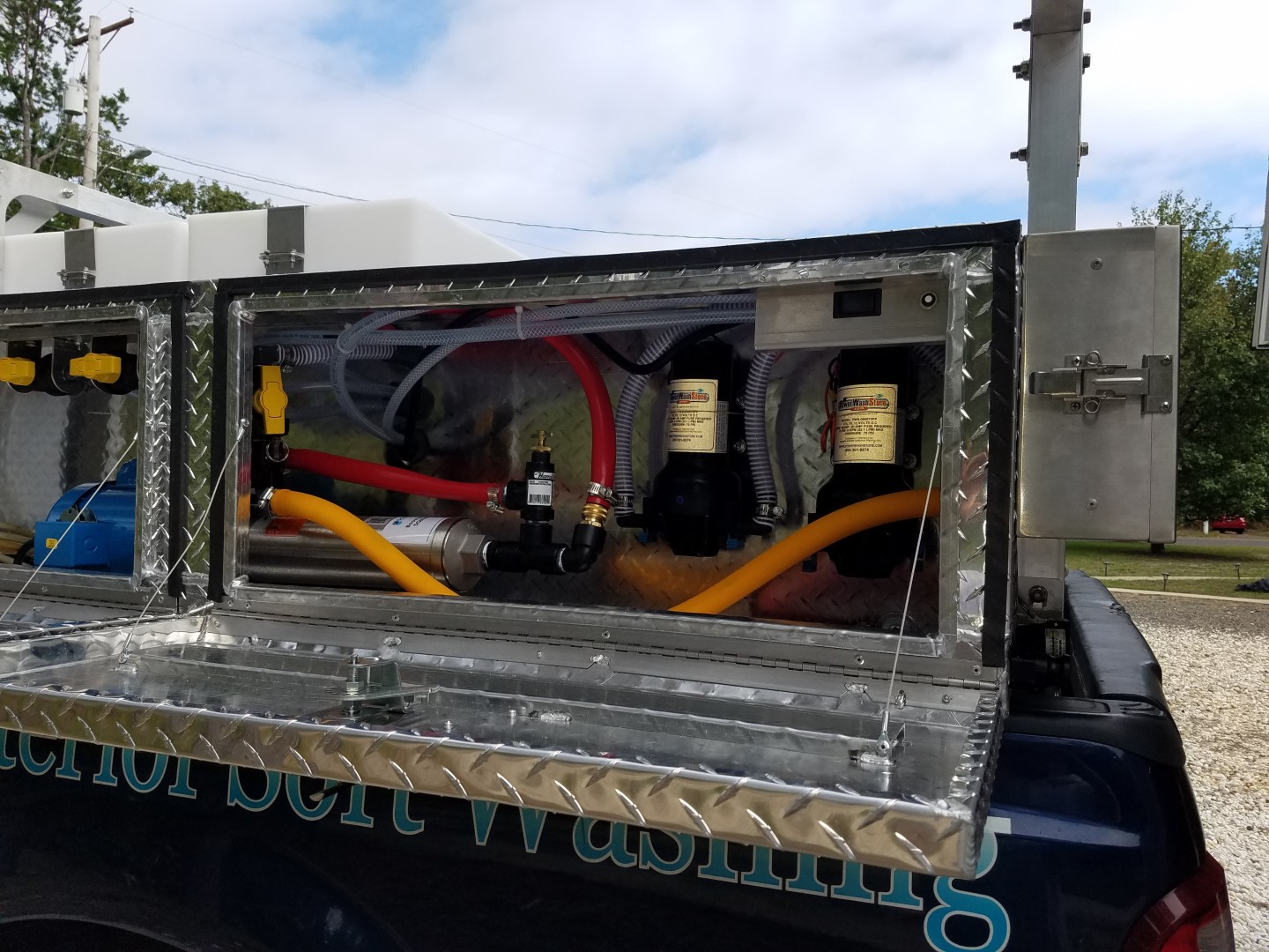

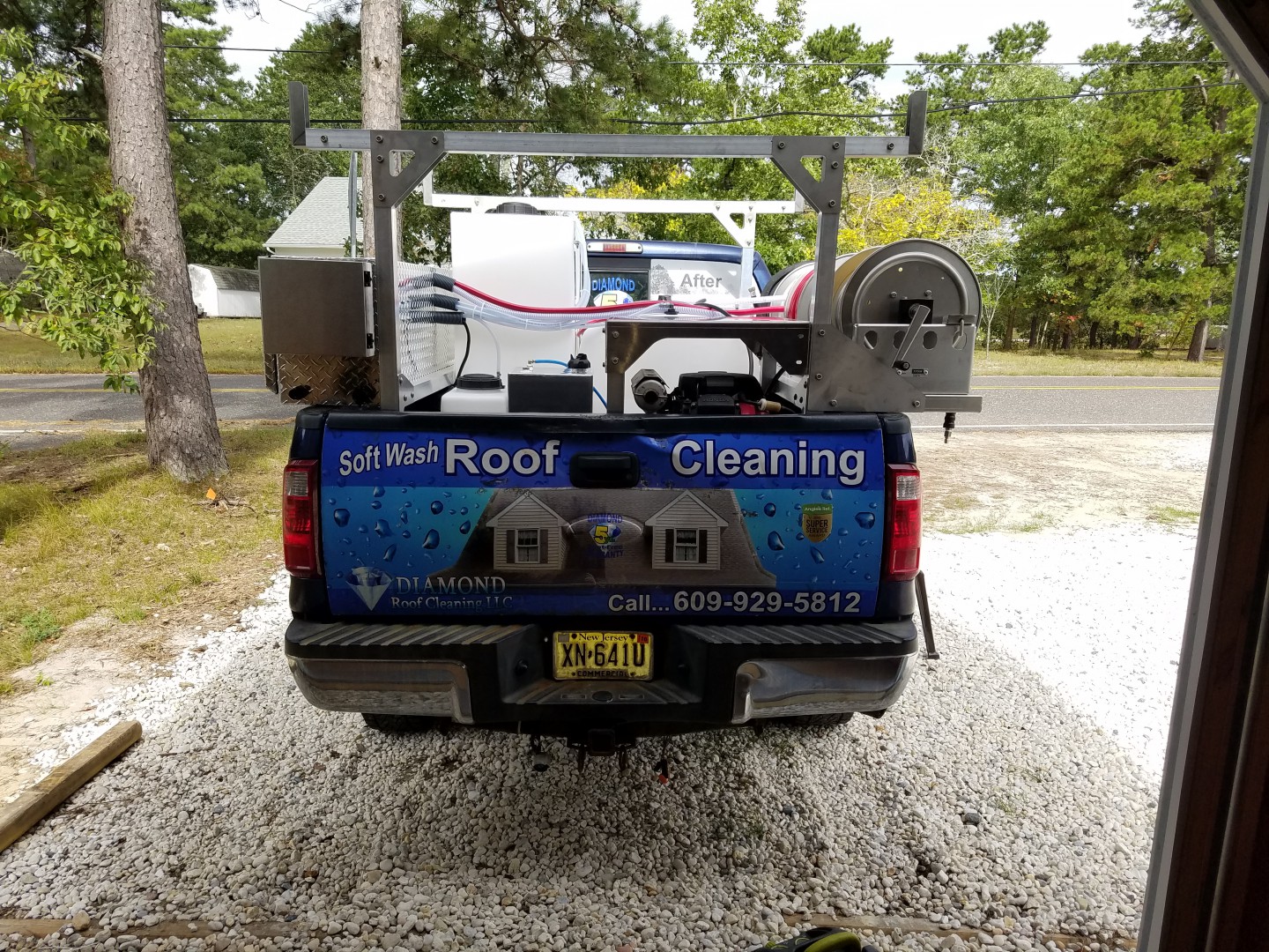

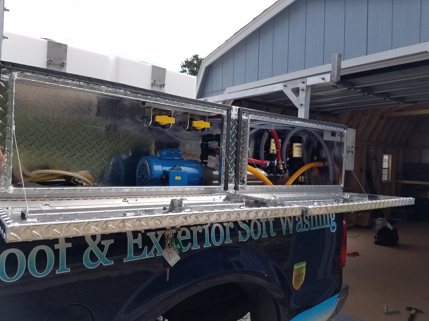

You should go the booster pump route and have 2 12volts as back up. That is what os on mine. My guys love the booster pump now ( hated it on the sws skid). We also put a 5.5 cold water 4000 psi gear driven machine on there as well. And last but not least the pro portioner.
Mike. That's a beautiful rig. I've got a lot of that same equipment (minus the booster) on mine and love it. I think that 5.5/4000 is a great machine.

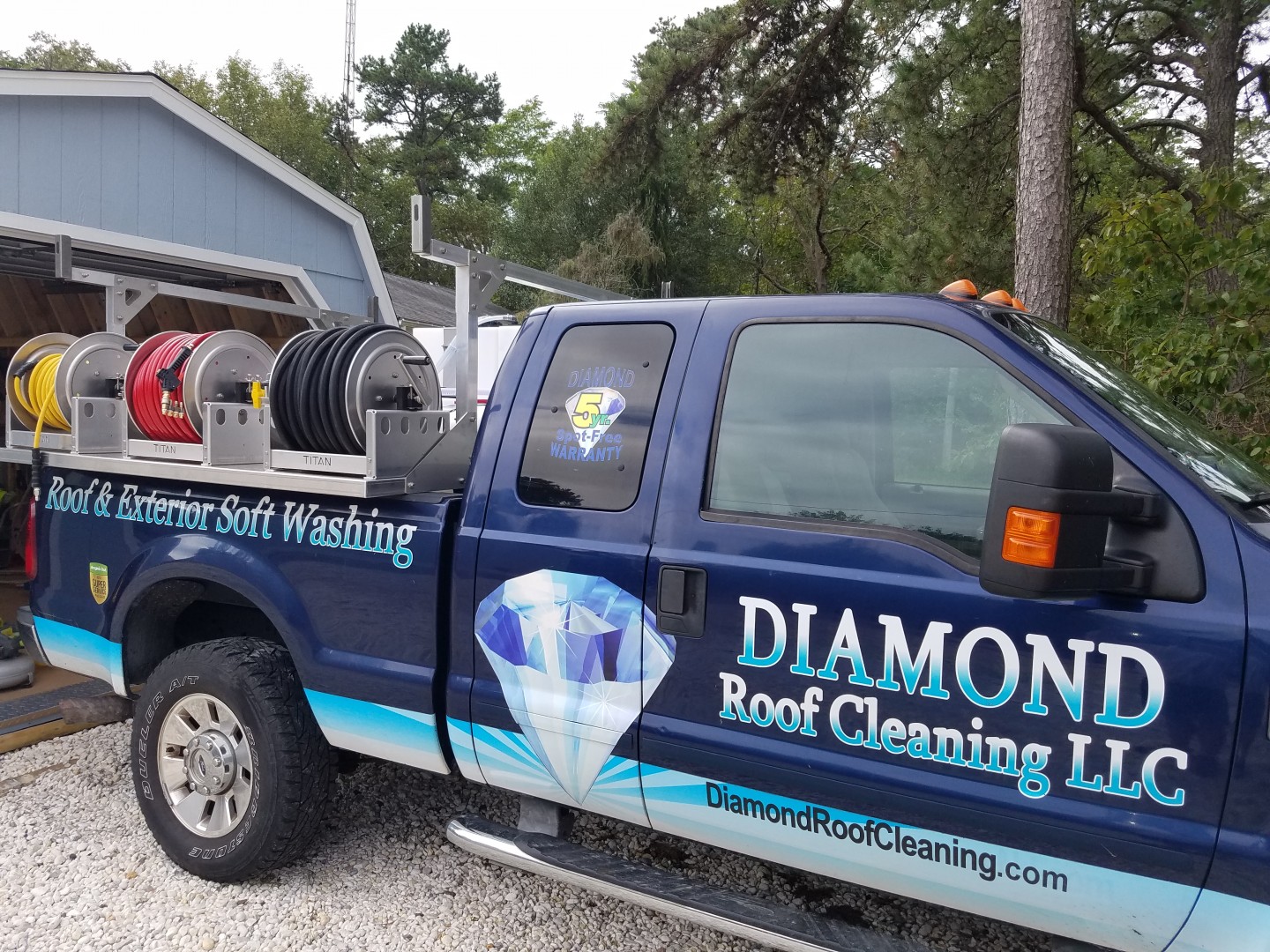

I've got the smaller skid with proportioner and 2 12 volts...and the pressure washer. I went with smaller tanks due to having a 1/2 ton truck. PWS can make it however you want. One thing I wish is that all my reels were on the side of the truck. My pressure hose comes off the back and my soft wash hose from the side. I've got some ideas for the spring to fix that, but it's too late to get it all built together like Mike's. I have a trac rack ladder rack and my whole skid is in between the wheel wells. Hard to get to some things it's so tight.

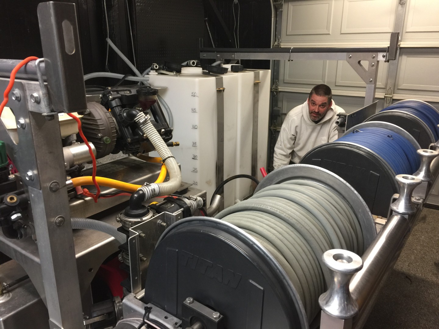

I bought this rig 3 yrs ago and it will last 5 till 10. I am making some changes to it now.

Very nice truck Mike! It's a sleek clean unit!
Brian you a sharp set up as well and Thanks for the video!

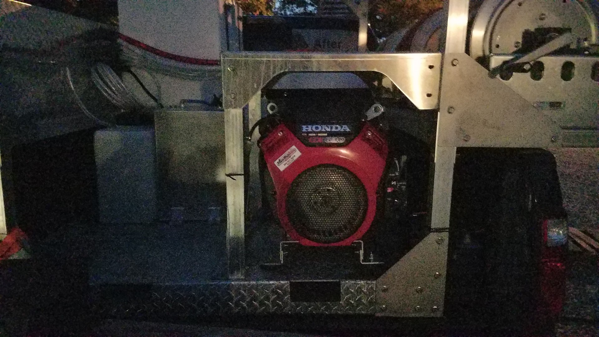

I have a half skid made for roofs, Its air and a PP.
-- Edited by Liberty SoftWash on Thursday 19th of January 2017 07:54:25 PM
That is saweet! The use of the Pro Portioner sure seems to clean things up
