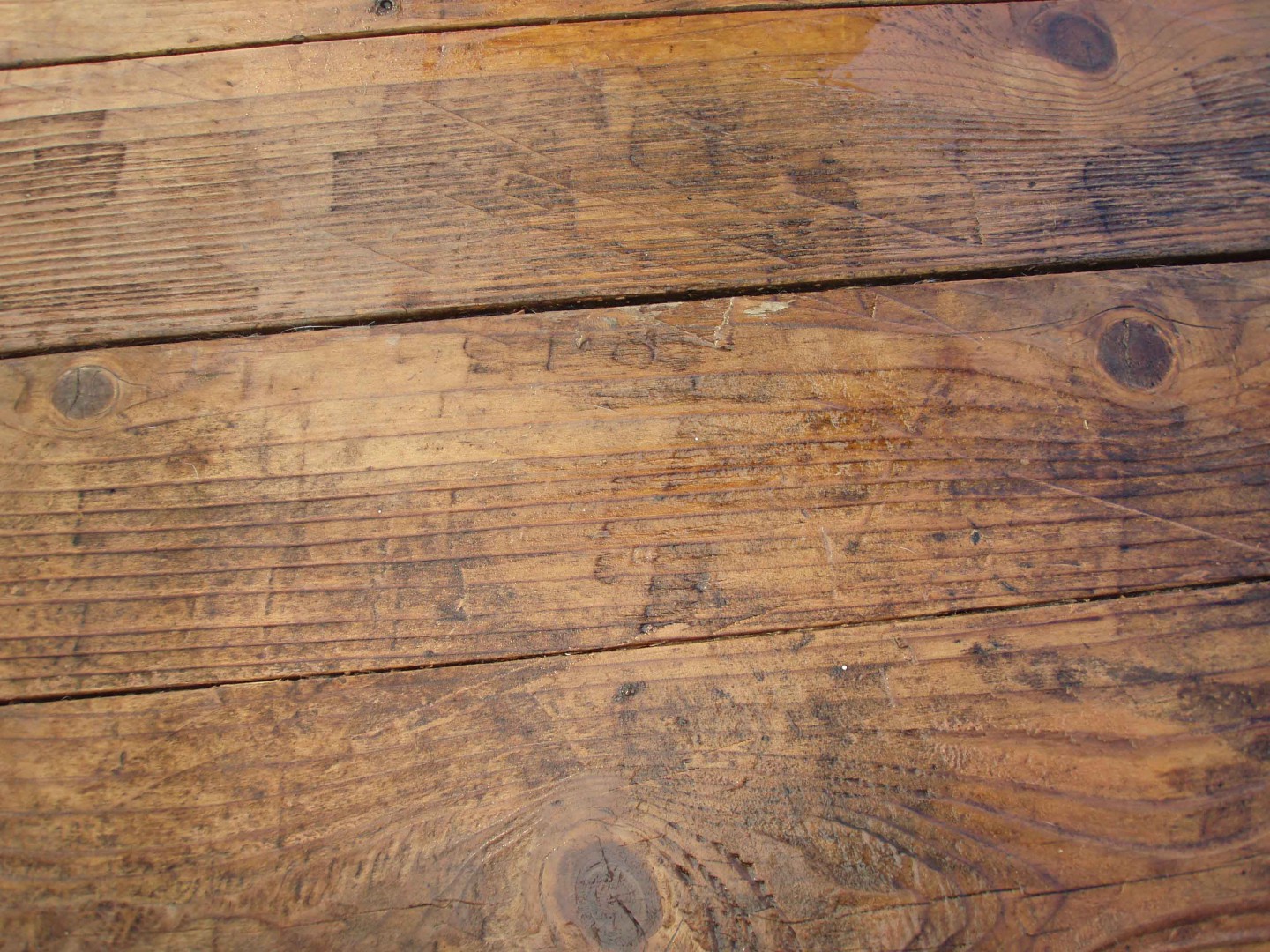

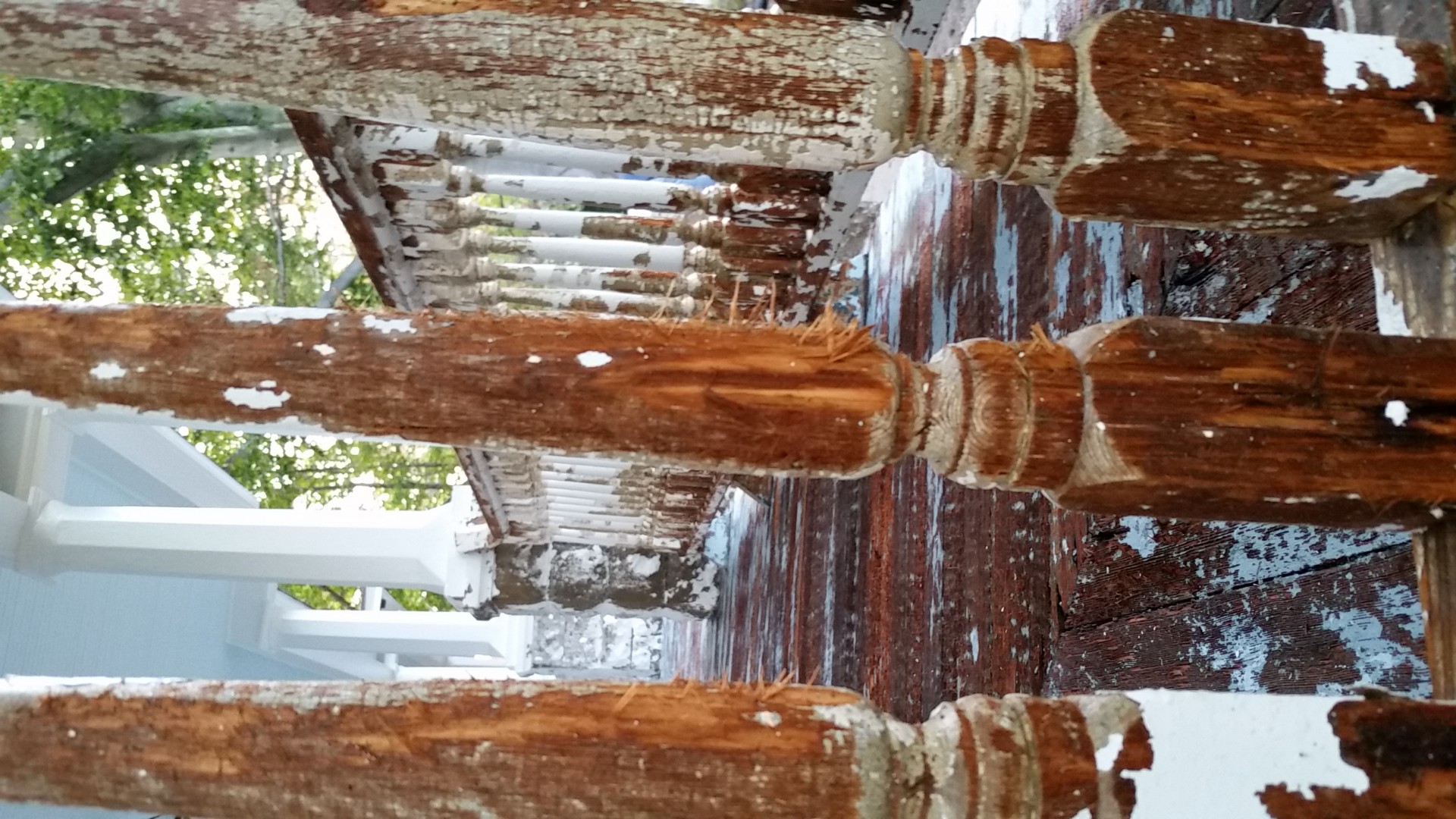

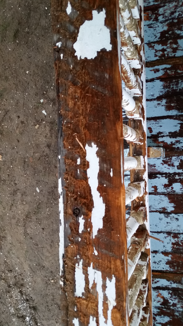

This is what happens when someone doesn't know what their doing or doesn't listen and wants to get fired. (Most not mine but splintered wood on 130yr old porch got 2 helpers fired)
-- Edited by Maverick Contracting on Tuesday 17th of January 2017 04:04:51 PM

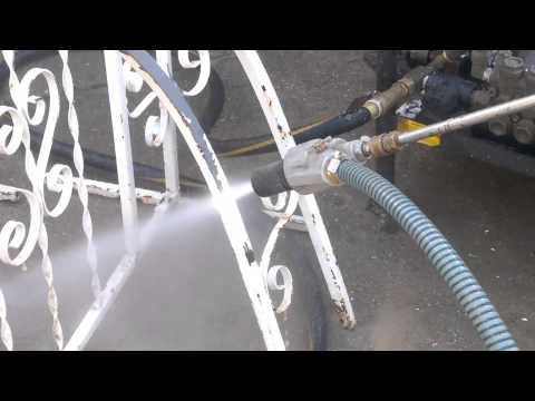

Rusty wrought Iron rails clean up nice with high pressure especially when using the right abrasive. Or patio furniture, trailers etc.

Almost every flatwork job that has crappy Iron railings embedded in the cement if I note since we are there, we can restore it far better and faster by media blasting it just by switching to a specific pick up tube we get.

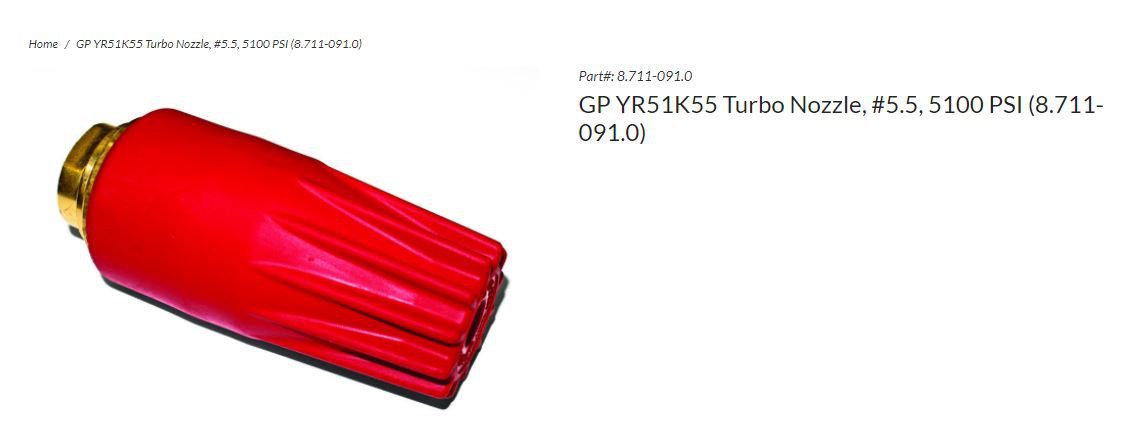

The best tip we can give is to buy the best turbo nozzles with an inline filter as well.
So, so much better than normal tips.
After trying many types we prefer this one.
You will have to match the orifice size to your machines flow rate. It is very important to get the correct size and pressure rating as if you get that wrong they just don't work nearly as well.
Turbo tip in the wrong hands will do damage if not used right.
