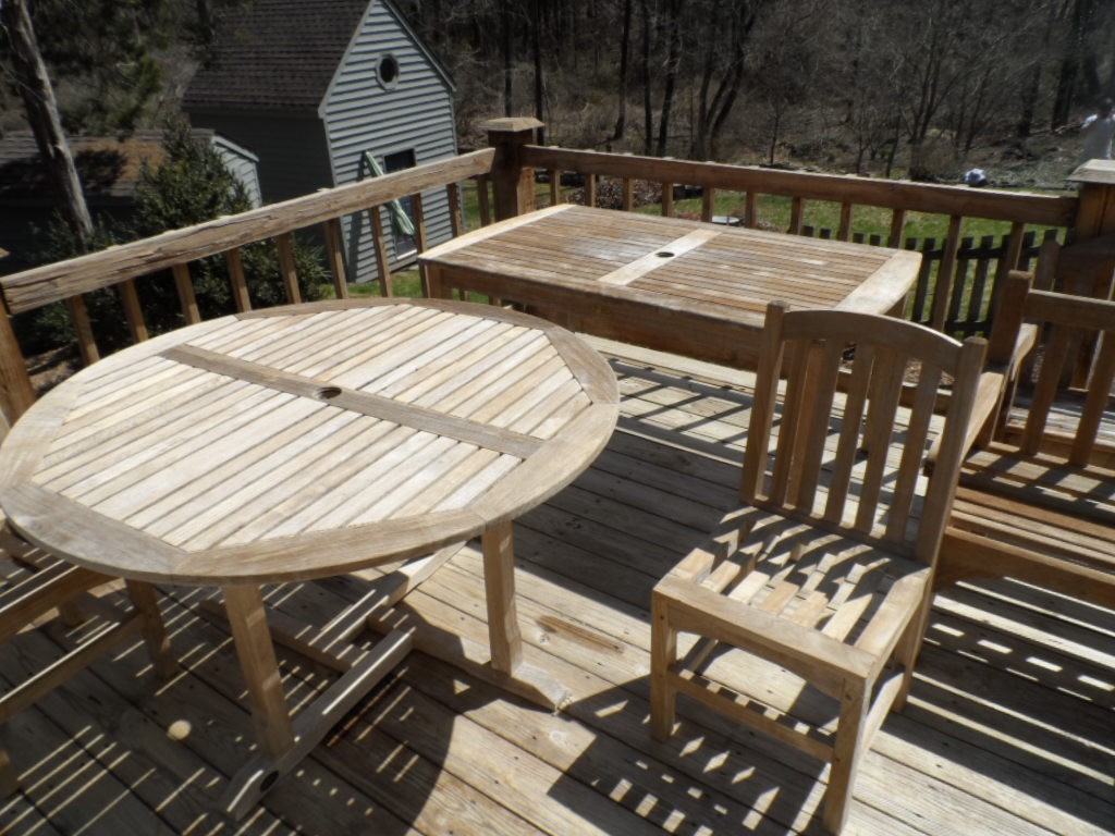

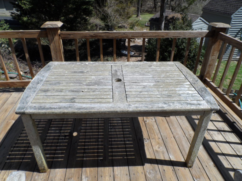

I was at a customers house to give an estimate for cleaning & staining their deck and saw this dirty grey Teak patio set. Asked her what she wanted to do about it. She said she had an estimate to restore it and had just put it on Craigs list and had already order a new set. I asked her for how much and she said $400. I said (to myself of course) Holy Shit! I'll buy it. This was a $2000 set. The middle piece drops down & makes a smaller table if needed. The chairs adjust to 3 different sitting positions.
The only thing wrong with them was that they were grey and a little mildew! This is a picture after cleaning. They haven't even been stained yet. It only took me 45 min. to clean them. Makes you wonder what the heck the guy quoted her to restore them.....
I did the same thing Dave - picked up a nice, albeit weathered set for a song. A little sodium hydroxide and a "power rinse", and they looked like new. I did a semitransparent stain/seal on them and they still look great a few years later.

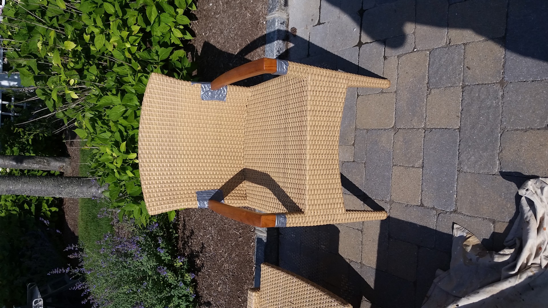

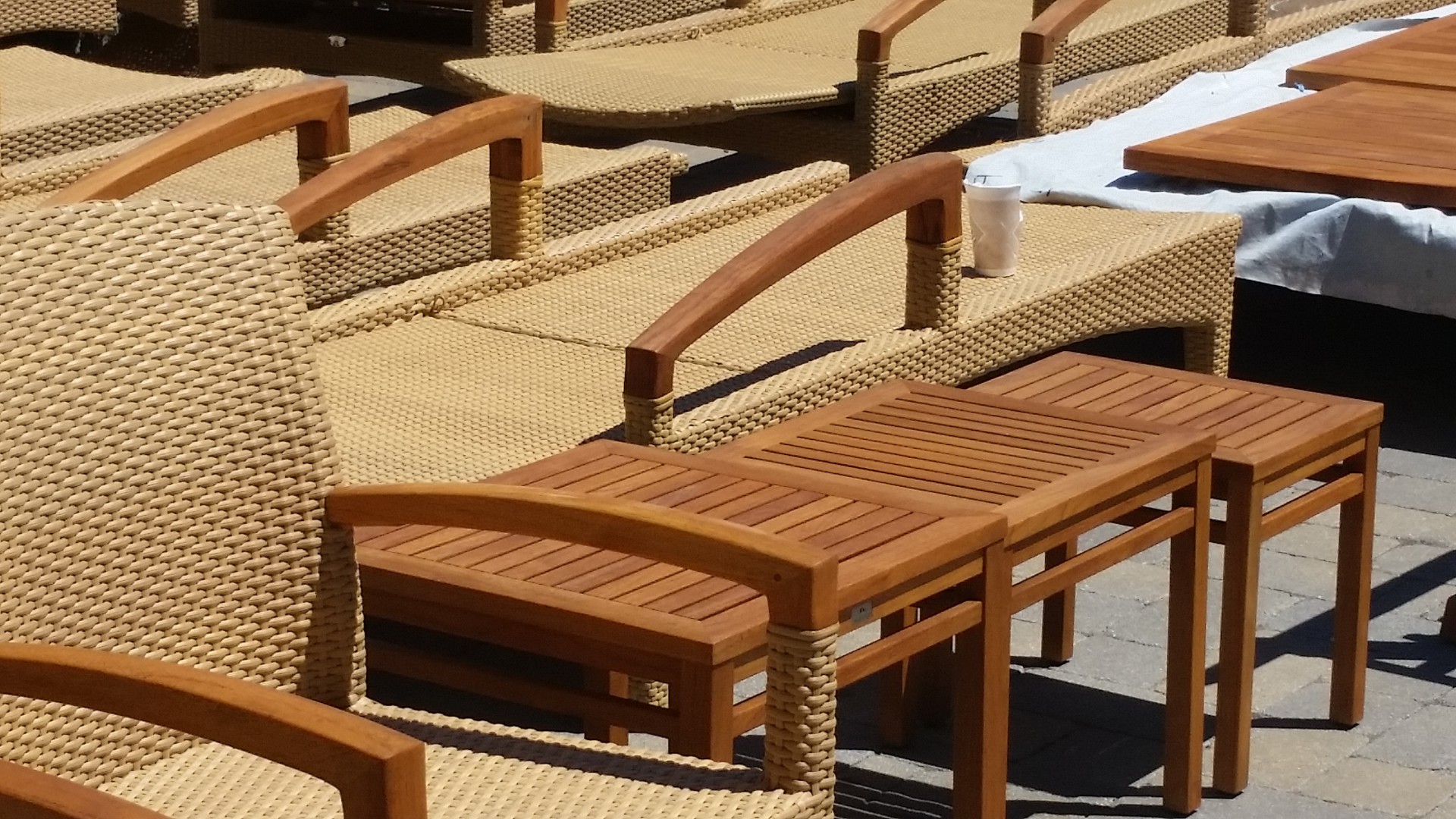

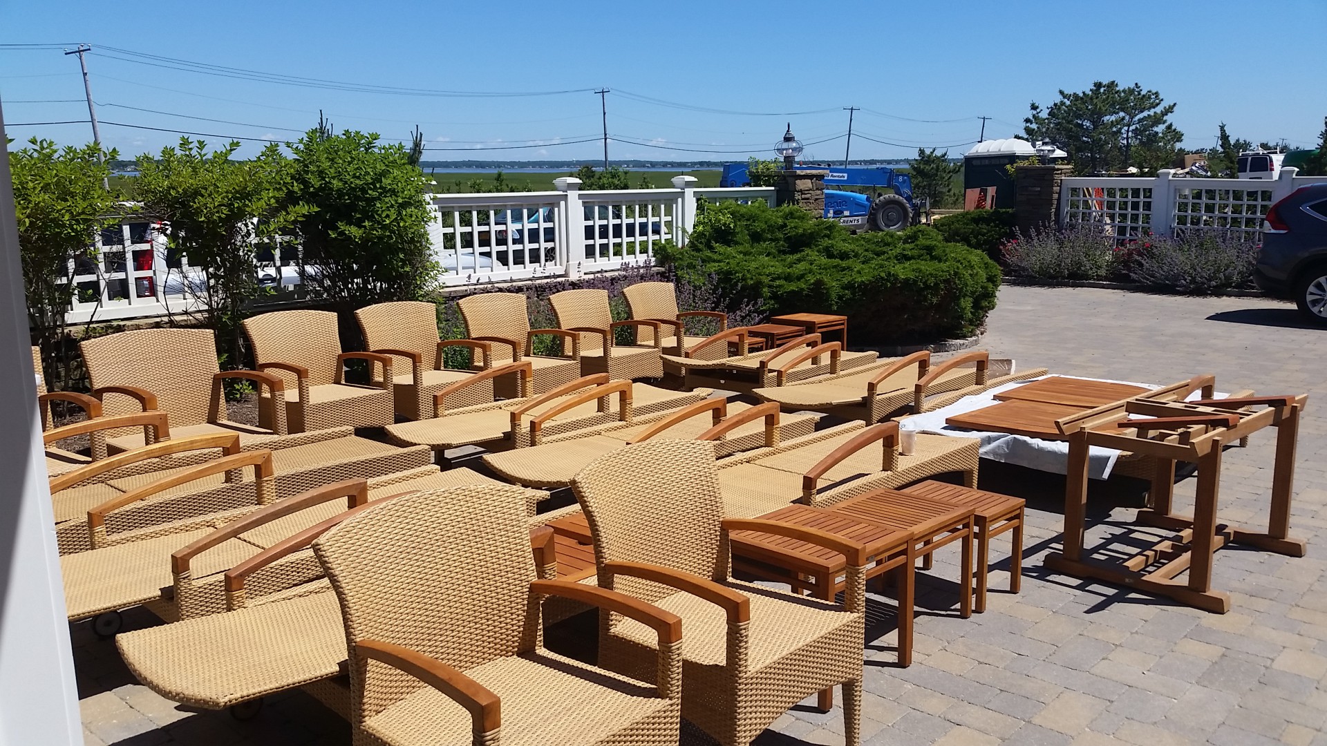

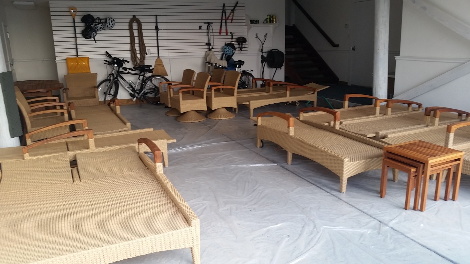

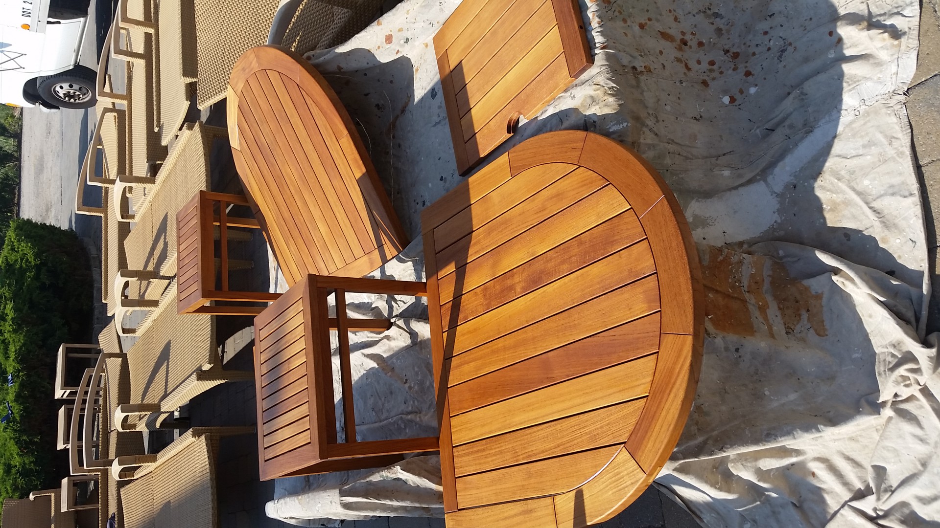

I loved the look on customer's faces when you restore hardwood furniture. Make the wife happy and they will call you year after year comes spring. These are pics from past summer in Hamptons. She was about to purchase a new set. Took 2 of us 2 hrs prep, 2 hrs finish coat. (low pressure PW, brightener, Messemers exotic hardwood oil). Don't remember how many pieces but it was a LOT! The GC told me it was over $25k.
Charged $3k. Customer said go for it!

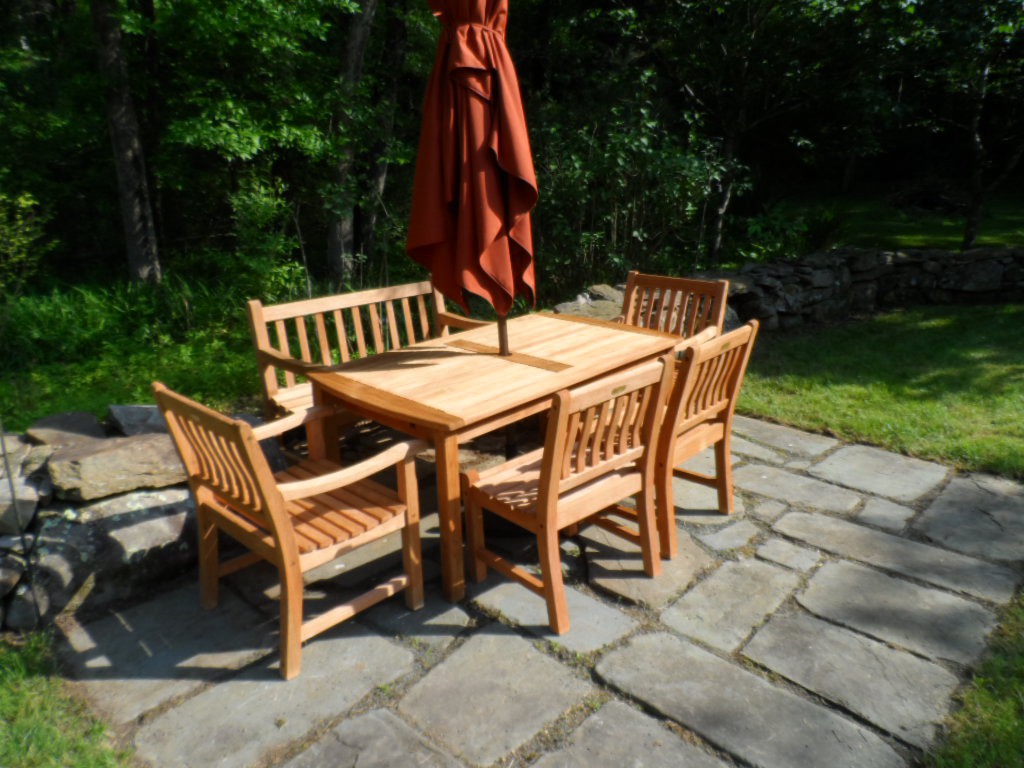

I did these as a experiment for a homeowner last year. They had me back to clean the whole set.

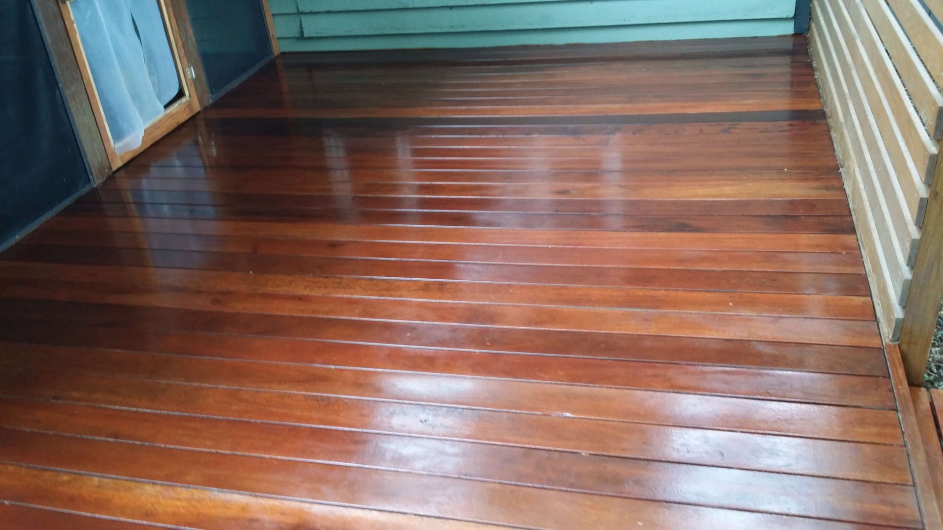

I used Armstrong Clark Mahogany on this Tigerwood.
