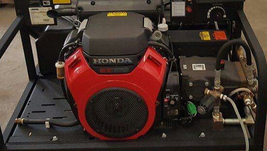

my settlement is coming in soon, so i went to the local rig experts, and talked to a salesman. We came up with a great rig for what we are wanting to do. Here's how it breaks down.
5x12 heavy duty single axle trailor.
2- 5 1/2 gallon a min machines (Honda)
2- hose reels
400 ft of hose
1- garden hose reel
200 ft of garden hose
1- 275 gallon water tank
1- 30 gallon chemical tank
2- 20" surface cleaners
1- 7ft wand
1- 4ft wand
1- 2ft wand
Everything is going to be setup and ready to work for 11,000
The pic attached is of one of the new pumps and motors.
I would strongly consider getting one of the machines at 8-10 GPM,..Nothing like that kind of volume,.and you can still use 3/8" hose. Awesome for rinsing and running a surface cleaner.
I would also make that a dual axle trailer.

Sounds nice! My thoughts are you might put a little more in or sacrifice something for a dual axle trailer. I also would like the option of hot water when needed. I don't see any roof cleaning equipment but with a bigger trailer you could add that later.

Cant do the duel axel trailer. If I did then id have to buy a truck to pull it with. We have our minivan that pulls our trailor.
Won't have enough money to do both, and pay off all the bills we need to pay.

Didn't want to put out the extra 3500 for hot water. I wont be using it much anyway. One job in the last 3 years I needed one. The wife said she dosent want to get into roofs. Shes scared of hieghts.

^^^ What Jeff said and a 50Gal chem tank if you can fit it on there...you can run a smaller water/buffer tank on a hudson float valve and not tote so much water on your single axel trailer...

If money needs to be stretched, get the hot water machine, drop the second pw and add a booster pump for roofs and small to medium house washes. How long will it take to break even with the cost of two PW's?
That is a lot of weight for a single axle.
Personally, I like building my own as do many here. You can save a lot doing it yourself. Then you can really stretch the money! Maybe even a small flatbed or box truck.
Now that sounds like a good idea. A flatbed truck would hold the wieght alot better. That way we can keep the van for the family.

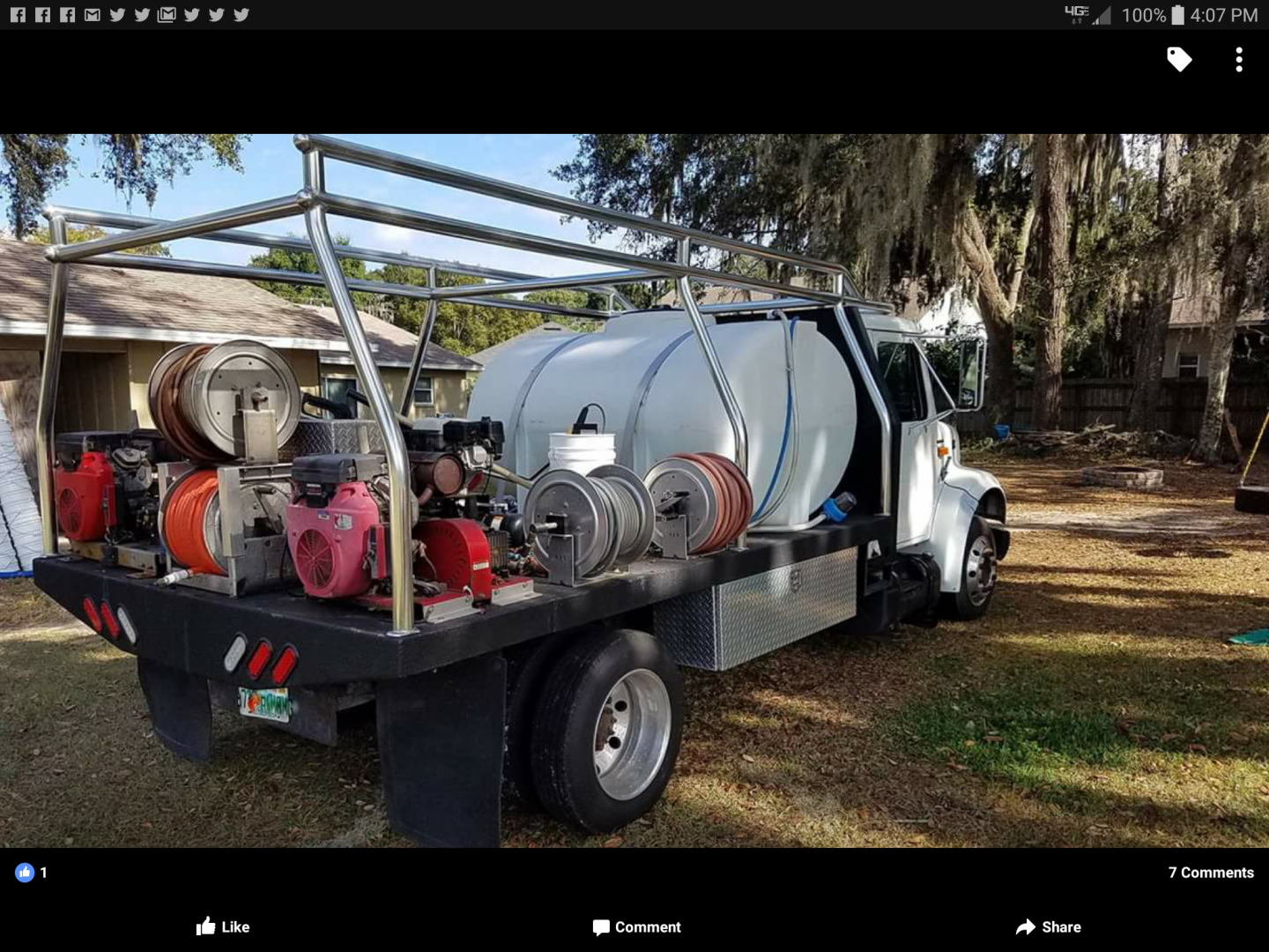

Saw this on Pressure Washing Classifieds today. Much better trailer. Maybe not as nice of washers...but it would make money for sure.
Yea i saw that too. Just wish it had a better pump

This flatbed is only 15,000. For the whole thing!
That's a nice set up that would need some minor changes. 15K is the asking price so you know you can get it for less. Keep looking, it's winter.
A lot of people use trailers and I started out with a trailer and learned early on that a trailer is troublesome around here. Small cities that date back to the 1700's and a lot of times dead end streets are not a cul-de-sac. Turning around was a nightmare! Then add in the neighborhoods that have only street parking. The other issue with a trailer is finding an employee who can handle a trailer. The first box truck was 14', now I use 16" and keep just about everything we need inside and secure.

Awesome, yea i talked with the wife and I think we're really going to just look for a flat bed truck to build a rig on.
Fantastic idea, considering she can't back a trailor
