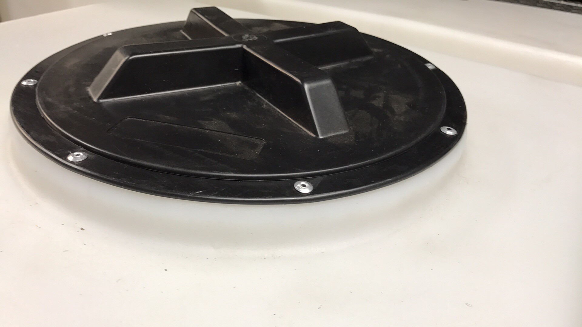

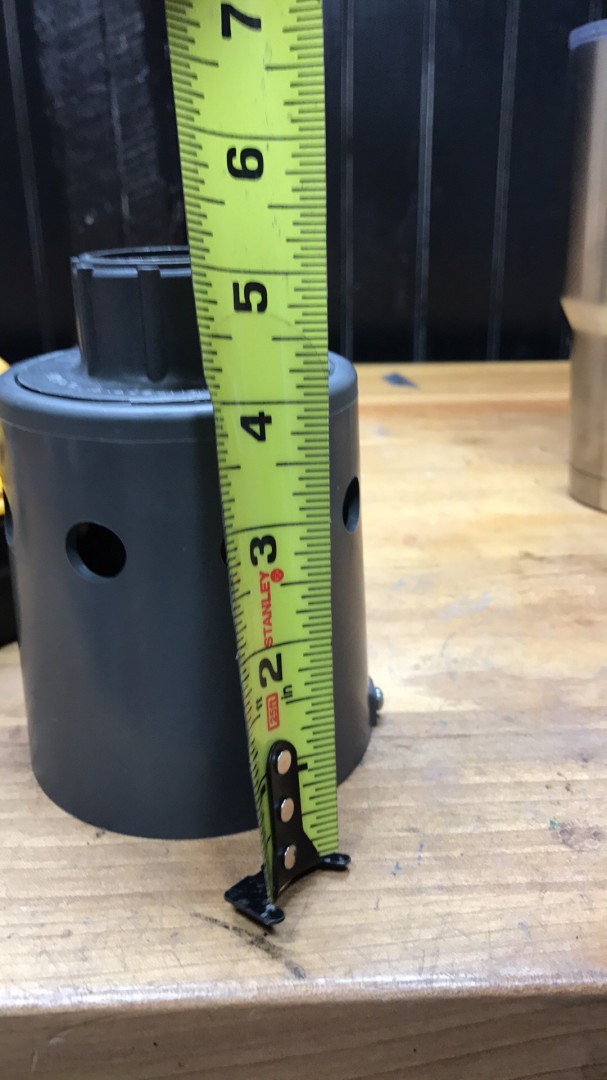

Just bought a 200 gl tanks and want to keep it as full as I can when filling it. When using a hudson valve you lose about 30 gls out of tank when installing it. Lid placement is not any better as the lid is cheap. Just looking for some ideas on at least putting in 180 before valve shuts it off.

it would be nice if hudson vavle had threads at bottom and you could spin down in bulk head fitting and it would sit about a 1inch and kept as much water in tank.

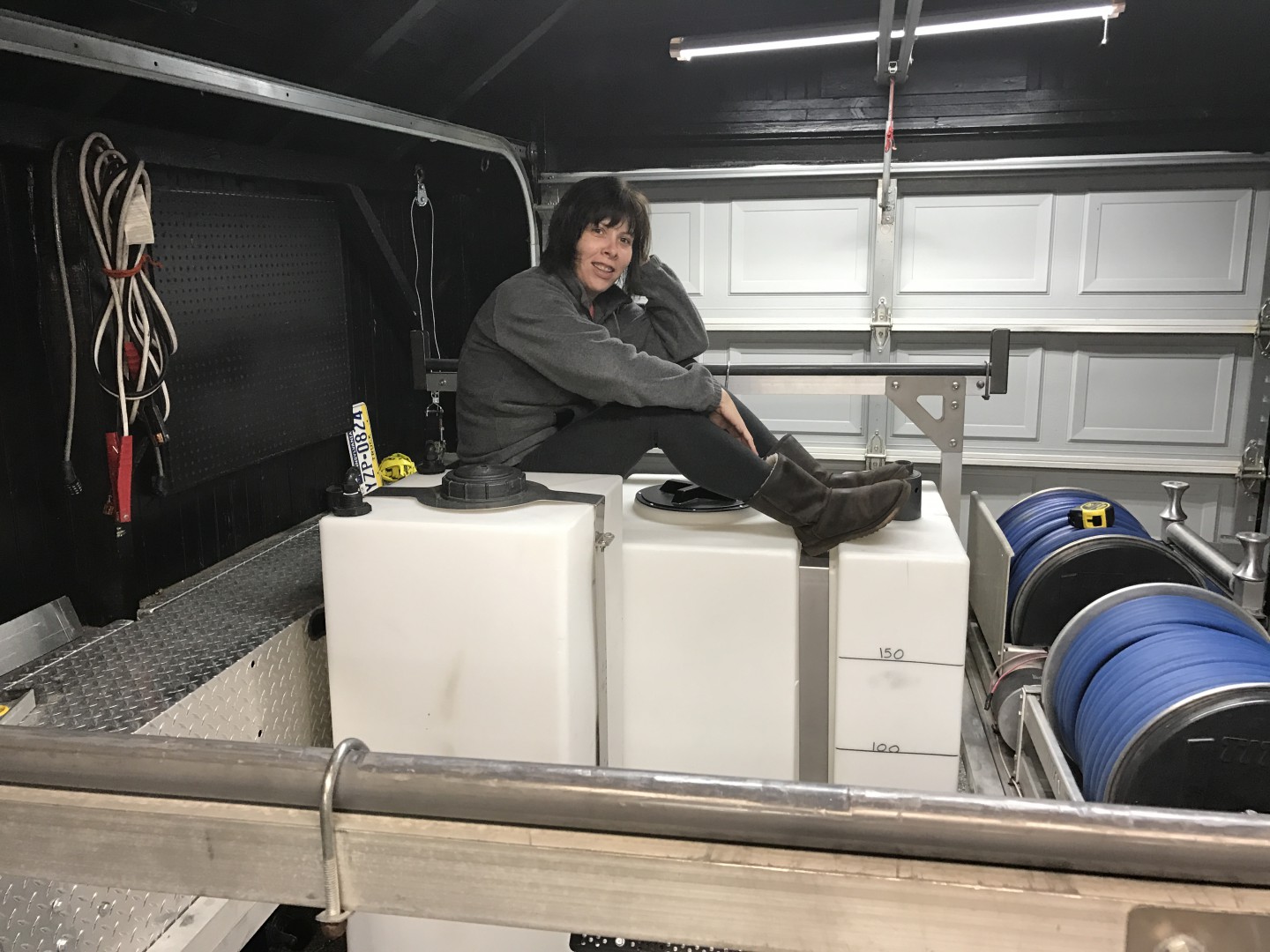

Eric......I seriously thought you were smarter than you are! I really think your wife is more valuable off the truck. I mean making her sit up there and keep the tank full is just plain stupid.
