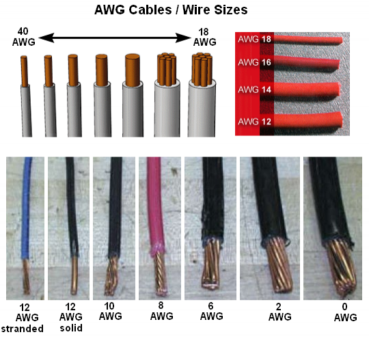

Anyone have an idea on how heavy gauge of wire i would need to run? id guess length of wire is about 15ft or more
Feb 7, 2017
Erik, a year ago I looked into this and for a similar length I think I figured 16ft I needed the heavy duty inverter needed a 2 or 0 guage WIRE!
Now I think if I mount the inverter near the cab and only use say 6ft then run an extension cord to where I need it can use a far thinner guage. Maybe 8 guage.
I'd consult an audio shop tech. They tend to know their wiring needs.
