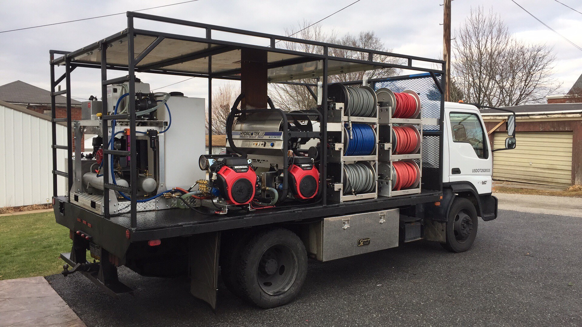

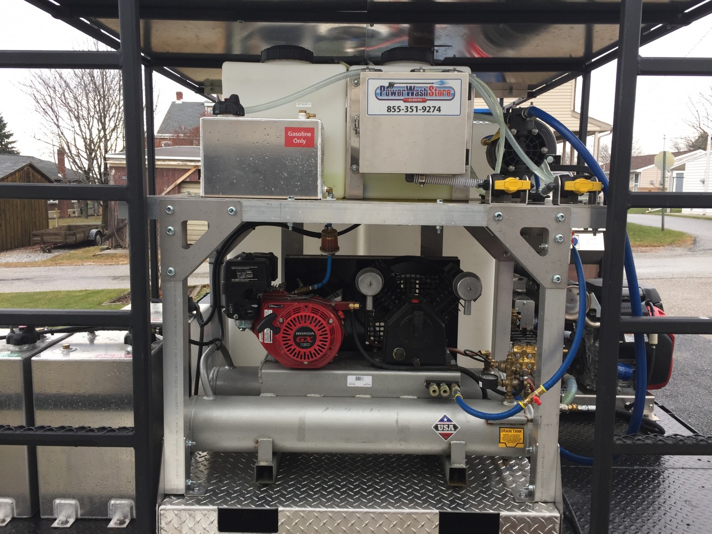

We just upgraded to a 10 gl rinser. Here is our air setup

When I do it all again I am stealing Eric's truck!
Feb 13, 2017
Love that setup Eric
Feb 13, 2017
I've seen all three of his and Lisa's current trucks up close and personal. It will certainly motivate many.
Feb 13, 2017
What size is the gas tank, Eric? Is it big enough to last a couple days?
Feb 13, 2017
Its a 11gl gas tank.
Feb 13, 2017
HaHa! Lisa might chase you down.

When assembled properly,..an air system is definitely the most reliable, resilient and ease of use and assembly of all the pumps. No doubt about it. And they last years,.not months. In the end they all make money. The 3/8" All-Flo is a roof cleaners favorite,.they routinely last for at least (5) years.
When running an air system,..it's a HUGE advantage to run your air supply hose through a tank of water,.usually you can use your supply tank for this. The longer hose you can use the better. These pumps like dry air,..and it's easily accomplished,..but you have to understand how the water traps work. The All-Flo is a great stall free pump out of the box anyhow,..but by the nature of the beast,.they will eventually stall with moist air,..nothing wrong with the pump,..but you have to meet the pumps requirements for optimum performance.
The cost to make dry air is only about $20.00.
