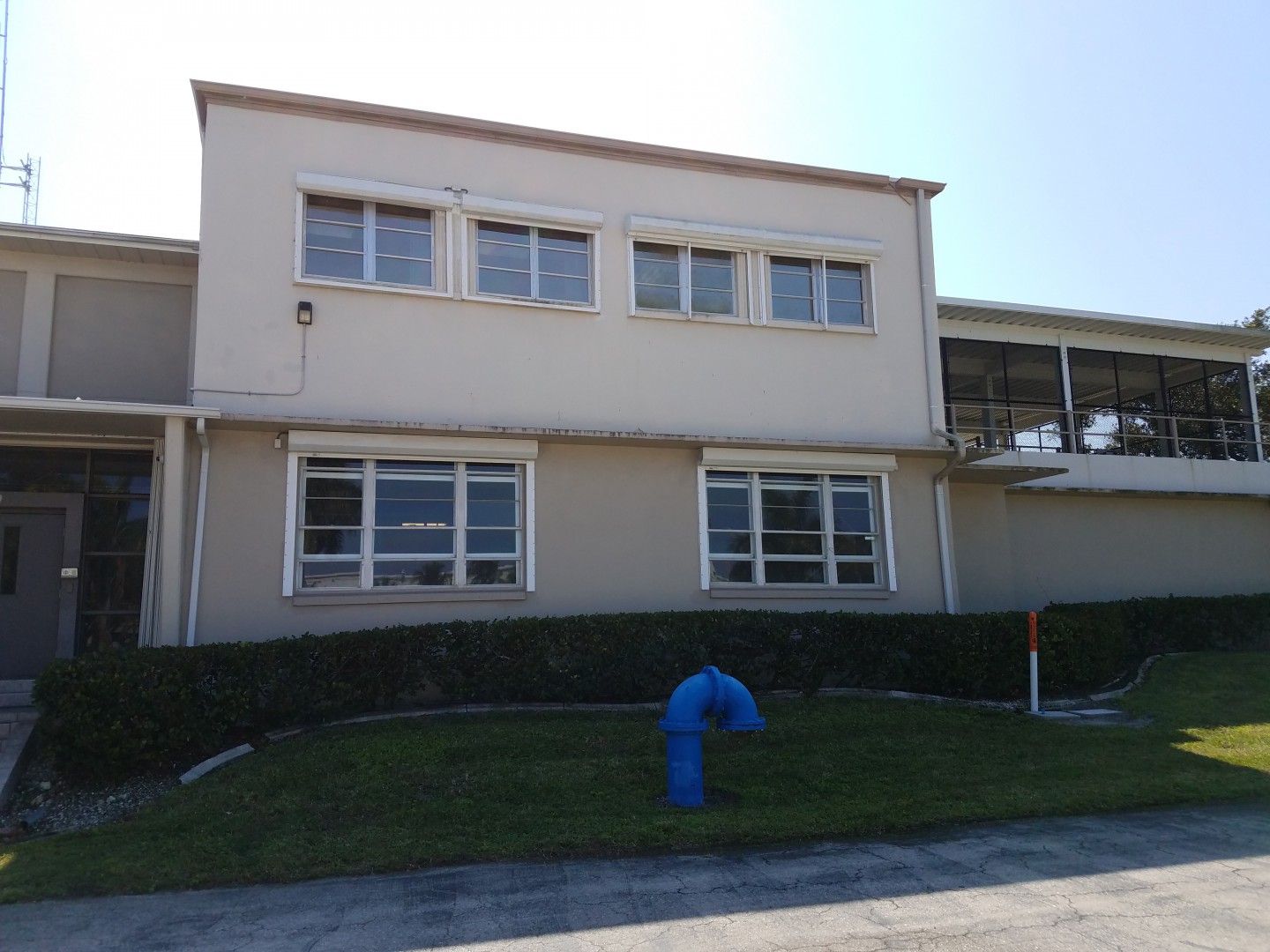

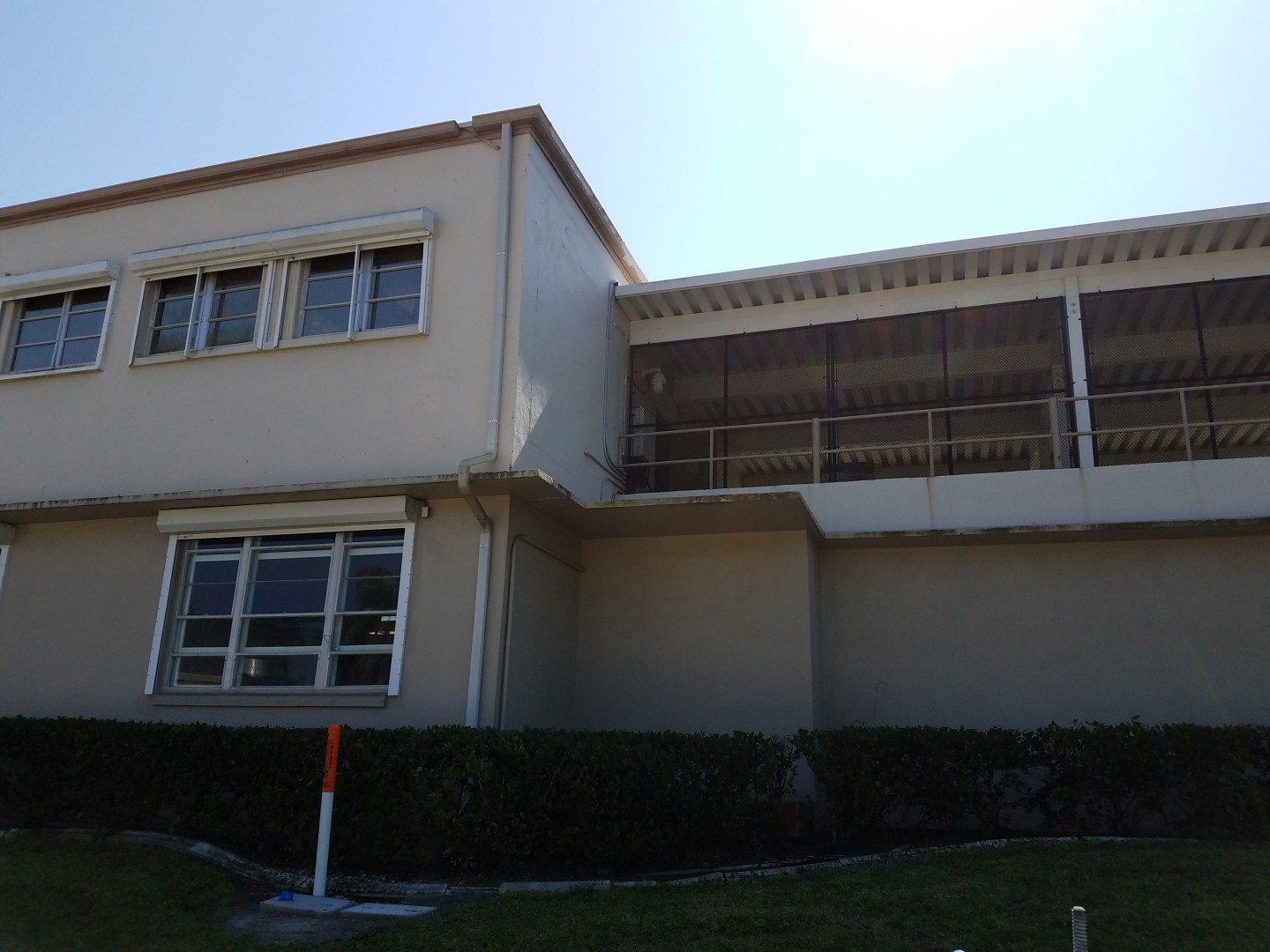

The city I live in Naples FL is hiring me to do some pressure washing on a water plant building to get it ready to be painted. This will be my first job for the city. It should lead to more work in the future. With this being paint prep work I cant just softwash it, I have to pressure wash everything with 4000 psi to remove all of the peeling paint. I am looking for some suggestions on how to accomplish this. A ladder and 4200 psi does not seem like my safest option. I was considering an extension pole but not sure. I could rent a lift but im not sure is I need to or not. I have not sent my bid to the city yet. The gutters at the top of the building are peeling pretty bad. Any suggestions would help thanks.

I agree, I think a lift is my best option and turbo nozzle. I will turn the pressure washet down a bit to around 3500. Im working with the painter to make sure it is done how he wants it. They are doing one section at a time. Thanks for your input.
