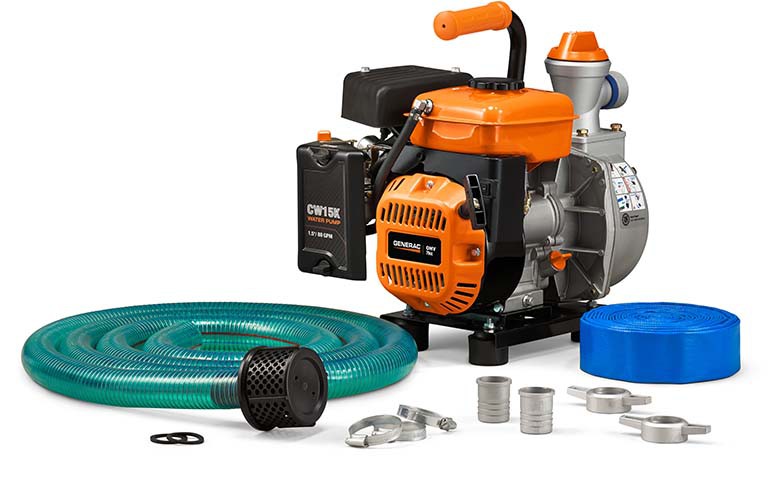

Like John said, a trash pump is an awesome tool to have (esp with flooded basements!) Even if only used occasionally. They can usually sucks up crap up to 1 inch so a med-large mesh filter pad works for sand and leaves etc. If used with a barrier and a "floor drying" fan you can direct the waste water to the inlet easily.

@Maverick,..isn't that pump your showing a roof pump? If anyone was around many years ago you may remember that I used a Homelite 2-Cycle pump like this as a roof pump,Ha,Ha.... I put the suction into the CH and attached a garden hose to the outlet and used a regular garden hose trigger to apply. That is also when I was using CH rather than SH,..So,.talk about being behind the 8 ball.

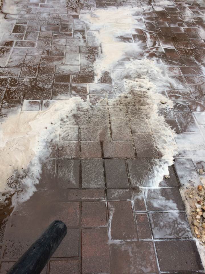

When rinsing with a PW and a Blower at the same time standing water moves, Trust me on this

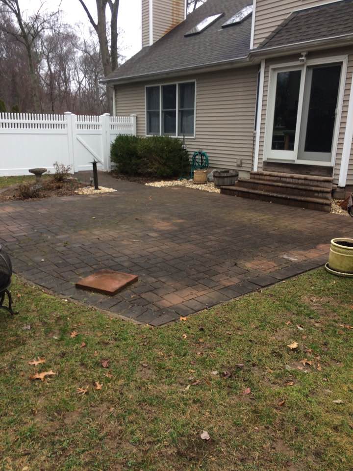

I did a Paver job today with the blower technique, Instant results

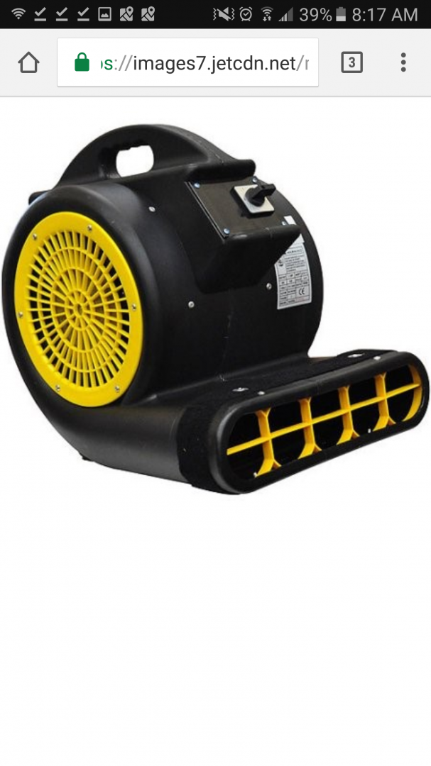

-- Edited by Maverick Contracting on Sunday 19th of February 2017 08:18:27 AM
When I do Patio's and Pavers I go behind the guy that's rinsing with a Blower and move the water and muck off the surface. Job always comes out mint!
But sometimes due to pitch, bellying in patio or just size of patio it's too much for just a blower bit that is my first attempt. Might need a pretty strong blower though
