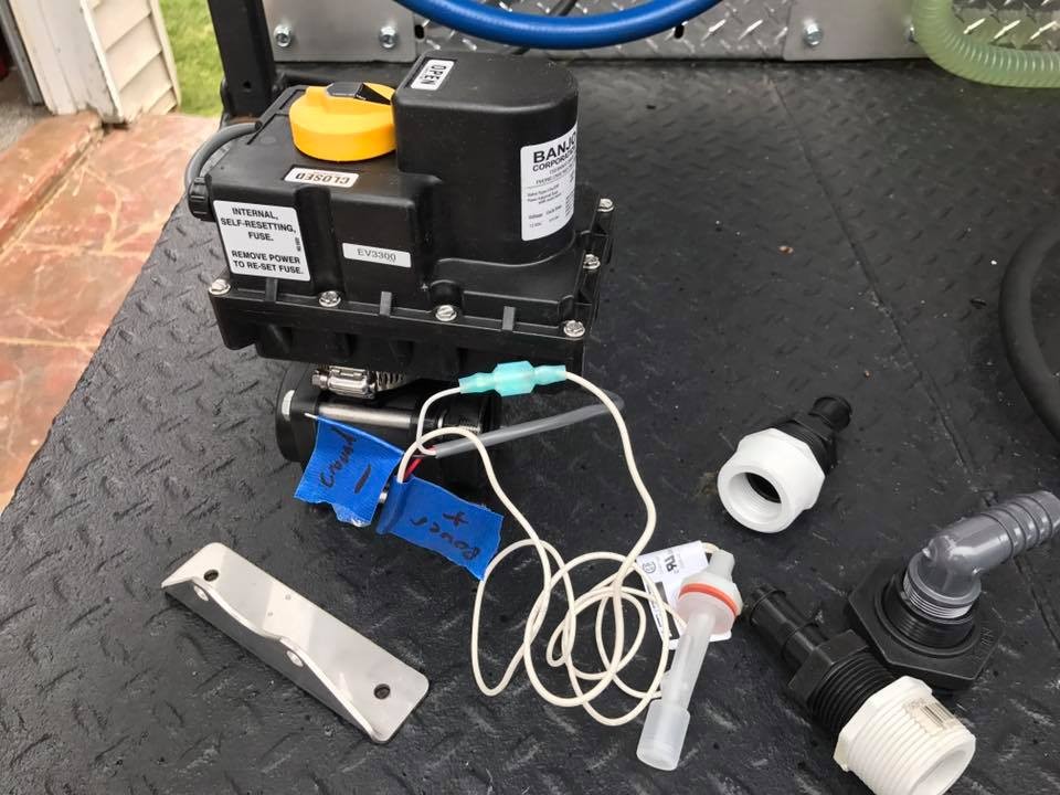

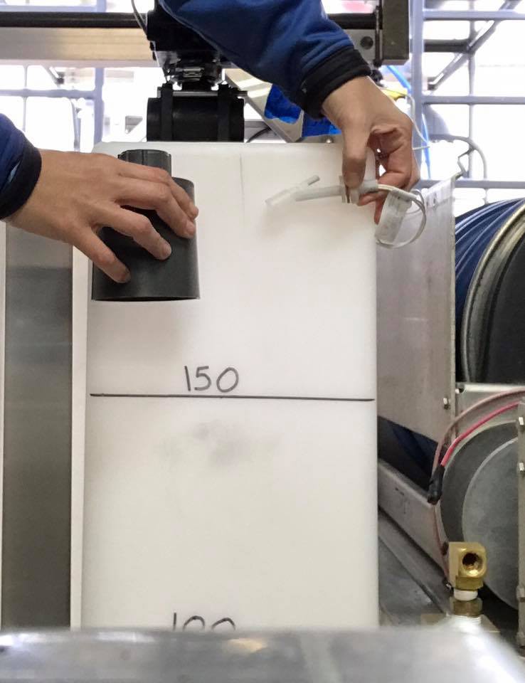

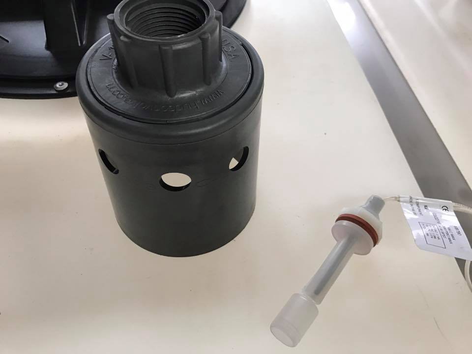

I bought a 200gl tank and didn't want to lose so much space with a hudson valve then I found this. We will only lose about a 1/2 inch of space from top of tank so we can get 190 of water in tank.

Being a able to use the entire tank can make a big difference, especially with an 8 gpm machine.
That is a good idea Trey, have one to fill the tank and one for low level to shut off the PW.
