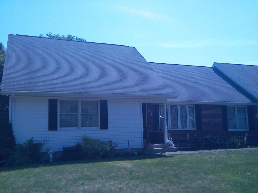

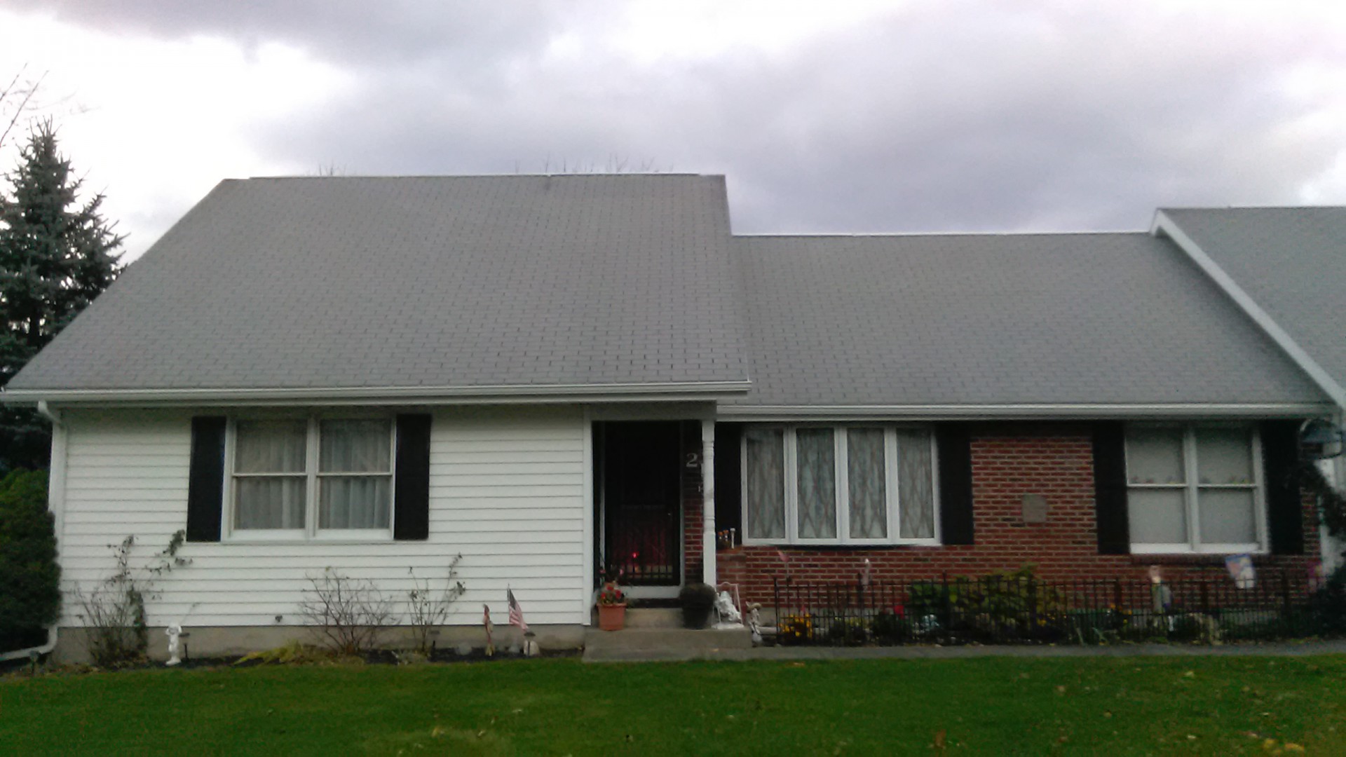

Here's and old white roof that we did, what do you think? Do they clean up better then this? not to bad just wondering if i could lighten it a little more. first 2 are before last one is after.
Looks like still some algae there. How did you clean it?

White roofs are always more difficult because the bio film (dead algae on the roof) shows up after the roof has been cleaned properly. It will lighten up after the rain hits it. Art Green came up with "bio film". I've always liked it.

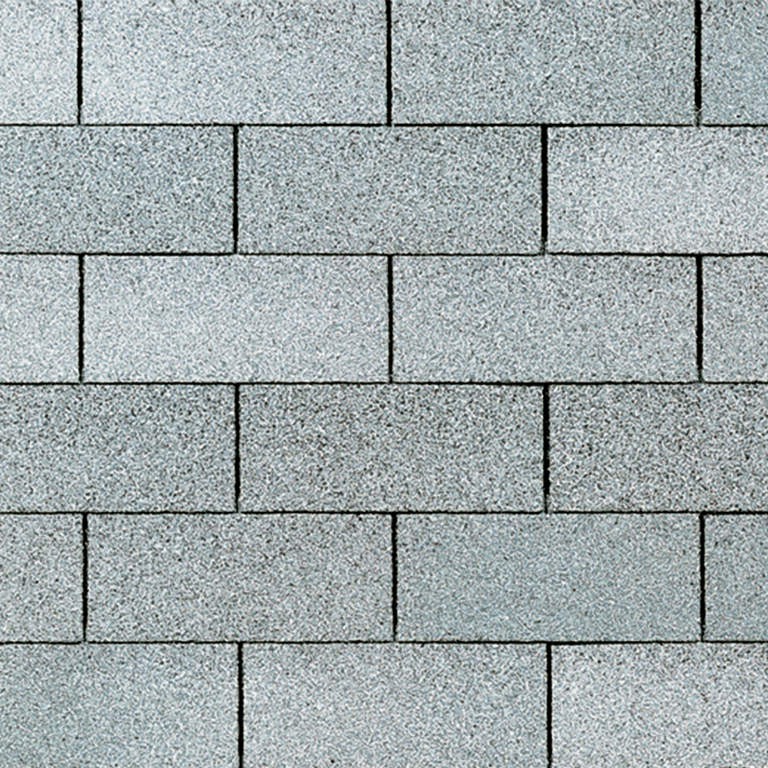

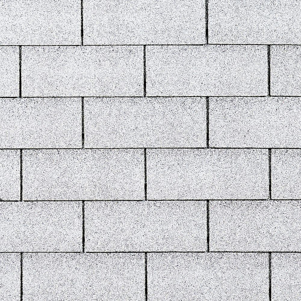

I never seen a white shingle roof. Except this morning,.it's snowing,..but anyhow.
I've seen and done about a million light gray roofs. The result when you leave depends greatly on the degree of algae on the roof. If there's alot,.you can kill it and perform the job properly altogether,...and it will still have shadows of what was there. I always tell customers on these jobs that the mold will be 100% dead,..and it will be 95% visibly gone,..and then explain the process. Never an issue.

It will look great after a rain or two. White roofing is just that way. We rinse every roof and I always tell the client "Mother Nature will make it look even better" We look "1000" times better before we leave (clients numbers not mine. I always want to laugh when they say 1000) but there is always more

Jeff, it's interesting that you've not seen a white shingle. I roofed houses all summer long in Texas one summer. Was working in a lower income area of Fort Worth. Every job was an insurance claim and every single roof was white. The thought was that the white shingles made the house cooler. White shingles can look trashy by just walking on them on a hot day. I've literally left footprints. Also, certain colors are only available in certain areas because the plants only ship to certain states.

We had two colors when I was working in South Carolina. Aspen Gray and Shasta White. Both light colors.

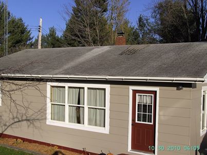

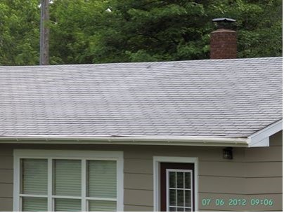

Cleaned this roof about five years ago, middle of October at about 55 degrees.
Was a little leery about doing it at that temp. but the owner was putting house up
for sale and wanted it done. a little staining remained but by summer it looked like new
The homeowner was happy and that is what mattered
both of theses shingle colors come clean after a rain or 2.
unless like maverick said granular loss then they look like poop
