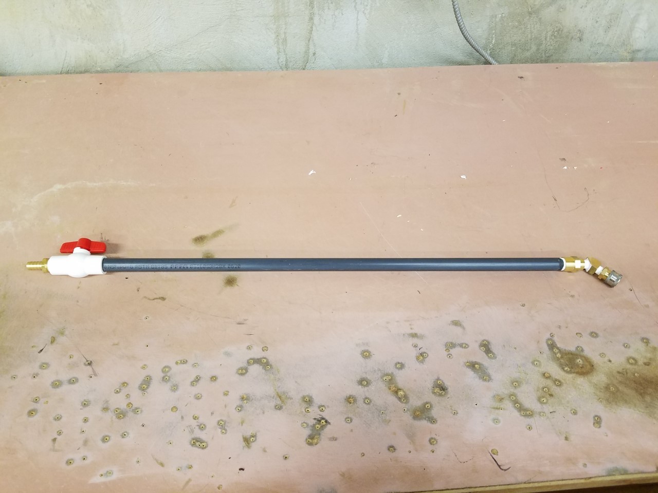

We use the PVC wand assemblies that Powerwash Store sells. See the Pic attached. I used to make them, but it's just not worth it. They sell them for just over $20 bucks and by the time you get the parts and make it, you are at that price anyway. They use SCH 80 risers and let you order them to length. I order them at 30 inches and just got 10 more in yesterday. I also order a few 48 inch ones for a little extra distance if needed. The come with the ball valve, riser, quick connect & all the fittings needed. I get them with a 45 at the end, because we like that. Call Bill he will hook you up.
That's all I use also, I got tired of the plastic pipe braking

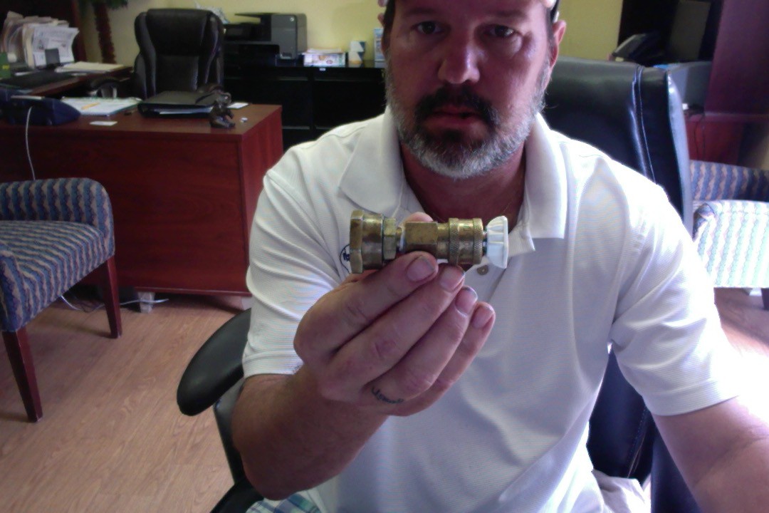

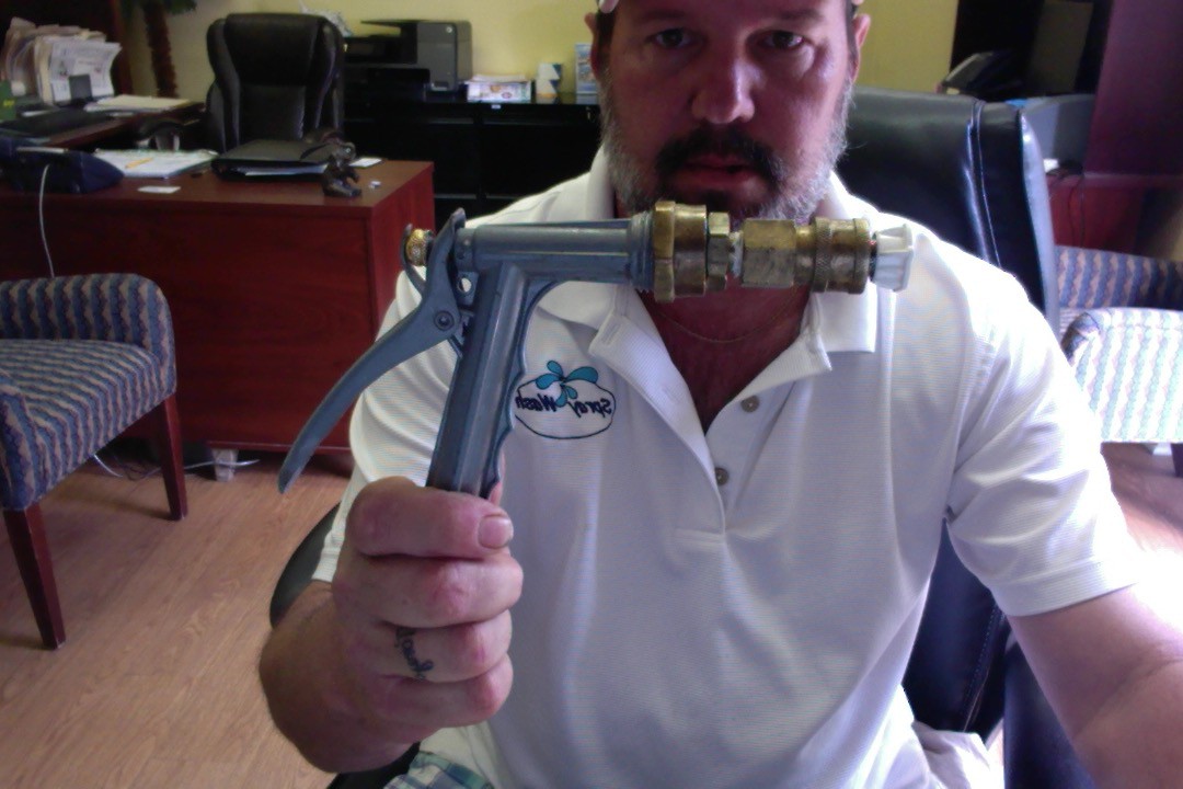

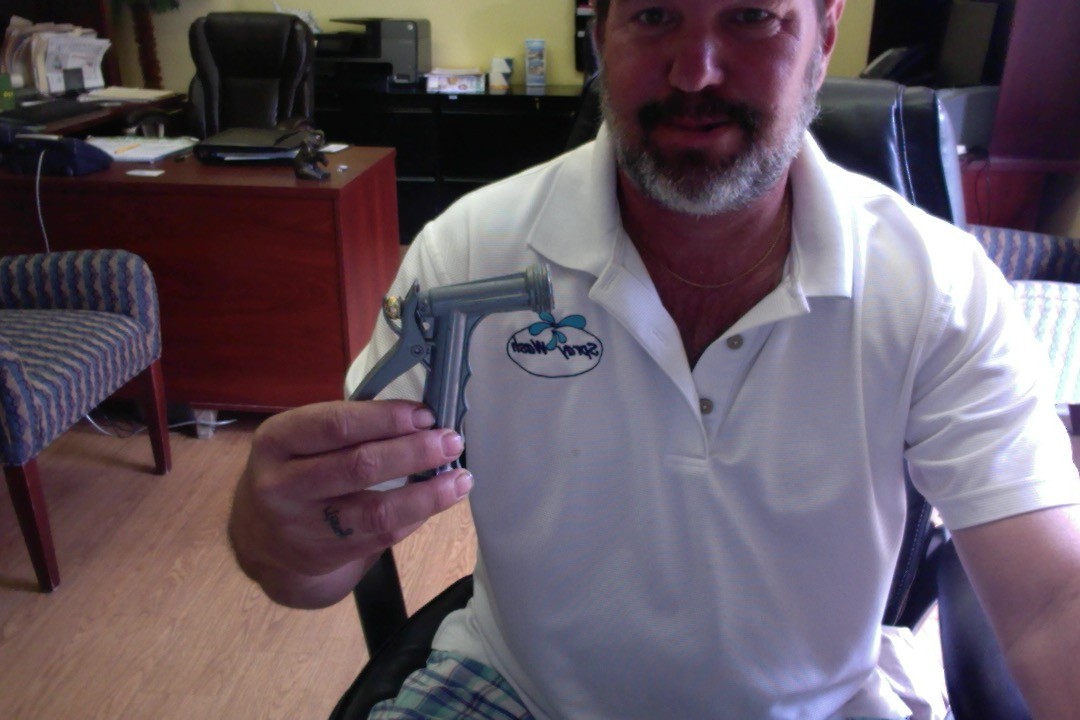

With the booster pump I prefer to keep it simple and just use a Gilmore sprayer form HD or Lowes. I get about 4 weeks out of it, then pitch it. These spray just let you go from jet to gentle come spray by simply moving the trigger. When I want to "tip down" and rustic my sauce I use this tip attachment I made.
Ball valve and a 4 banger. Kicking it old school. I like a small extension in theory but it always ended up getting in the way.

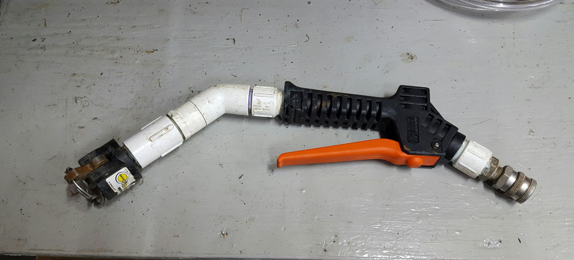

I finally got a picture of that we use. I use to have an extension on the end but found they like to break it. The guys like this and we get the distance we need. The back end is angled to keep the hose from getting stressed. The female banjo fitting is on the gun since our hoses go through the wall of the truck on rollers. This has been the same set up for 5 years and has worked extremely well, replacing the gun 1 - 1.5 season with proper rinsing.
I've used both a poly gun and a ball valve for an extended period of time..gone through several of each. I like the gun for it's ergonomics and control. If you're easy on your equipment they can last a good while.
