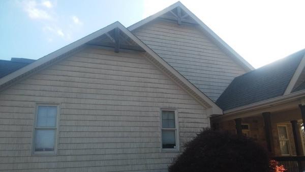

Here is a pic... there are wood beams at the very top that they want washed as well. Suppose i will just hit them when i am doing the siding.

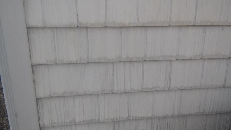

Only on one small area, there are dark stripes along the bottom inch of the siding. Any idea what this is, and how to treat it? Not sure if it matters, but i did the finger test and found no oxidation that i could tell. Will i need to scrub these with something?

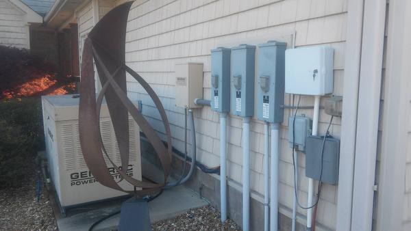

Also, very basic question here, how much do you do to protect boxes like these? Do they require being taped up, or will they be ok as they are?

Ok. prewet the wood and you should be ok. I wouldn't spray them with chemical dry. On the siding. looks like algae to me and should clean up beautifully with a 1% house wash mix. I usually at least tape along the top of those boxes so nothing runs behind them but some guys bag them completely. Those cable/phone boxes too.
Good luck...I think you'll have a success with this house.

I cover the AC units, etc. and ALL outdoor outlets.
Oh ok i hadnt thought about covering the ac unit... good idea, ill put a tarp over it, i guess. Thanks.

At 1% there isn't much risk but pre-wet, then rinse. The problem with the wood could be a couple fold. If it has nothing on it then pre-wet and you should be good. If there is a stain on it then maybe not so good. Hard to tell from the pictures but some stains will "fall off" even at 1%. We will usually cover or pre-wet, shoot and quick rinse. On wood with a stain be sure to never get too far ahead of yourself.
Electrical:
Big exterior boxes are usually pretty well sealed but we still tape over the top with our ends extending. I've popped a couple so prevention is never a bad idea.
We tape off virtually everything to the point of overkill. I can't tell you how many times I've seen exterior electrical receptacles short out or pop a breaker when they were not covered. I have videos that teach my guys how to protect them...To me it's just that important.
The lights in the soffit I would not cover but lights on the walls we tape off at the sides and top...never at the bottom.
I don't cover A/C units unless the client requests it. I clean them then rinse well. Nothing worse than a nice clean house with green stuff all over the A/C unit or gas meter.

Ask Ray Burk to post a pic of a deep fried electrical box!😁
Mar 29, 2017
I think it was him with some narley pics of what salt and chlorine can do to electrical

Doug, thanks a bunch man. I found out they are planning on staining the wood beams later, and want them cleaned to prep for it... so looks like it doesn't matter if the old stain comes off (if it's currently stained, not sure about that).
