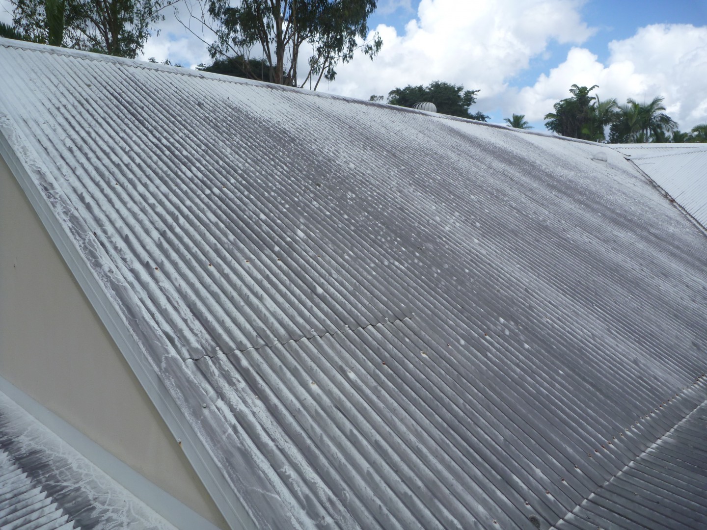

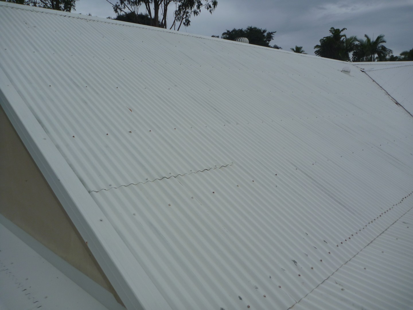

Bleach (2 - 5%) & detergent, plus a bit of pressure to lift it all off

I've attached the photos as I got a message that they're not visible. Wow, there's the ability to insert from an attachment.... whatever will they think of next
