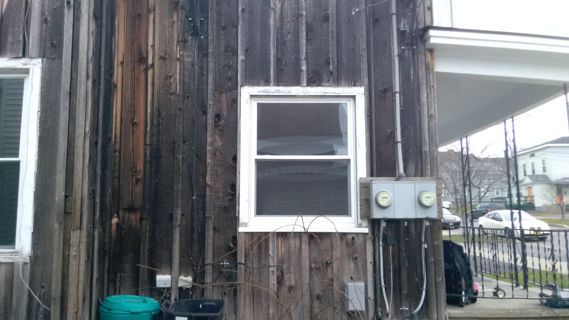

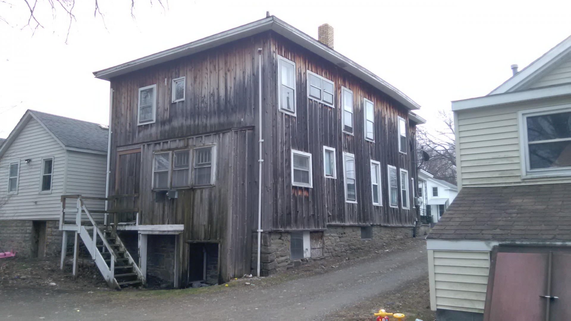

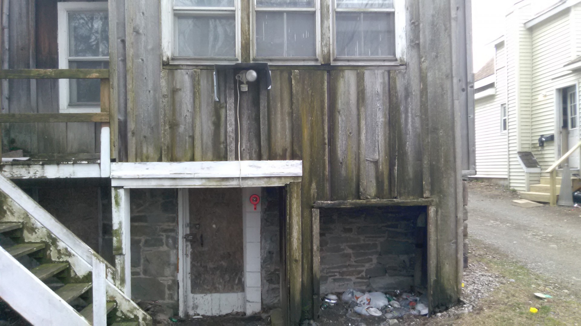

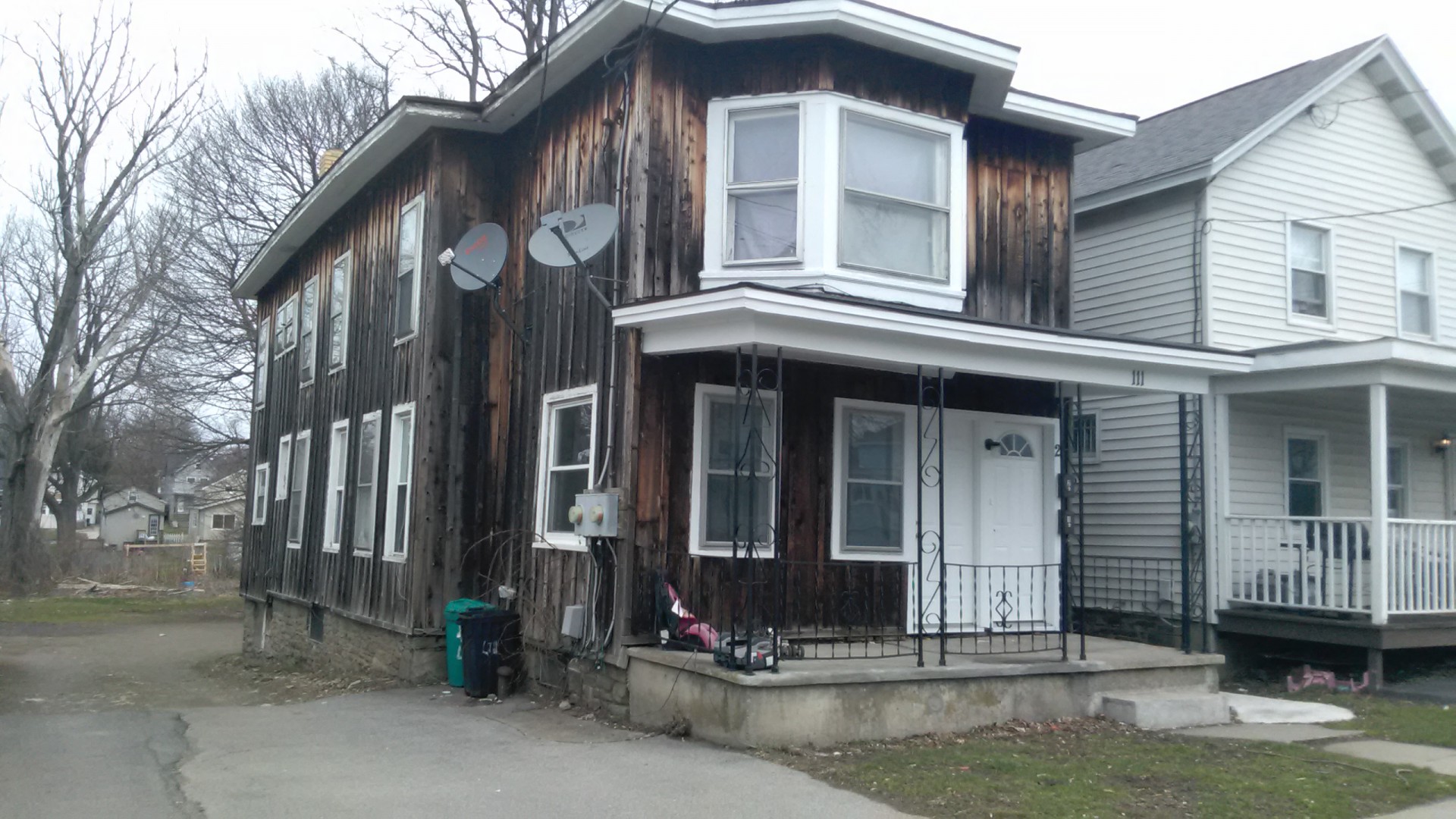

Would anybody tackle this job? What do you recommend?

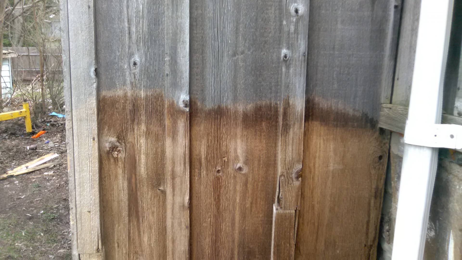

Sodium percarbonate with caustic soda, rinse... oxalic acid and rinse.

Brett, what's the ratio? percarbonate? hydroxide/caustic soda?
Apr 4, 2017
Mike,
The search button will reveal a good amount of information on wood cleaning and castics, etc. Read up on them and you'll have a better knowledge for the future.

Oh Hell Ya! Those are my dream jobs. I drive by a house like that and I get wet just thinking about doing it.

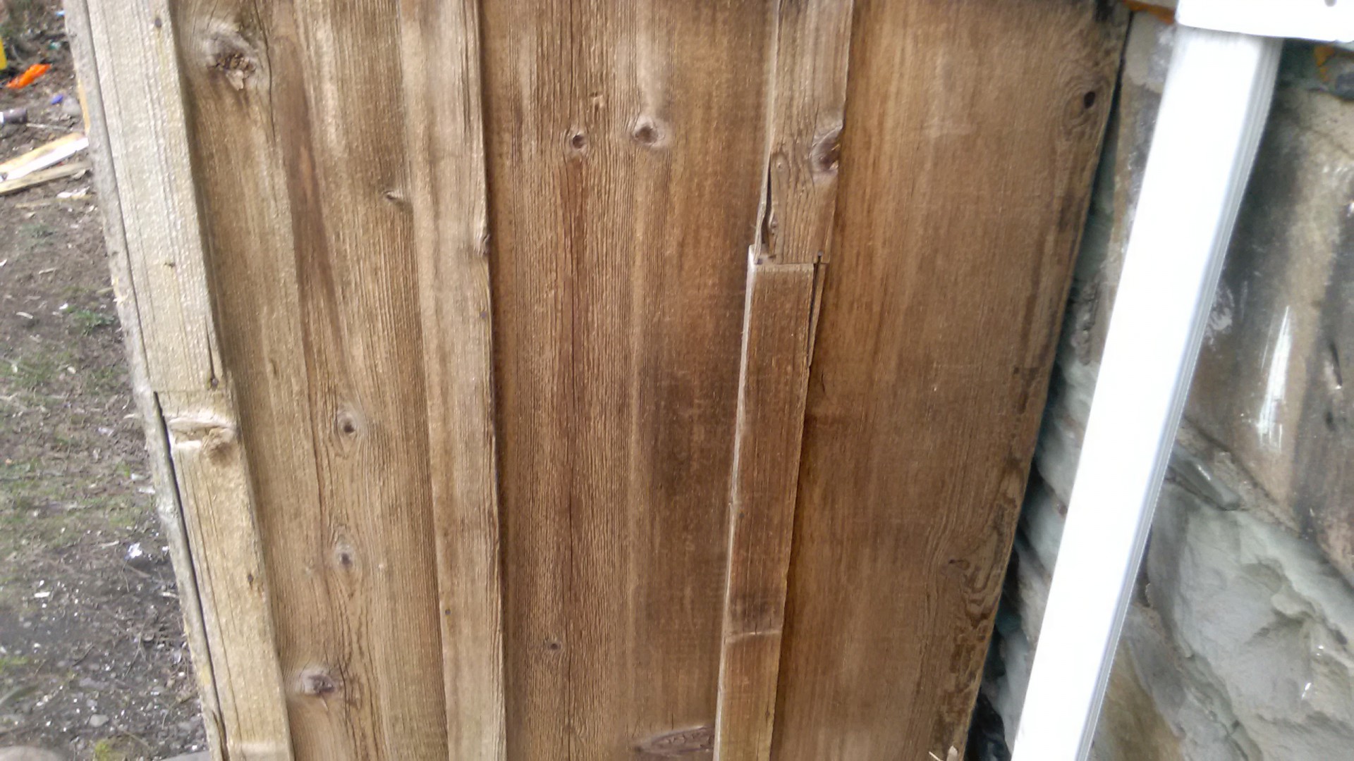

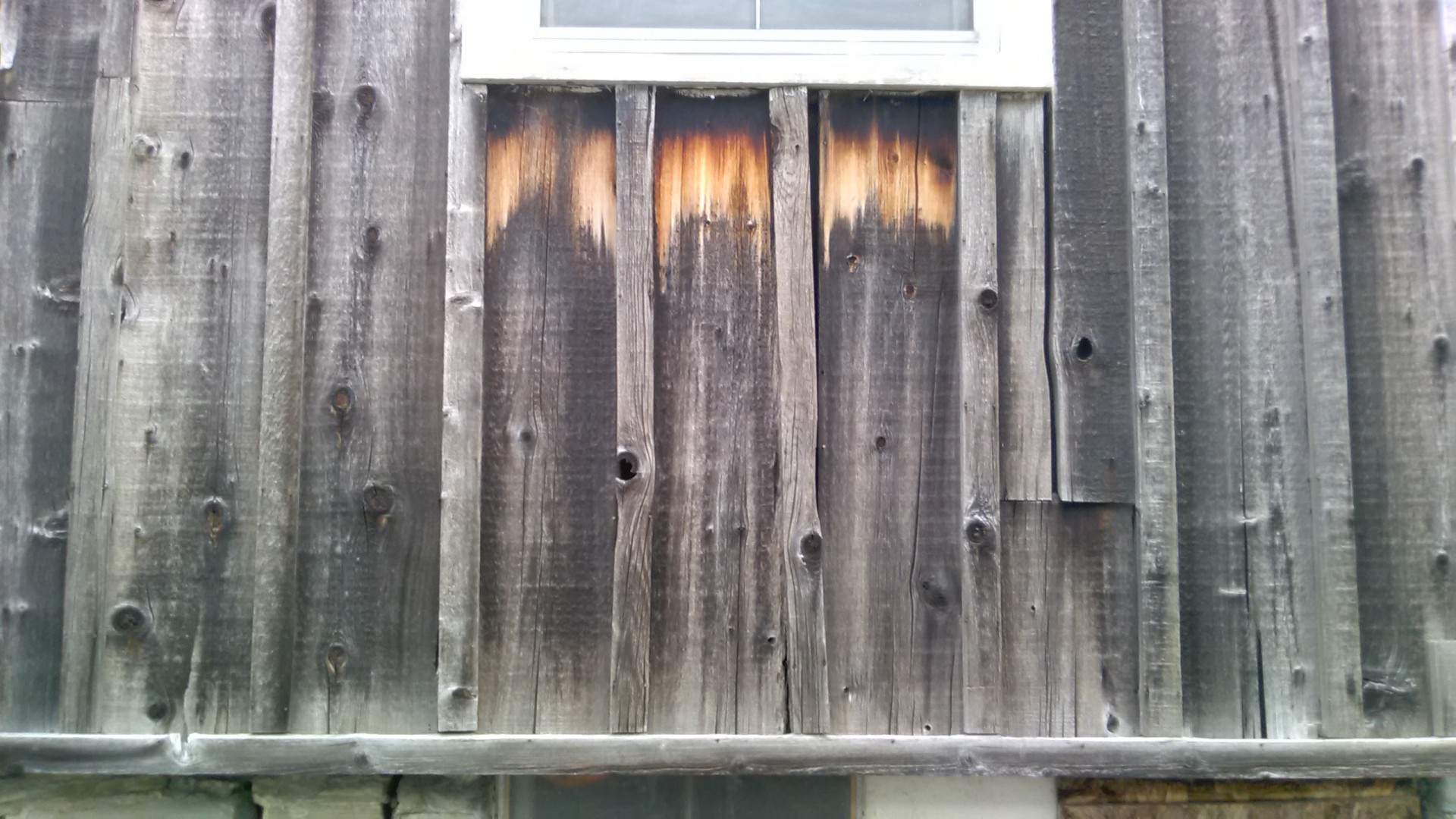

Updated Pictures
yup...that is money in the bank AND awesome B/A pics for the web-site!
Test we did to show the homeowner what to expect.
