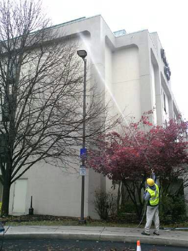

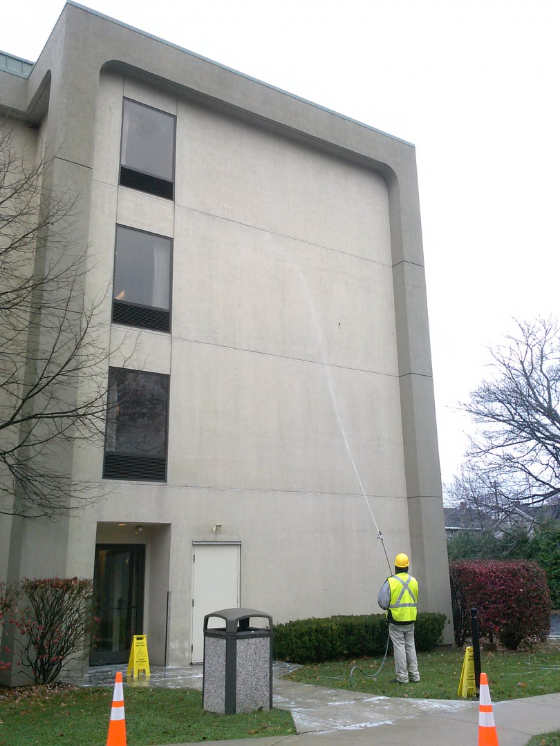

we are at 4 with guys shooter tip. Running 8gl now we are running 10gl and guy just made new tips for 10.
Apr 7, 2017
Totally agree with Eric. Our shooter tip from Guy gave us the capabilities to shoot this hotel at four stories.
I have one of Guys shooters and it is working great, James V's shooters work well also
