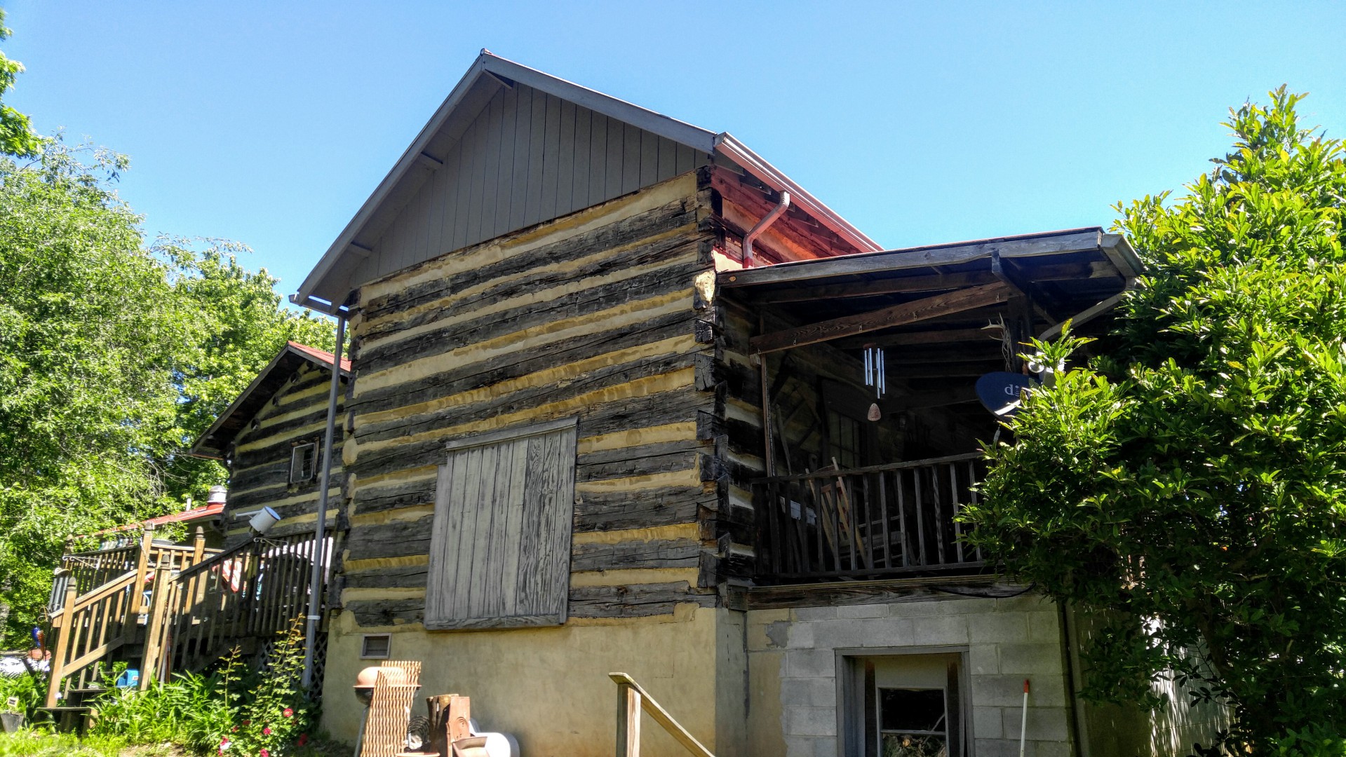

I am looking for help or advice to clean the wood logs of this house. I think I know what I can do, just seeing what others my have to say.
Thanks,
James

This log home is in good shape for its age. The mortar between the logs is very solid. I was thinking of using one cup per gallon of sodium percarbonate then come back with 1 cup per gallon oxalic. Would this be the correct approach?
Also, cleaning the siding and roof before starting the logs.

For these logs,..I'd be at about 3-5 OZ. Per Gallon NAOH applied direct,.then neutralize with oxalic at about 8 OZ. per gallon. May need to reapply under the porch areas to get the black outta' those logs.
Mix some general soap in with the NAOH to get it to stick to the logs and allow more dwell and "wet" time. When you rinse,..don't worry about removing all the soap suds,.because they will just keep coming. The application of the oxalic will destroy the suds.
*I'd be rinsing at about 800-1000 PSI about 18" away from the surface,.. with a wide fan tip,..like a 40 degree. But a 25 will work also. These jobs is where GPM is so much more effective than lower GPM.

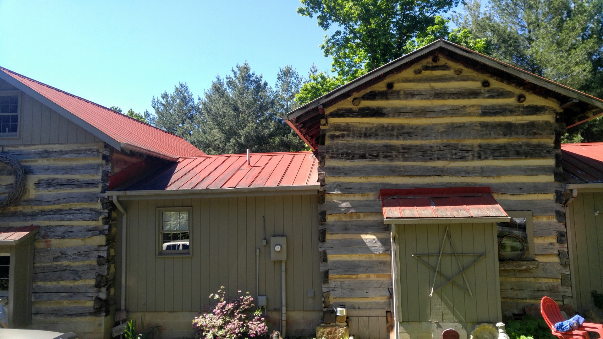

Here is a before and after of the log home. The home owner was very happy that they cleaned up well. Thank for all of the help!!
