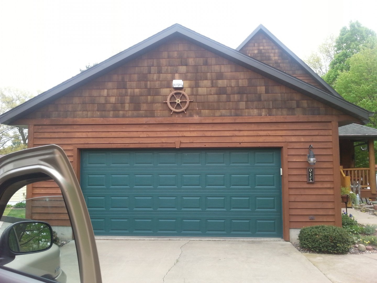

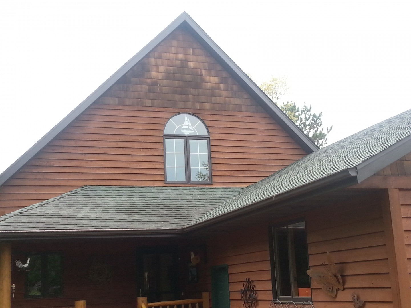

Looked at a job today where the homeowner wants there asphalt roof cleaned and wanted to know if I could clean the cedar gables.
The cedar siding and cedar gables are both stained, just different colors. Apparently they used different types of stain [the homeowner did not remember] being the siding looks fine and the gables are discolored. They do not want to restain just cleaned if possible. Did some searching but still unsure of the proper method
of cleaning without disturbing the siding below it. Any advice would be appreciated.

It's going to be difficult cleaning the shake above the siding. A bit of MacGyver might need to kick in here. No guarantees!
I would find some rubber roofing or inner tubes. Carefully slide the rubber between the two different sidings making sure you pass the spot where the sidings overlap. Get at least 4 but preferably 6 mil plastic and slide that under the rubber. Roll in over on itself so it is thicker and keep in place with push pins. If you can pull this off you are a hero. If they understand how hard it will be to keep everything off the lower and they are willing to sign off on that, you should be okay. Apply cleaning chems with a pump up sprayer.
Thanks Brett, I did read them previous posts but wasn't sure that would help in this situation. I did think about taping a tarp
along the top edge of siding to protect lower area. I like the idea of rubber, which I have plenty of but it may be best to decline that part of the job
due to the risk and inexperience with wood, just hate not being able to provide full service to customer.

I'd say if the stained siding below is in good condition,.Sodium Percarbonate shouldn't hurt it anyhow. I would do a test area somewhere inconspicuous and go from there. Sodium Percarbonate is fairly mild, but will clean the discolored area. Keep the good stain wet while spraying the top area,...I'd try 6-8 OZ. per gallon and then neutralize with Oxalic as usual. I mean,.I've washes many decks with stain on them,..simply to remove the mold and dirt,..yet left the stain undamaged.
Likely the siding below could stand to be cleaned (Although from here it looks good) at least clean it along with the job.
