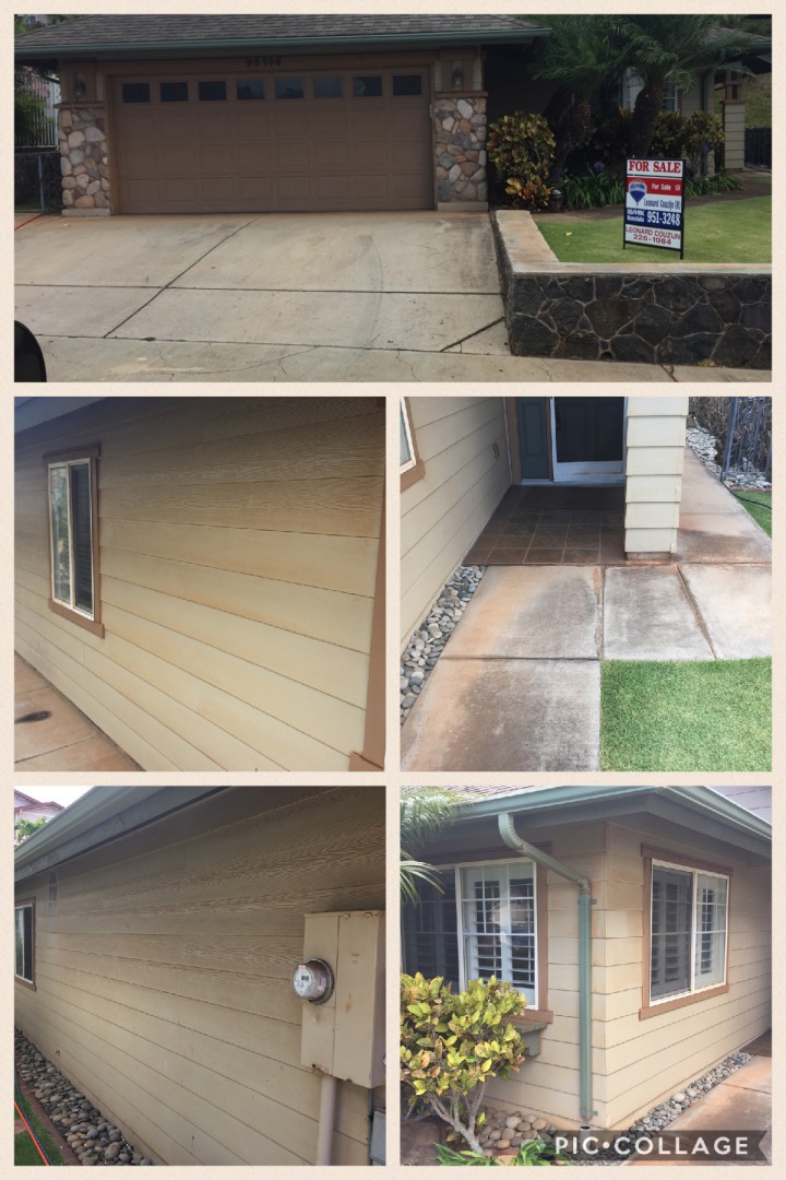

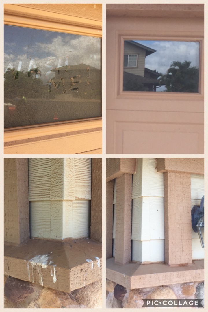

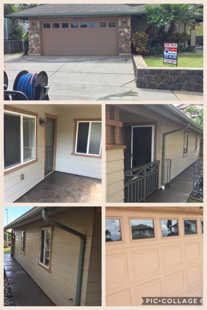

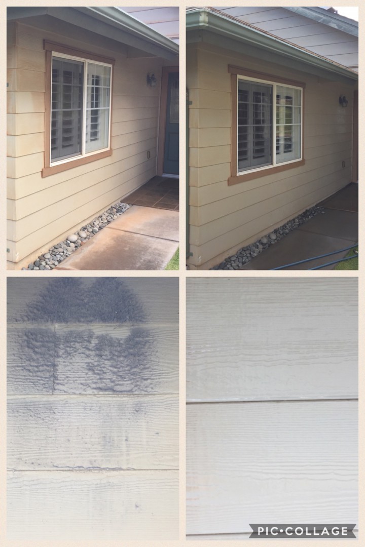

Aloha everyon! This house we did today was a real pain! We removed most of the red dirt but as you see a lot of it is stained into the aluminum sidining. This was a hand wash job with mits and Softwashing also. We also pressure wash the surrounding concrete surfaces
Hey Chris,..what acid did you try on the red dirt? Acids are usually a requirement for removing these type of stains. They need to be chemically altered so to speak. Typically oxalic will remove red clay stains,..or even diluted hydrochloric acid. May take a few applications and extended dwell times. If the aluminum is badly oxidized,..I would do a test area,.and try and stick with oxalic at about 4-6 OZ. per gallon,..applied direct.

Thanks guys for the info I tried this red dirt remover a customer mine gave me for a demo. It's was a very week acid and as you see a lot of areas we're very stained. I think I'll try oxalic next time. The customer was still happy because I did inform him prior that sometimes the red dirt won't come out all the way. The house was really bad but is kinda hard to see in the pics.
