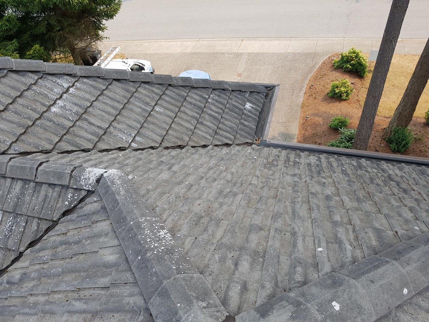

In the area where I live we have a lot of concrete tile roofs. The problem I am referring to is white areas looks like spots on the roof. I did my research online and some people saying it is calcium carbonate or Lime. It can be cleaned with some acids like (muriatic acid or acetic acid). I tried them both in a different concentrations. Almost no result.
Does anyone had successful experience with cleaning this?
The white spots look like Lichen to me, which can be killed using SH. (if that's what it is)

I wish it was the Lichen, but I don't think so. I tried strong acids and SH too - nothing works, only pressure washing.
Aug 9, 2017
I'm with Zach,..I think it's lichen,..especially the way the "grouping" looks. Just looks like typical lichen. What makes you think SH isn't working? Because of it's light color,..lichen doesn't show as dramatic reaction to SH as other molds and/or moss type growth. And it isn't gonna disappear upon application.
Aug 9, 2017
Yes, what Jeff said. We run in to that lichen all the time. The SH definitely kills it. It just doesn't change much visually. Give it time. Any dark bacteria stains should be gone though.

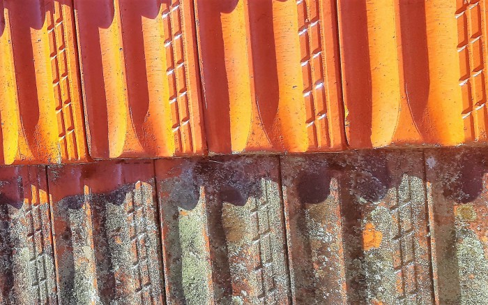

Cleanupcrew said
Aug 16, 2017
From a job last week.
They are terra cotta clay tiles that get bad with lichen.
A couple of hits with 3% SH makes it so much easier to pw it off.
