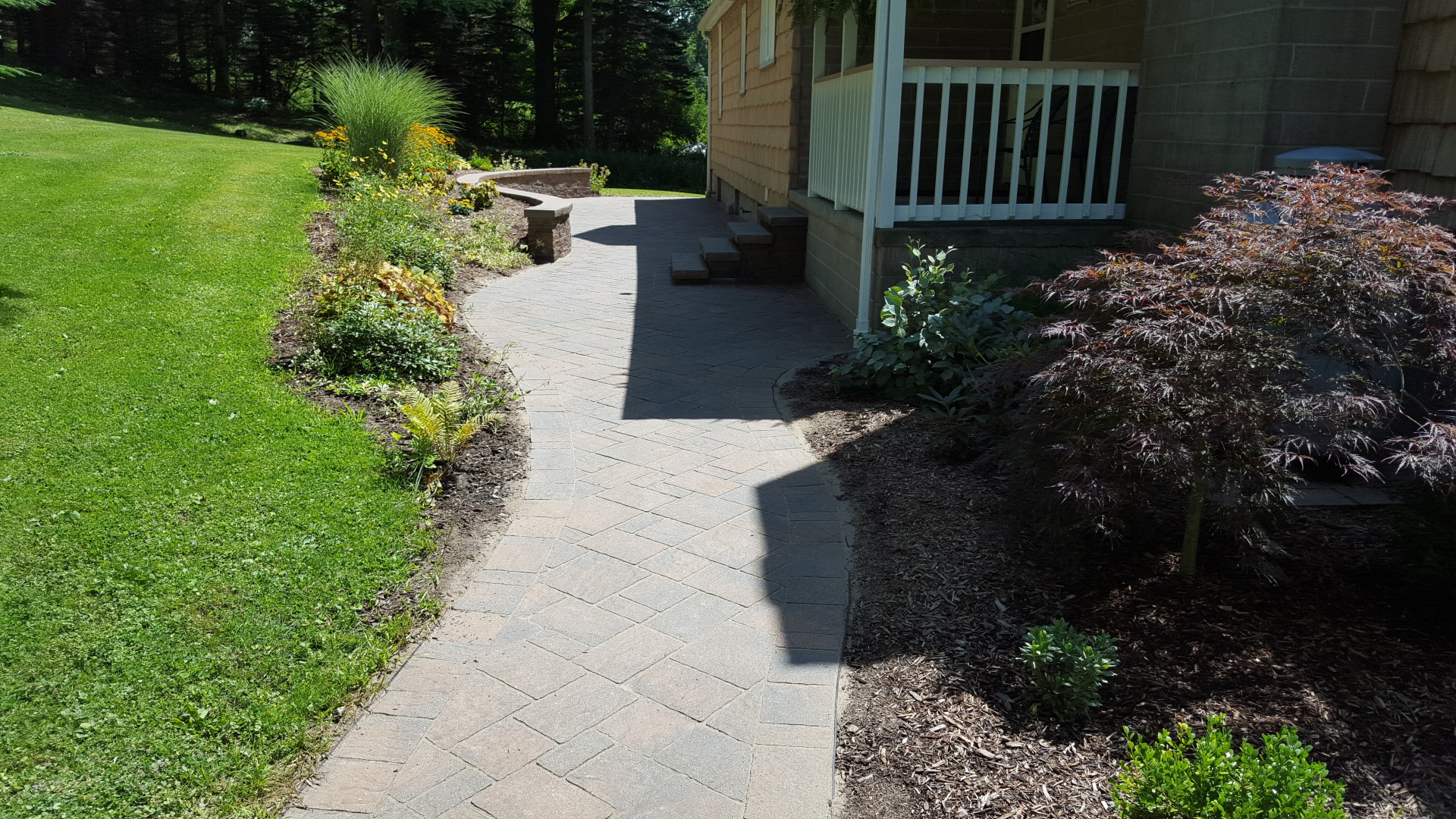

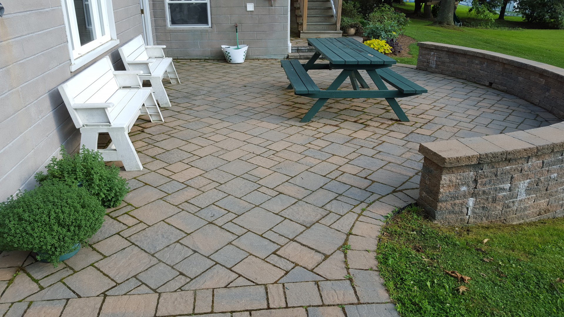

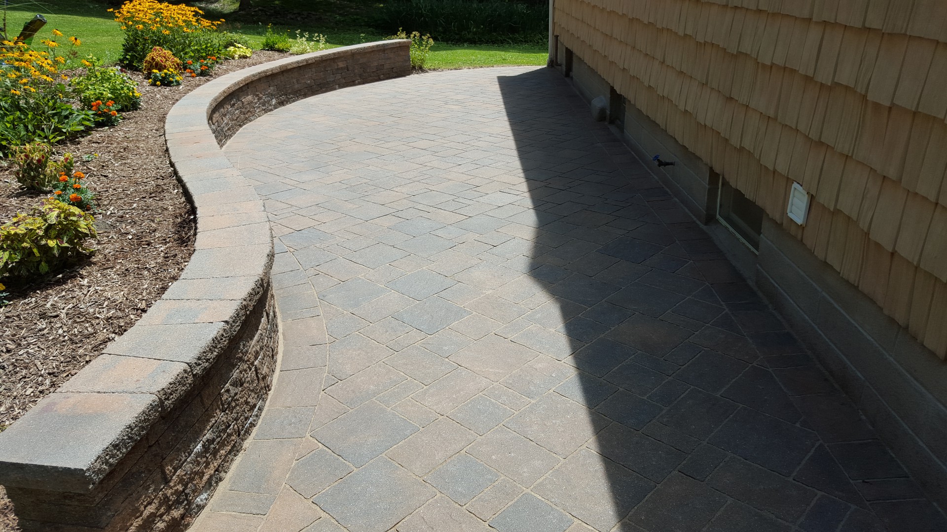

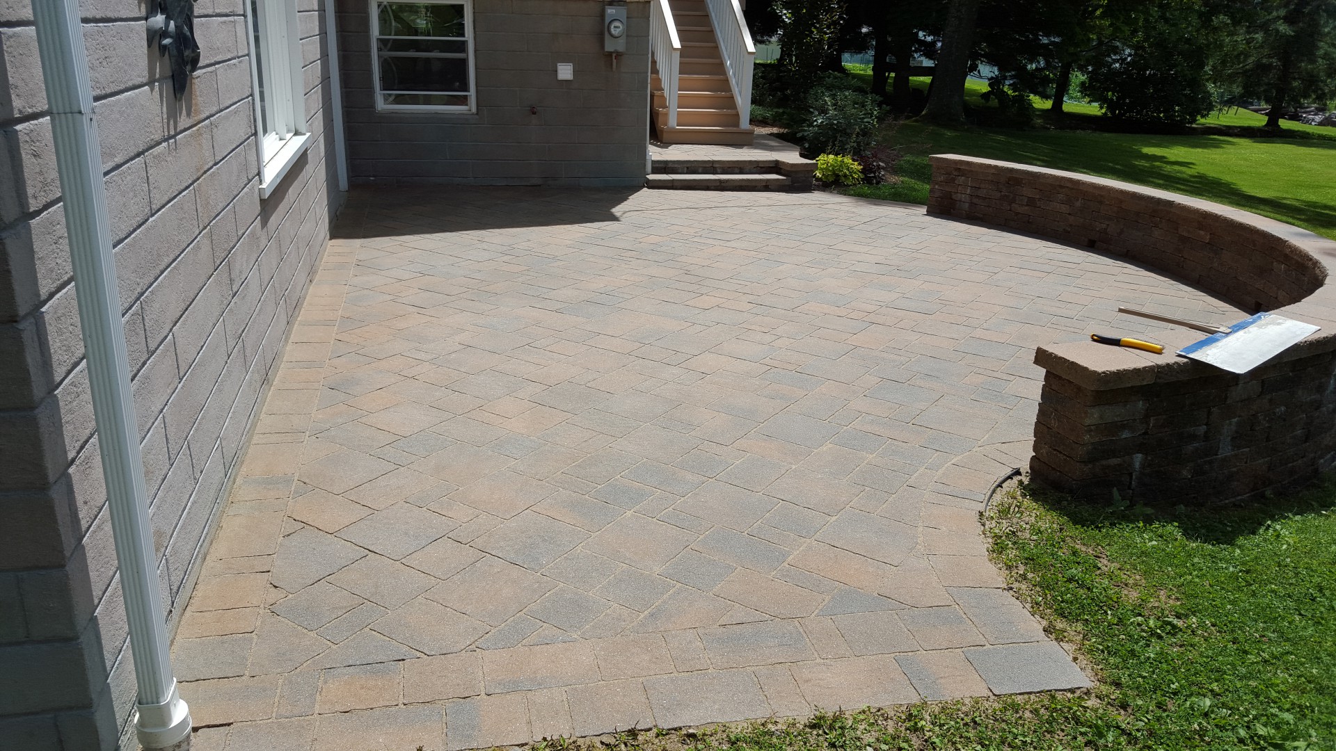

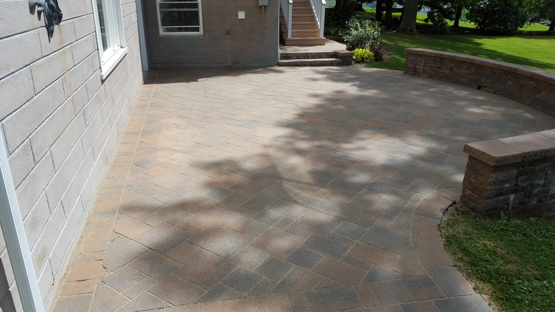

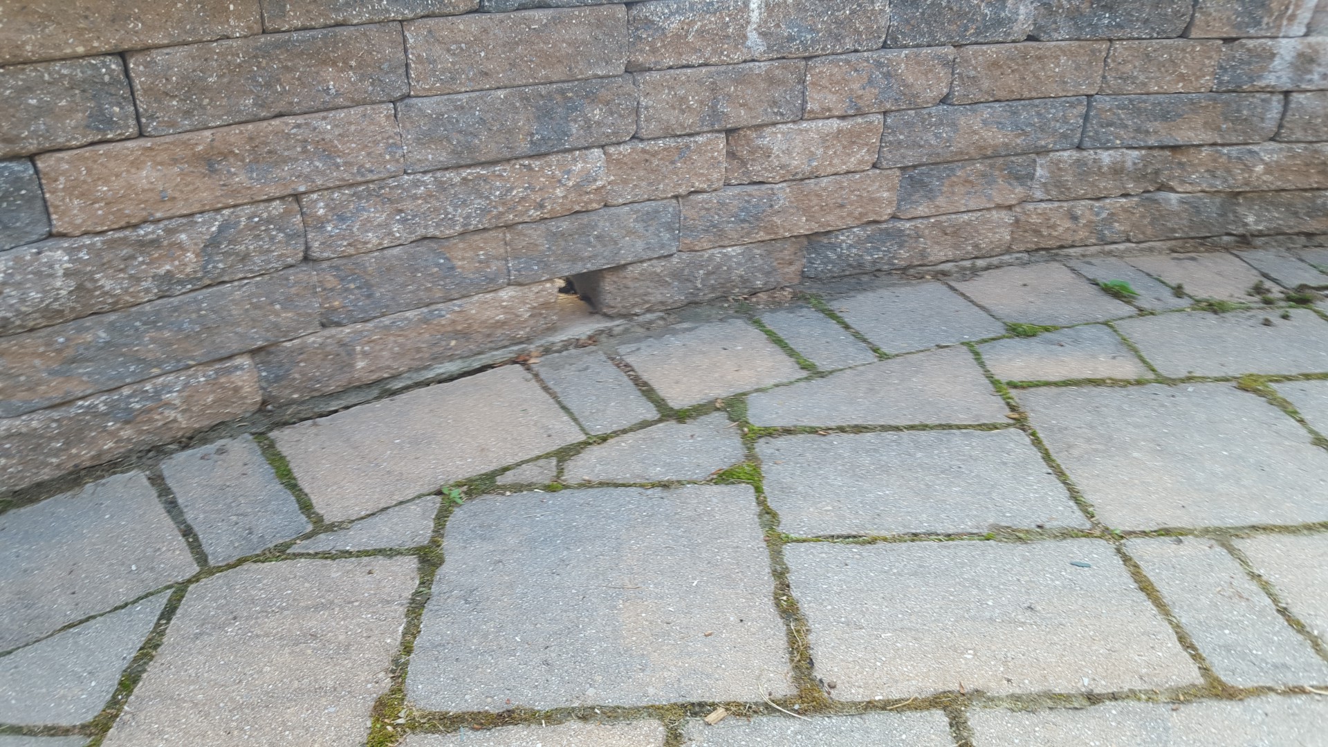

PAsoftwash was tasked to "Get Ugly Off" this Paver Patio. After it was chemically treated, pressure washed to remove contaminated joint sand and ugly stains, we resanded and compacted the paver joints with PolySweep joint sand.
After allowing joints to harden and dry out, we applied Trinic Stamp Shield Sealer.
