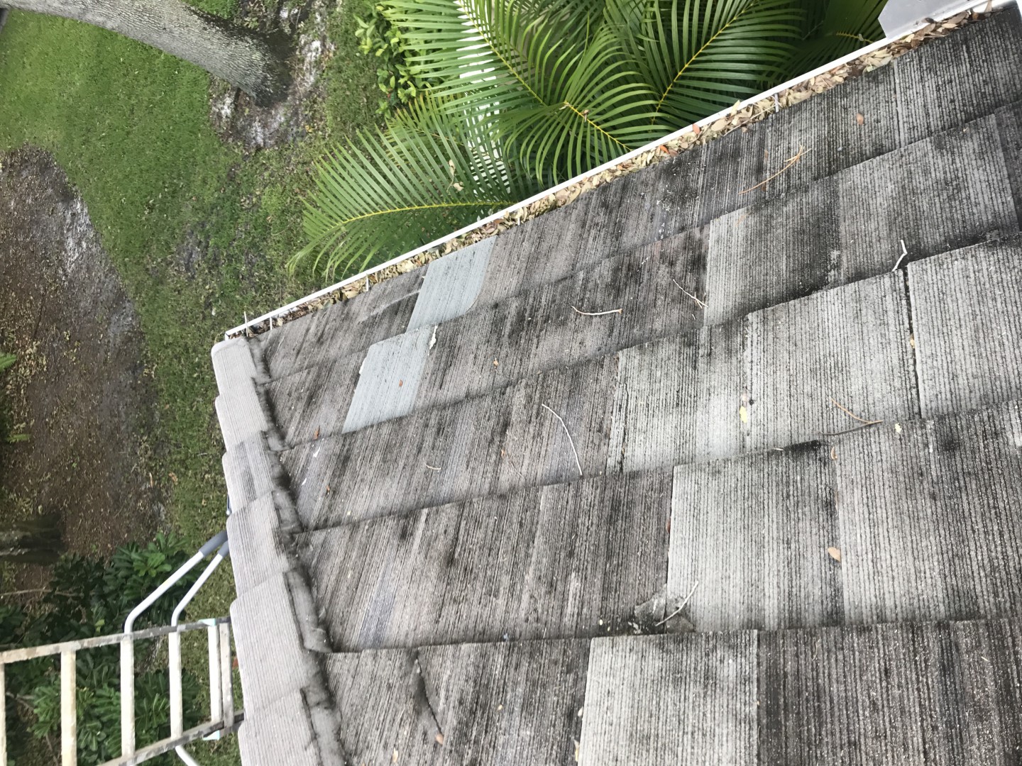

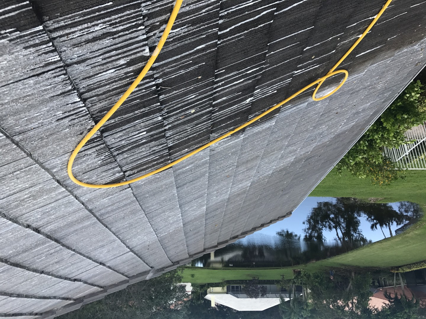

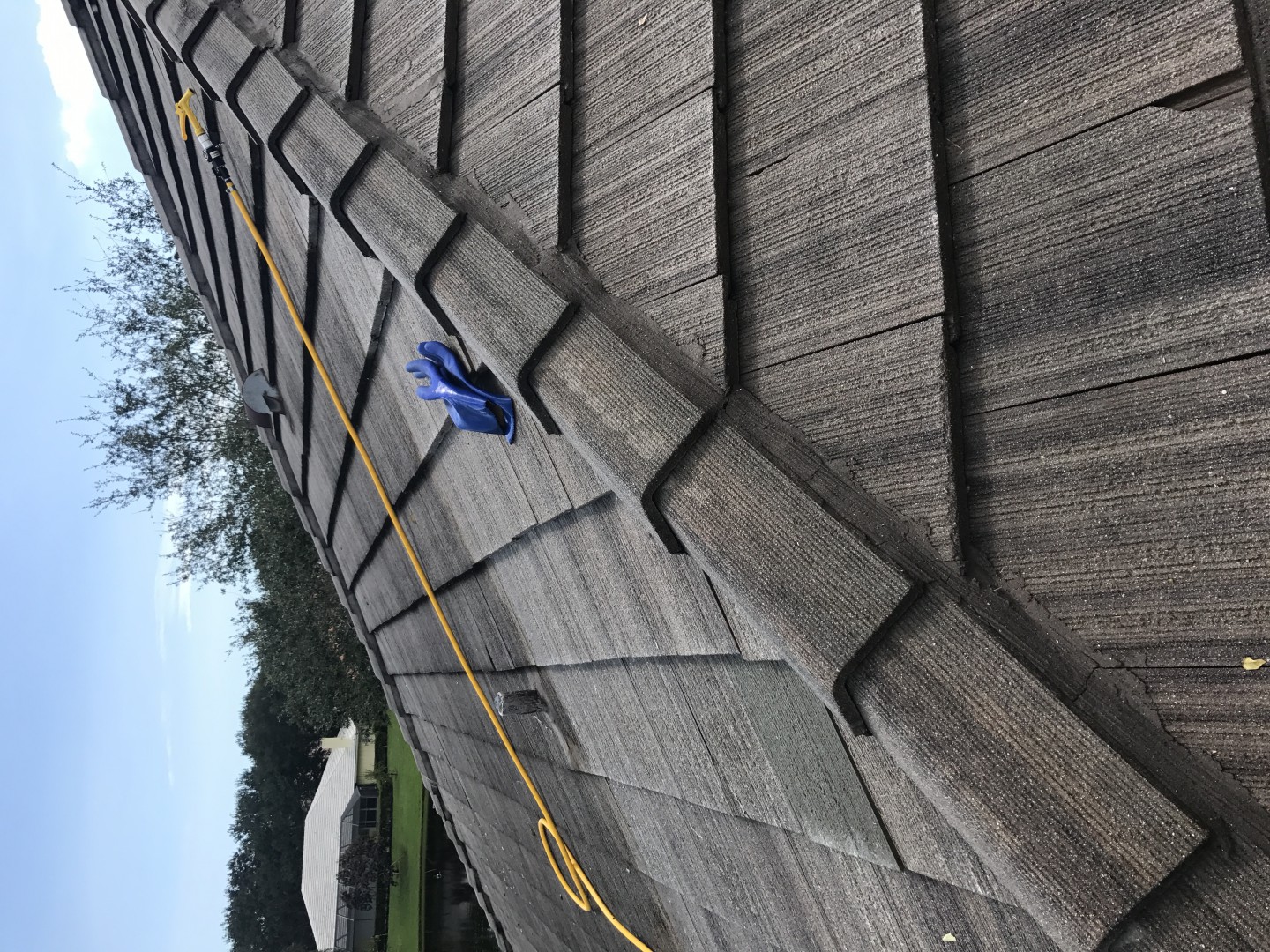

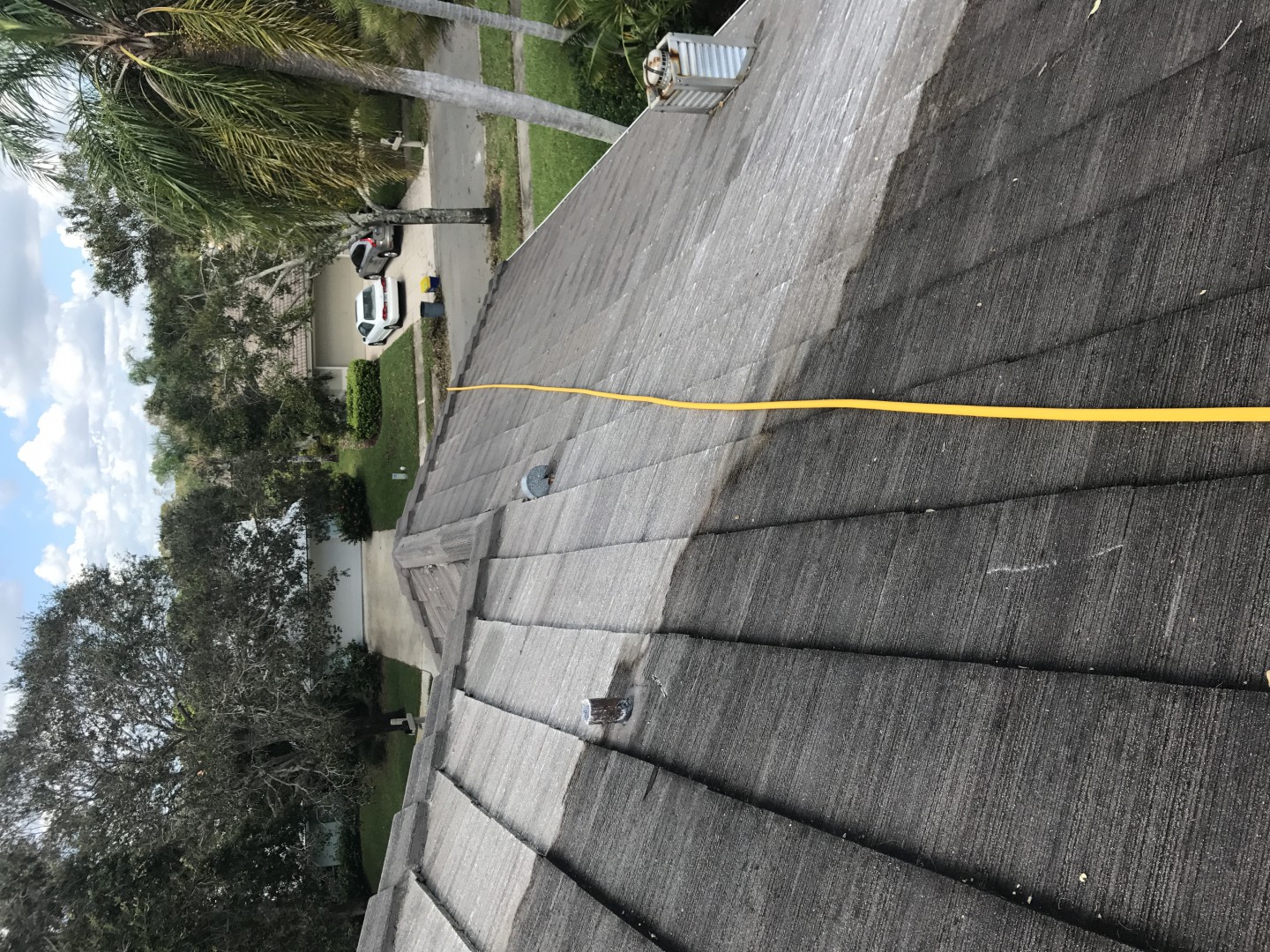

This is Edgemire Slate, cleaned it last week with 40/60 SH and slomo surfactant, came great!
Those are a concrete tile product but still have similar cleaning properties. Nice

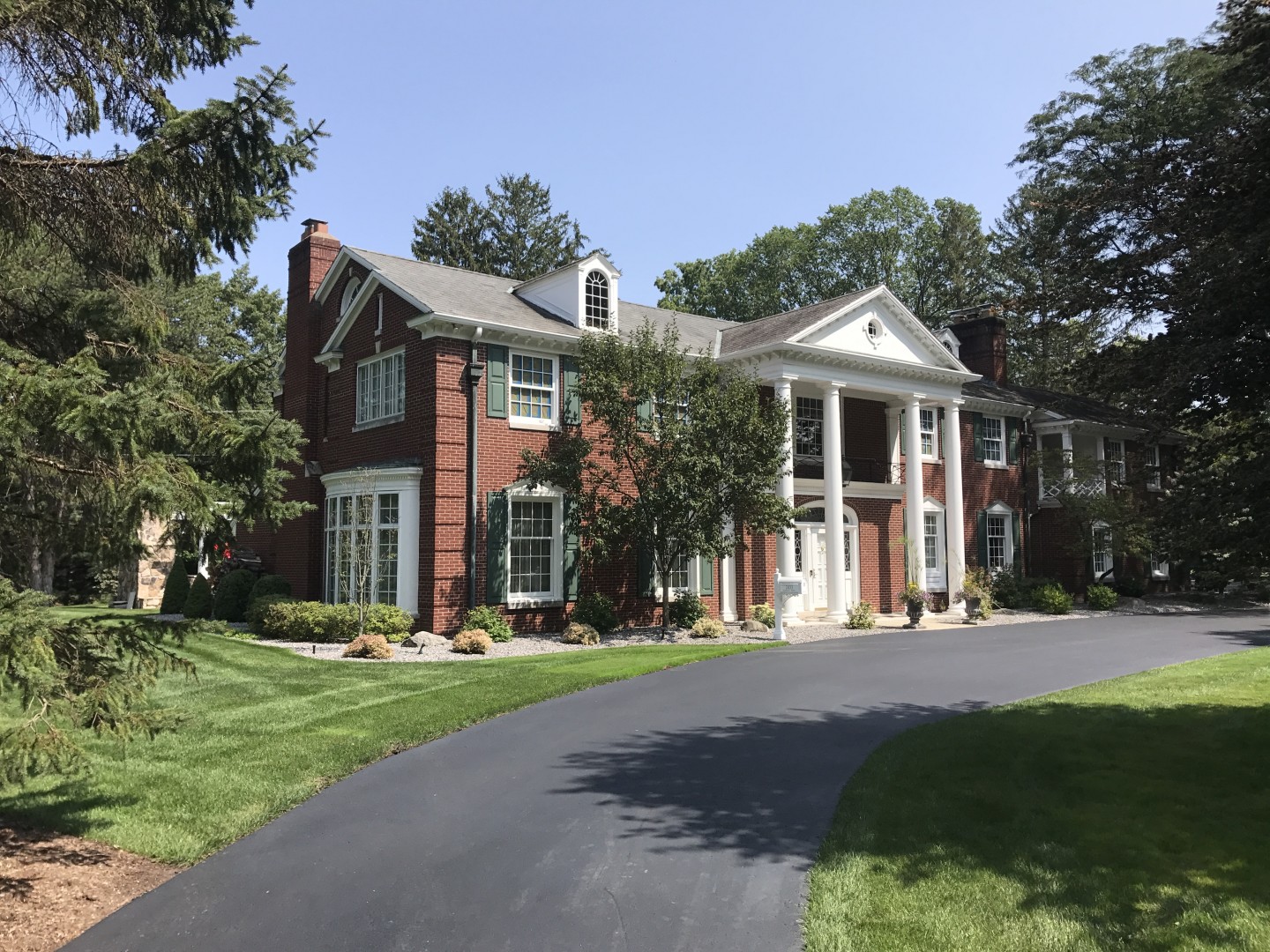

I use basic roof mix with soap. little on the hotter side like others have said but not necessary. I do not rinse and have never had an issue with them not coming clean unless the roof was absolutely terrible b4 hand. Its hard to tell from the photos but roof doesnt look too bad. Id let them know about delamination before you start. Its either there or its not but by cleaning it you will uncover it and it will be more noticeable
This is a great project for your portfolio. if you can get a drone or a picture from a elevated position then do so. Make sure you charge accordingly. there is more risk w cleaning a slate roof on a home like that then your basic average ranch w asphalt.
edgemire slate
