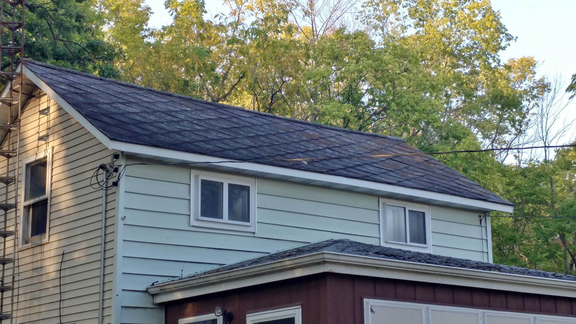

They look like old asphalt diamond-shaped shingles. They are are some companies that still make them.

It's hard to tell from the picture posted but we have quite a few around here with a diamond shape that are asbestos. If you had a better picture it might be easier to see what they are.

They are Art-loc shingles. Still made today. Sherriff Goslin is the only company I know that installs them arund here

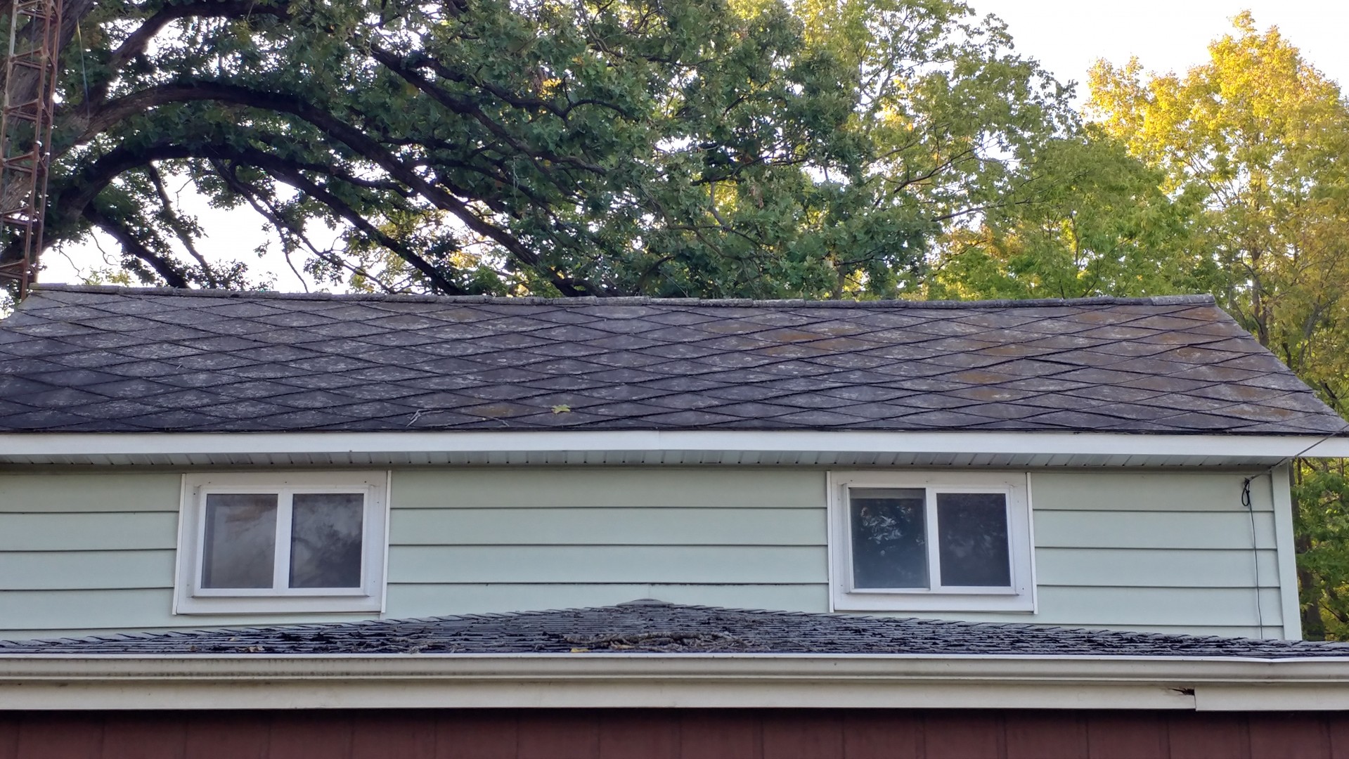

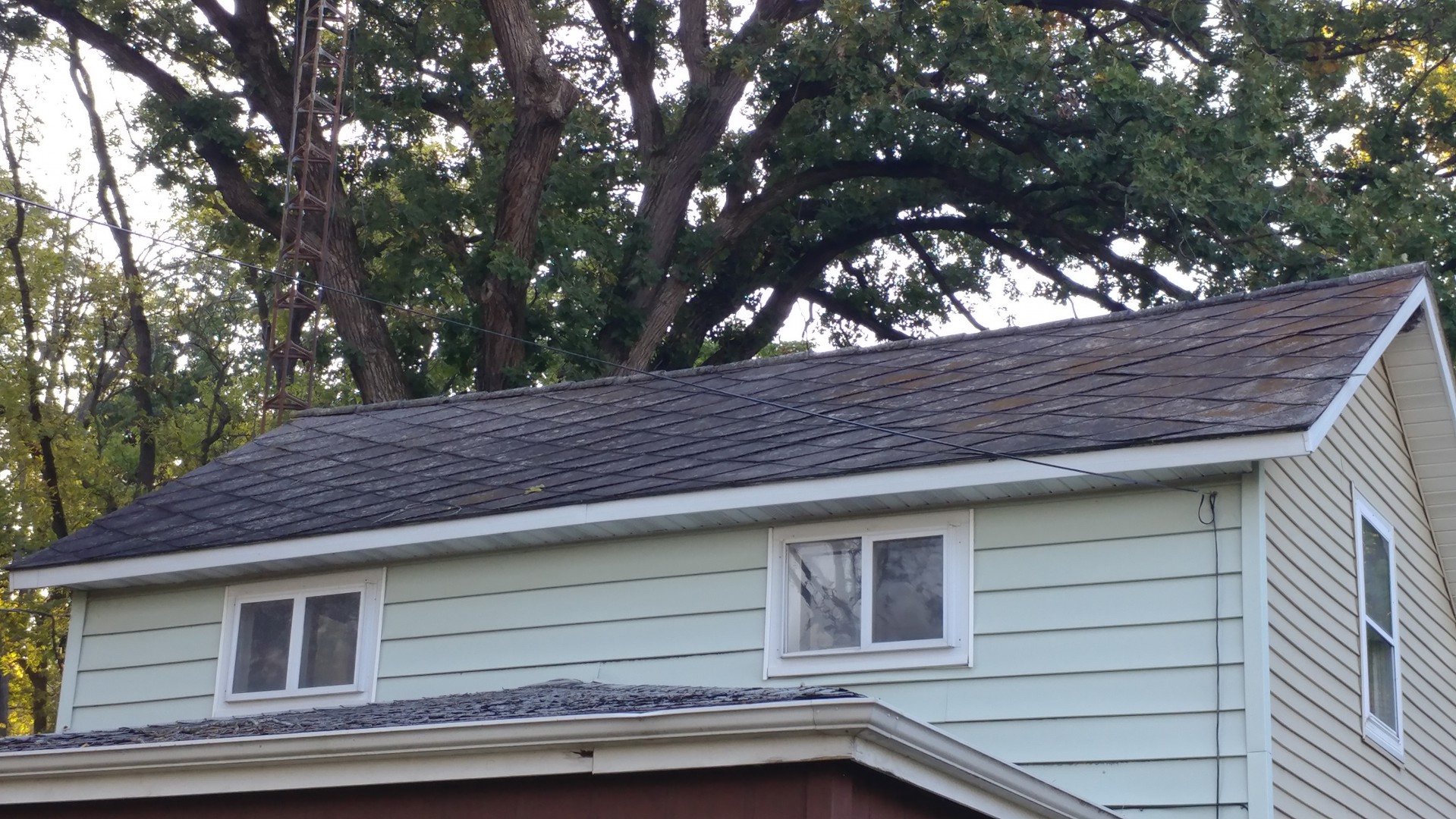

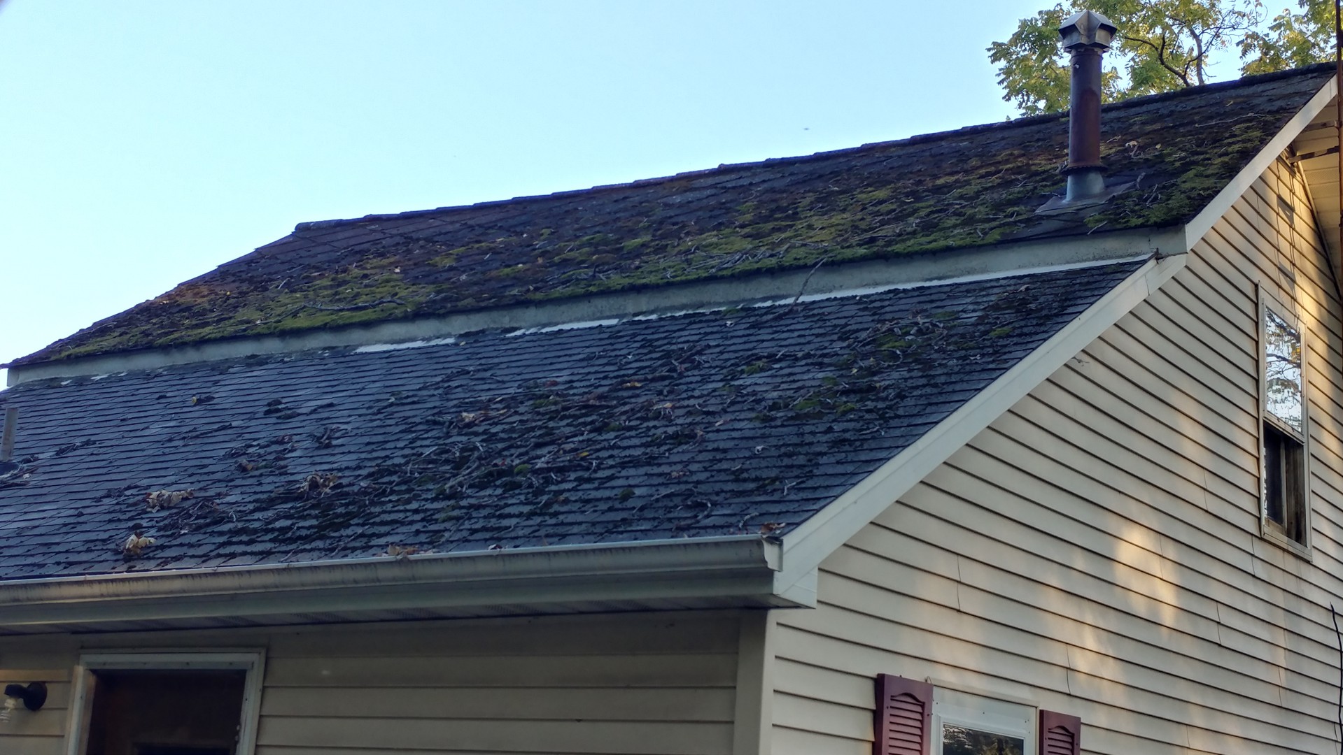

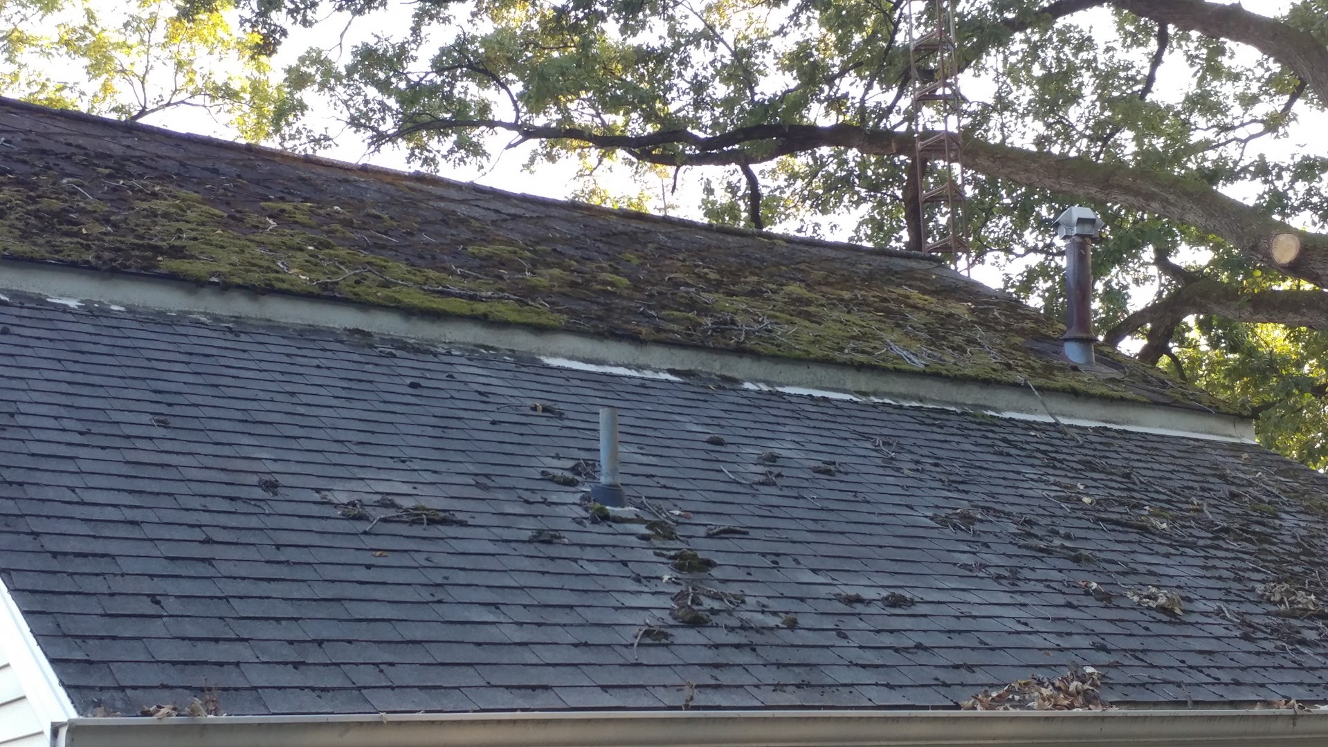

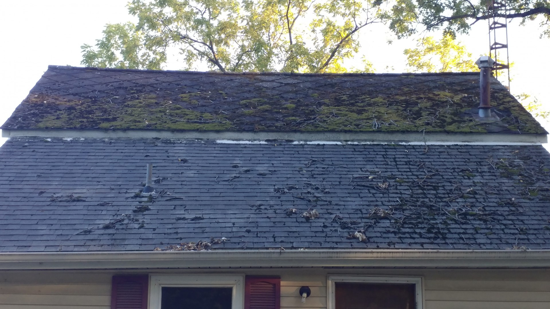

Here are all the photos I have. Hopefully this will help confirm the type of shingle material. If asbestos, is it safe to clean and will it clean up OK or should I walk away?
We had a company here on Long Island that used to make them. They were called Tile O roofing

My vote is asbestos shingles. My neighbors garage is just like those-- only clean now!
If it is asbestos tile, you cannot touch them. They are very fragile. I did not chance resting my ladder stabilizer legs on his roof.
It also requires a very hot mix to clean them. I applied several times before I got a complete release. The fact they were 100 years old probably had something to do with that...
Much like slate I did not want to shoot a lot of water under the shingles. If I ever do another one, it will include a lift so I can get above the shingles and safely rinse them if needed.

I don't think those are asbestos shingles. At least not anything like the ones I've dealt with. I believe those to be asphalt/bitumen shingles. They should clean like everything else we clean. They are just really old.

Does anyone happen
to know what type of roofing tiles are on this old farm house? I see it once in a while usually on older houses. Also, does it clean well?
