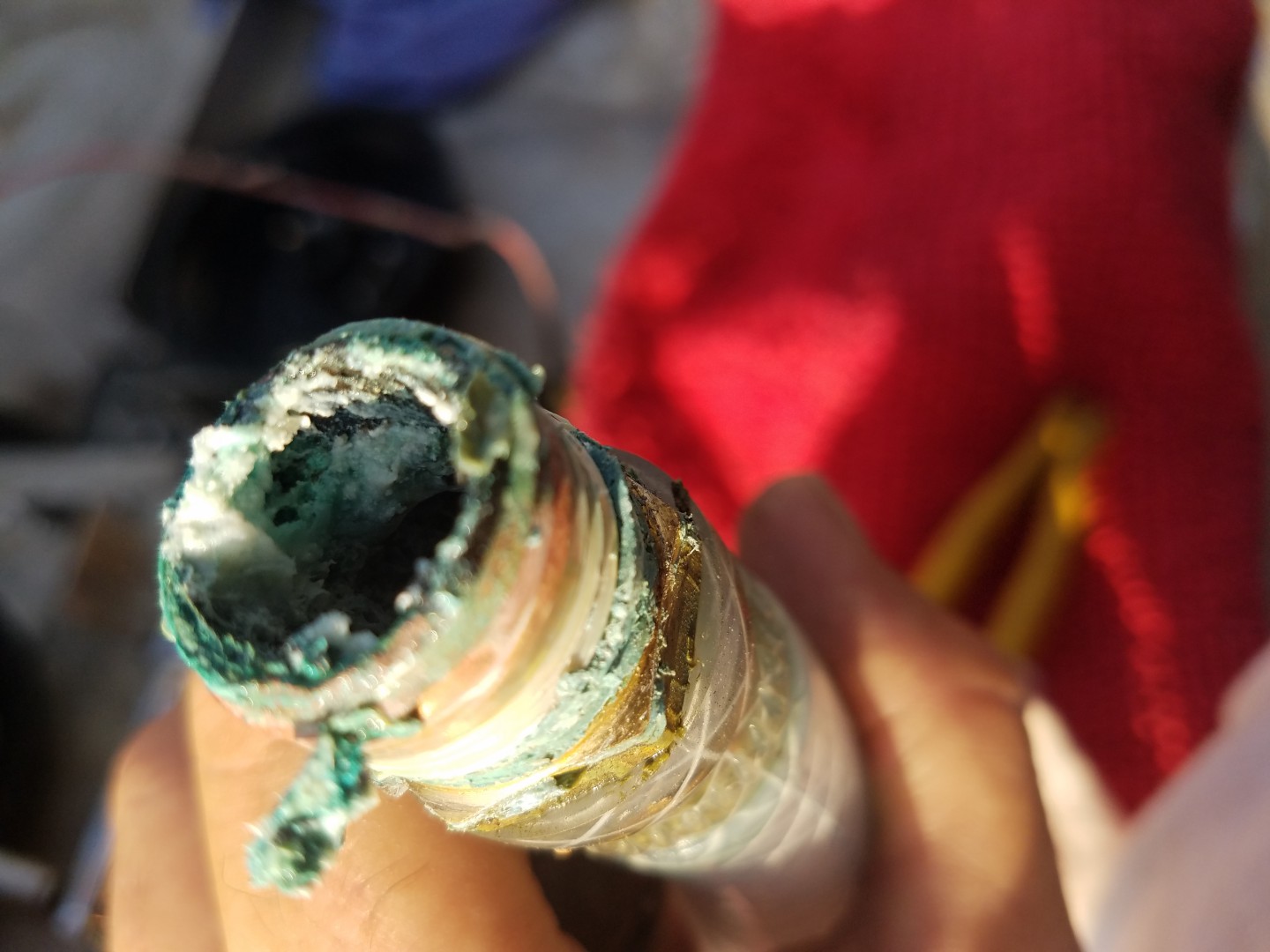

This what happened in short time when you don't rinse EVERY TIME.
Whitish stuff salt crystals, greenish, brownish metallic oxide crystals that chew up your pump soft innards!
Employees who don't listen can be expensive when it comes to buying new pumps
