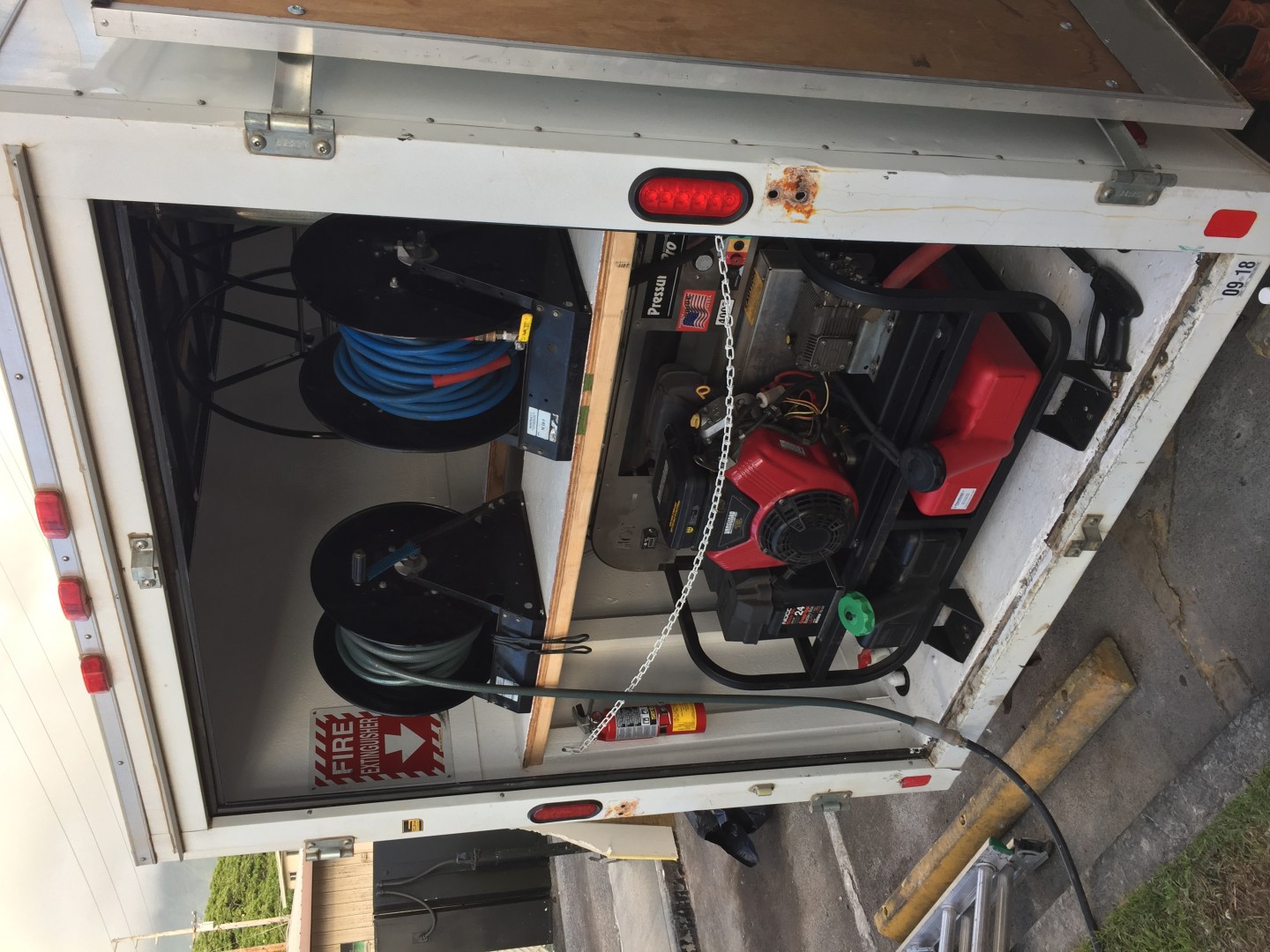

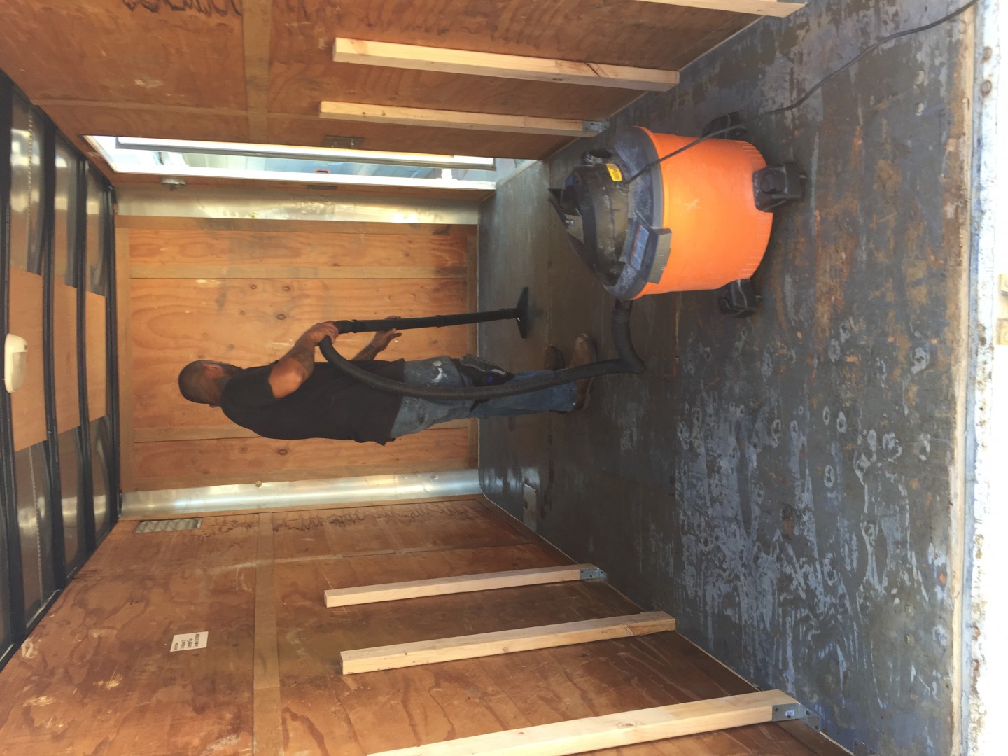

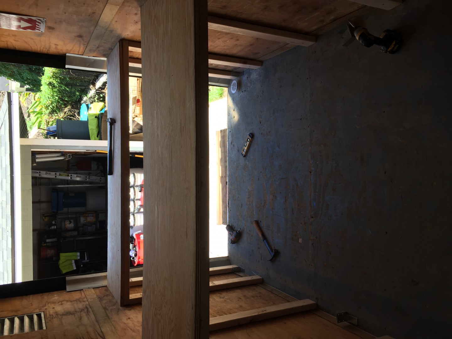

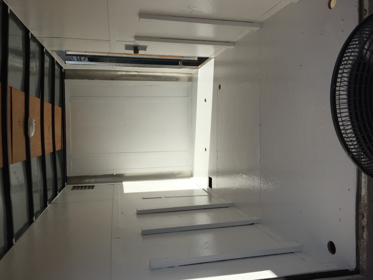

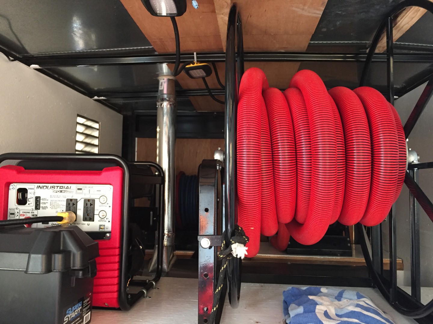

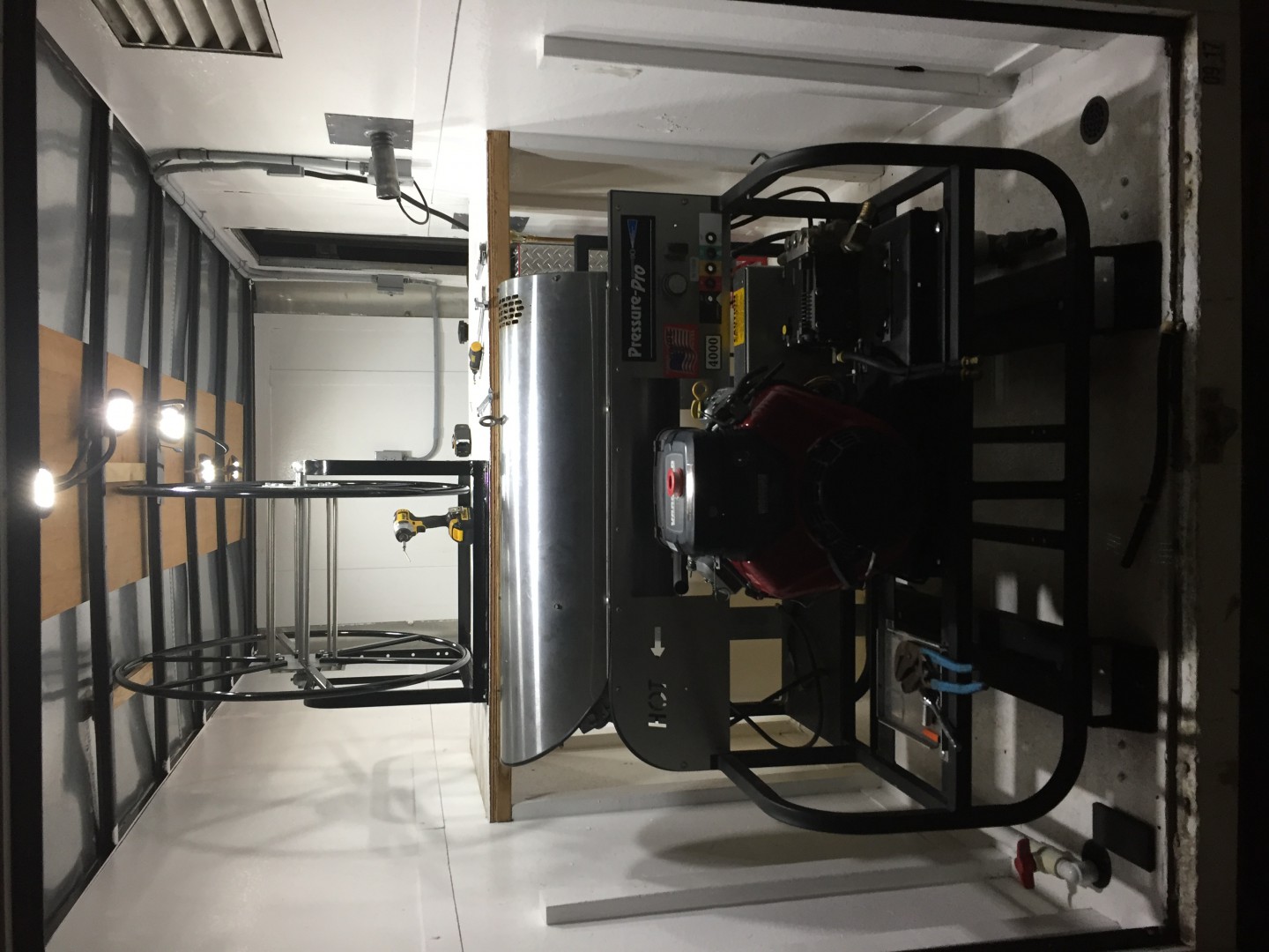

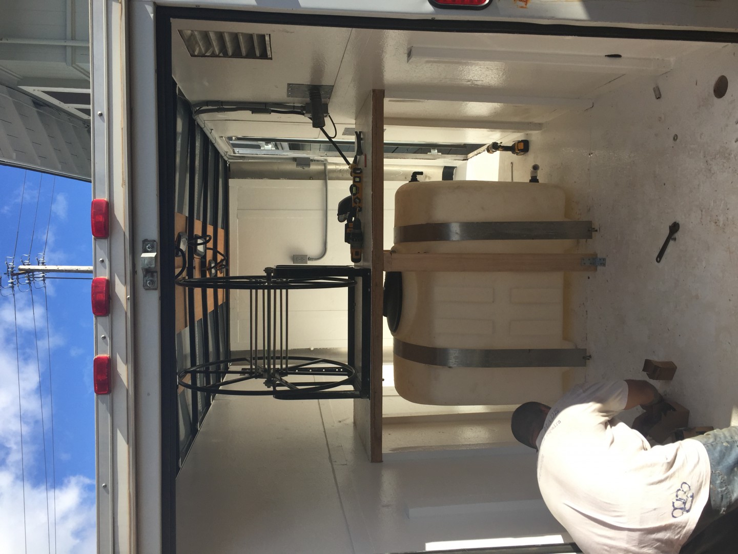

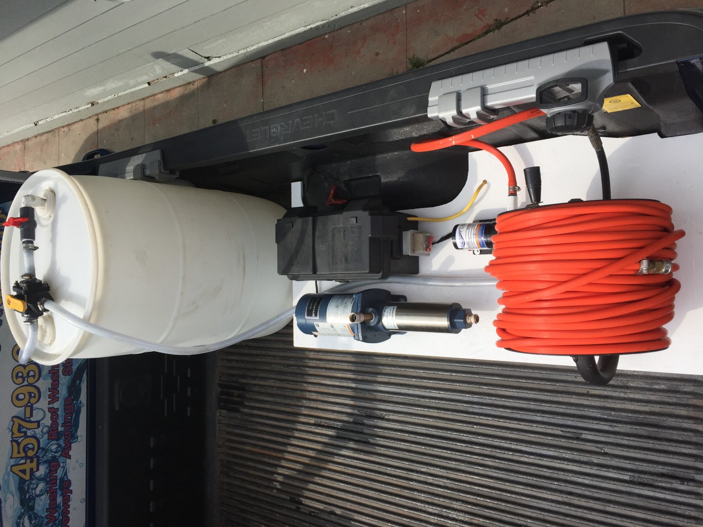

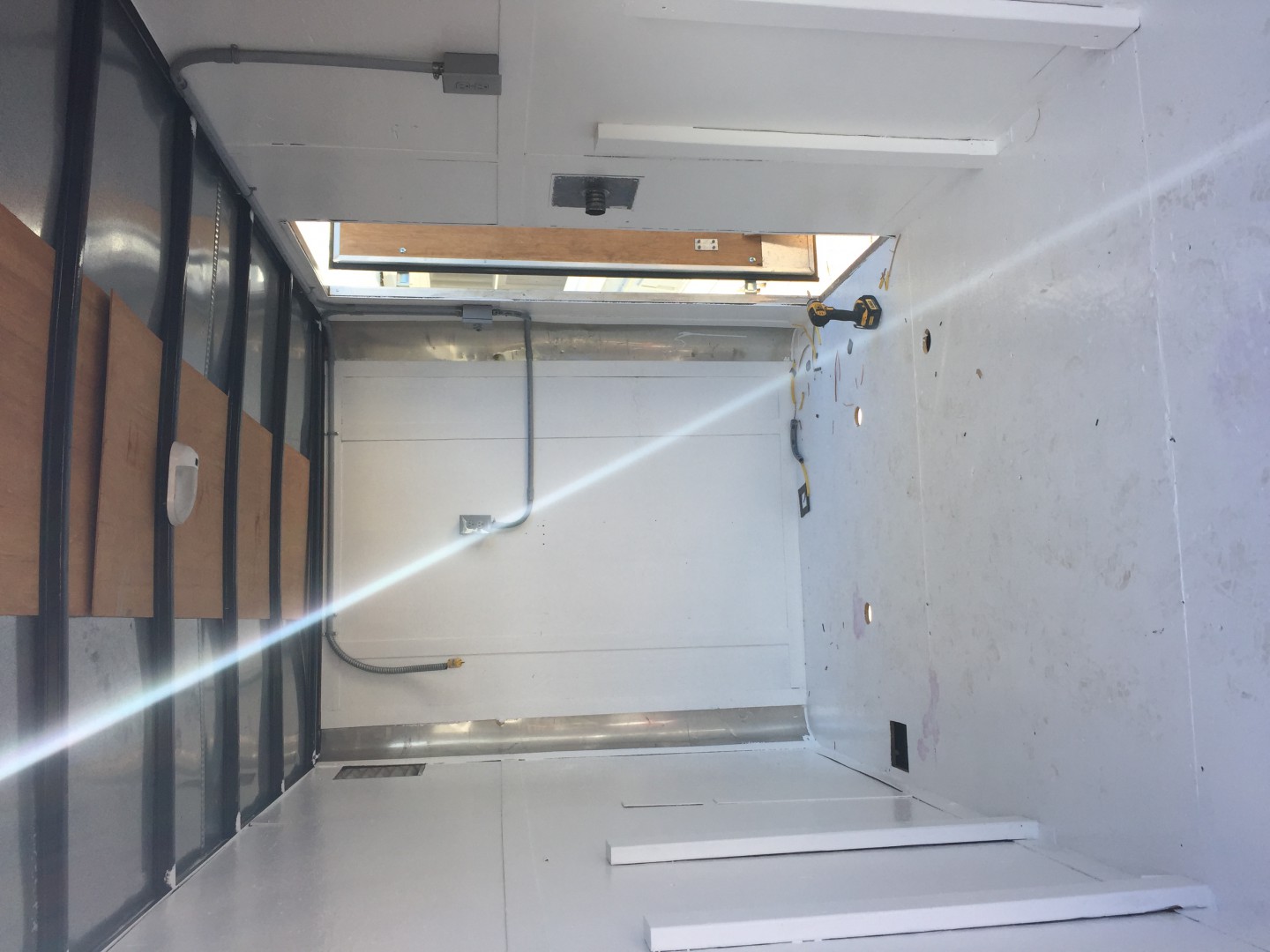

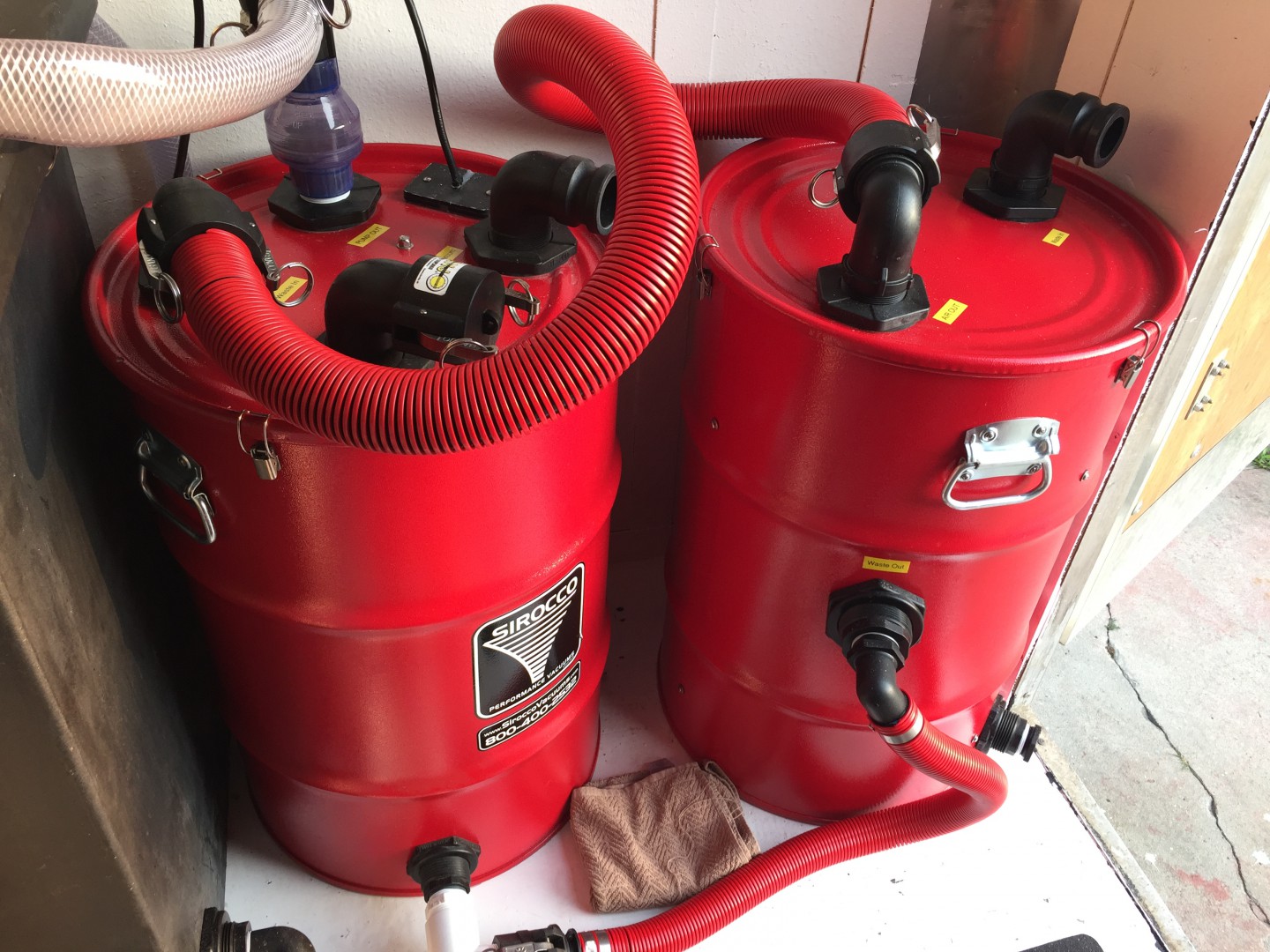

Aloha guys, been working on our new build for Monday. This is a full sirroco system that recovers and reuses the water. We have a horizontal hotbox and 5.5 gpm pressure washer. Our Softwash system is mounted on our truck along with the booster pump.

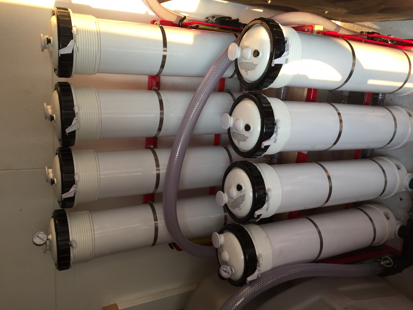

Friggin awesome setup! Those 8 tanks are all water purification for window cleaning only? or thats the Sirocco reclaim filteration for discarging safely? We run a 4 unit RO/DI, for WFP

The 8 white tanks are to bring the water to a proper ratio to actually reuse it in my 250 gallon tanks. This system allows me to recover and reuse the dirty water at bus stops, parking garages and restaurants. Jerry at Sirroco gave me a lot of help in choosing which system works best for our clients over here.

This should do well for you Chris. Make sure you blow off the work area well first. The surface cleaner clogs where the hoses hook up on the top with grass debris and animal hair real easy. We learned to disconnect the hoses and clean it out with the pressure washer.
