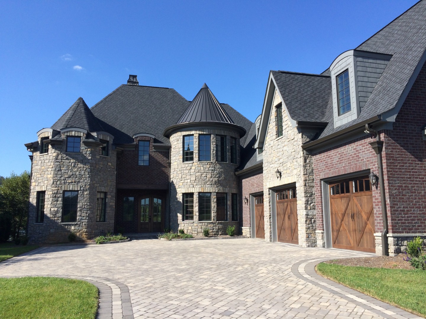

I've got a house wash coming up that is a pretty new house. No algae, just spider webs, dust, bird droppings, etc. I don't see the need to use bleach, especially since they have lots of stained wood around. Wondering how others might clean this? And if I'm thinking right about not needing SH.
Bleach helps eat up the spider webs and can kill them....The wood is the issue but with the ProPortioner you have the ability to turn it off. I'd personally hit the areas with wood as just soap and water then all other areas at 1%.
You could do the whole job with just soap and water. The soap will help pull down the webs but not as well and won't kill the spiders.....so the problem comes back quicker.

Always good to use some S/H. Your going to need it to clean the trim and soffits anyway. Keep all your wood wet and rinse a lot

i wash lots of nawhomes for builder. Use very minimal SH, if any at all, but extra SOAP. The soaps help to give weight to the spider webs for them to rinse down easier.

I would hit it with like .5 Sh with a good soap. Like it was said above it'll help break up some of the webs.
Oct 9, 2017
It's done. I started with .5%, but had to go 1% because of the spider webs.
