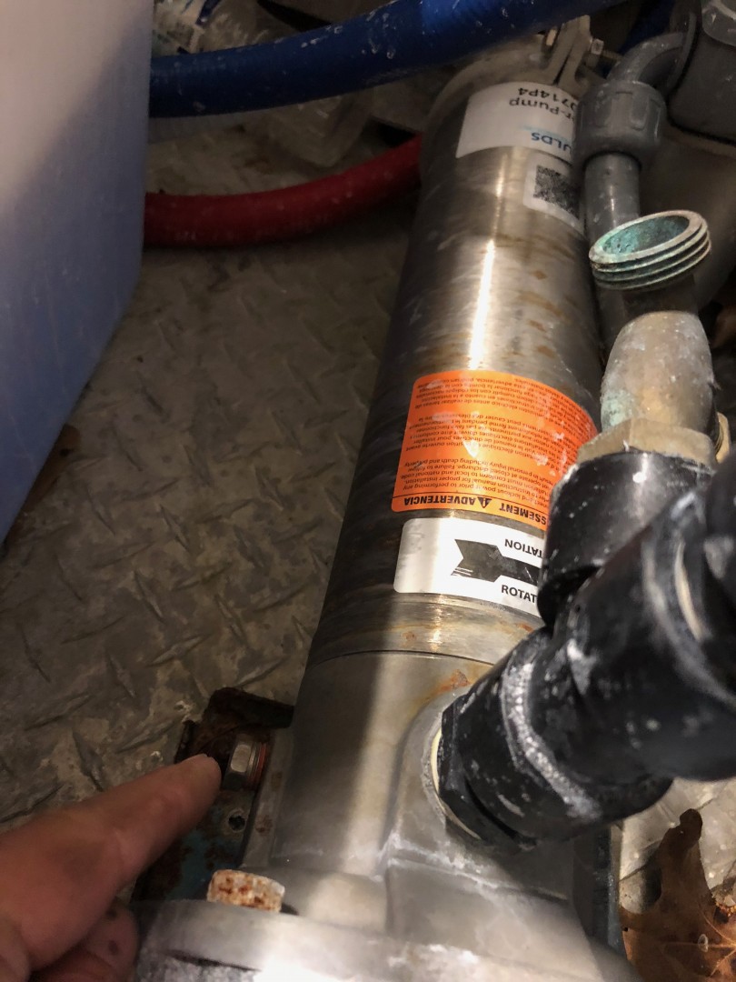

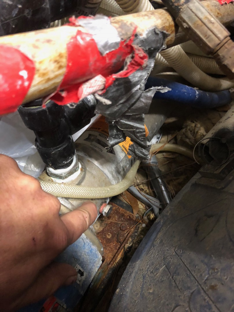

Early spring I think there was a small amount of ice in the booster. That week the impellers got destroyed. Just looking at it I would think water lays in the bottom no matter what so I spent a few bucks for heat tape.
The pumps can save a lot of time which equates to money in the bank for those who use them. Like any piece of equipment it needs some attention.

Don't knock it till you try it Art! Just a little a insurance cost me $25.00 and took 10 minutes to wrap. Now that it's there I will leave it until I know we are out of freezing weather.

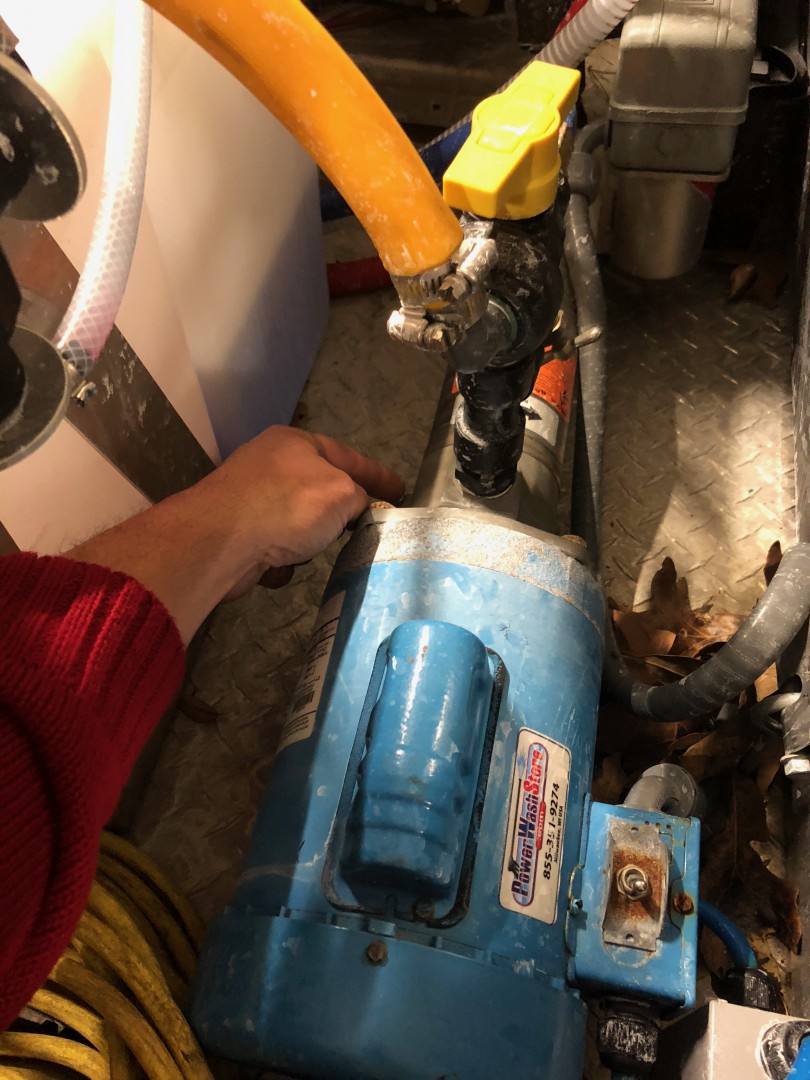

I pumped antifreeze into mine once this year. I contacted the vendor that sold me the pump and asked for any tips on winterizing... they said they werent sure if antifreeze would be the best for the internals, but I'm not sure what they were basing that on... like if there was a reason for that answer, or if they just thought it didnt sound like a good idea. Their suggestion was to bring it indoors.
Going through another cold snap right now... didnt have time to mess with the antifreeze, so i just put 4mil visqueen over the trailer and put a space heater under. Keeps my PW and reels warm also.

I used a 12 volt pump to force RV antifreeze through the booster pump and the entire hose reel, worker really well, as you know the pump wont just draw antifreeze from a tank.
Hmmm... I didnt notice a problem when i did it. I'm using the Goulds 1HP. I had a bucket full of RV antifreeze (may have had a little water in it... cant remember), and it sucked it through the pump like normal.

you should be, if its primed.
Jan 3, 2018
don't know if this helps, but the Gould's boosters have 1/4 inch ports on the side. You could use this to introduce Antifreeze into the stack.
