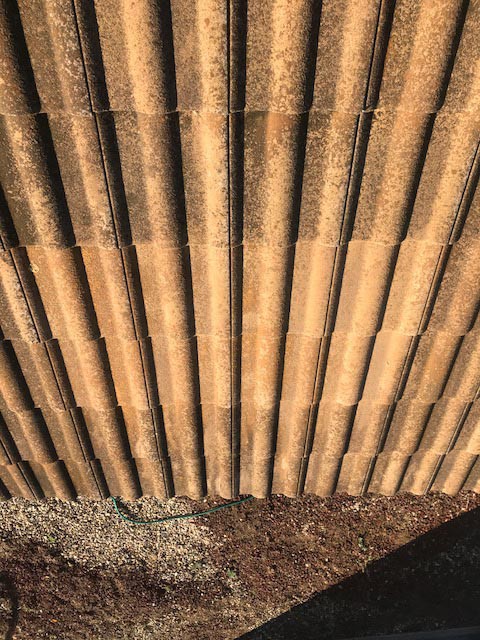

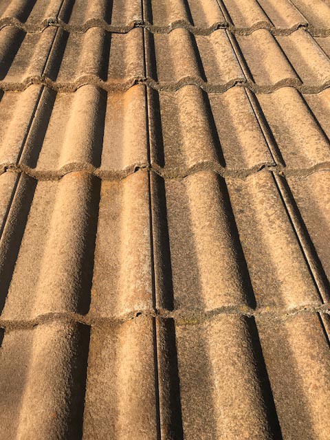

This is what I did as a learning curve on my brothers concrete roof:
1:2 mixture (1part 12.5% SH, 2 parts H20), added about 3 oz of 'citrus boost' from PWS. The black molde / mildew was dissolved. The algae/moss was lightened but the green--turned brown- material remained. The first area I rinsed with water about 15-20 min after application. The second area I left on overnight.
Both areas looked considerably cleaner from afar but up close the concrete tiles did not look smooth. The texture of moss material remained. Is this typical for a concrete roof? I attached a couple pics.
In my experience, your mix isn't strong enough for concrete tile. Moss will almost always remain, but if you've killed it, will come off with the rain.

No less than 50% with extra surfactant.

Yes It seems the concrete is extremely porous and the moss has it's roots in deep. My other concern is the smell. The "Citrus" from PWS didn't do a sufficient enough job masking. I will search and order more options. I'm looking at the "Rain Fresh" from Soft Wash Systems. That along with a 'green' wash might be the combo to combat this tough moss on concrete. Do you guys find the "Agent Green" or "Green Wash" improves the efficacy of the soft wash mix? i.e. increases it's potency?

Welcome aboard. Are there gutters on the house? If so just leave the roof mix on the roof after applying a 50/50 mix. Check to see where the gutter system daylights to avoid possible plant material damage. With concrete you might need a second application to some areas. I've never used any surfactants from the industry vendors. I live in the Stone Age and still use dawn for all our work.

Thanks for the welcomes and info guys! Hank I'll increase my concoction and do a solid second coat.
