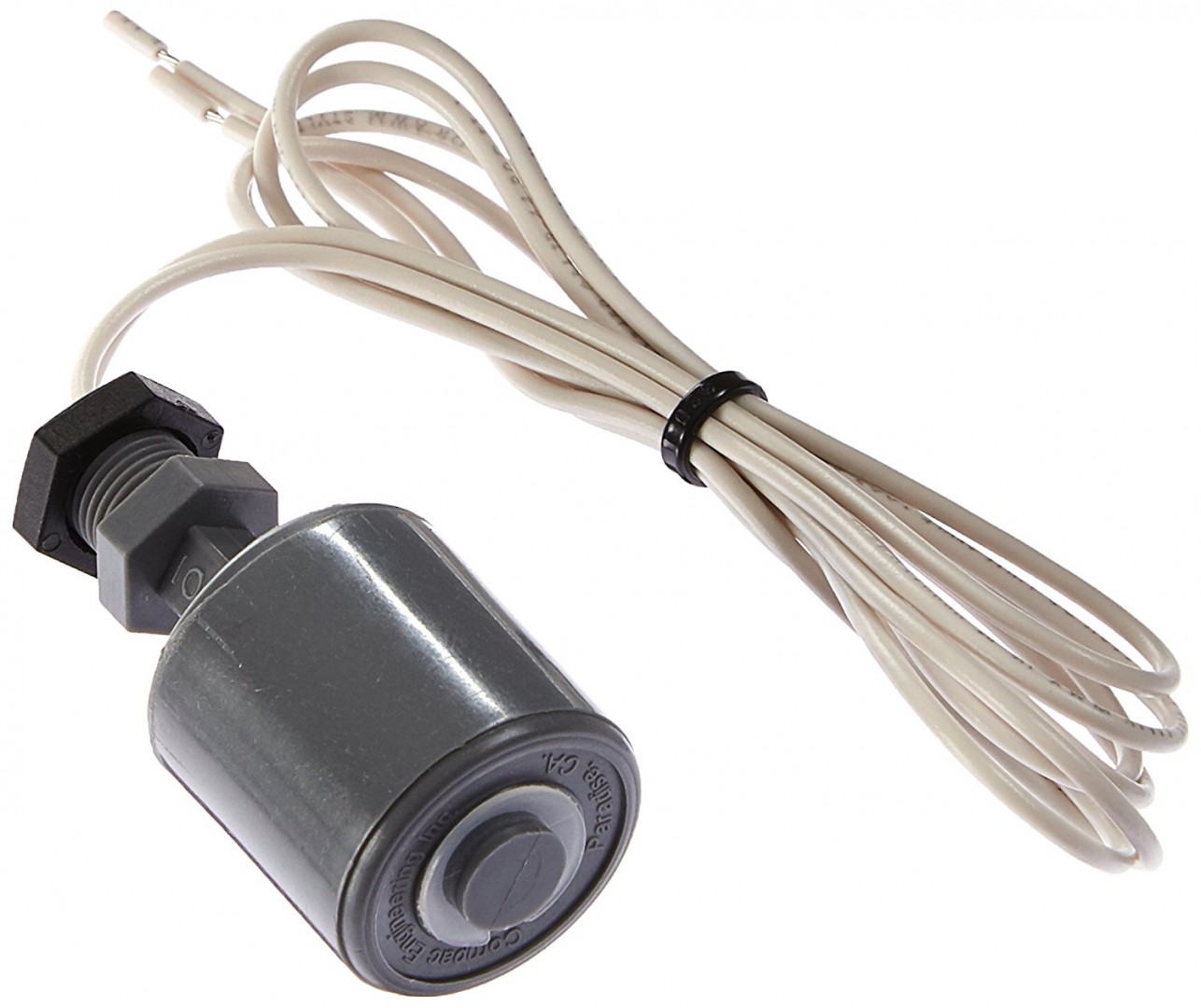

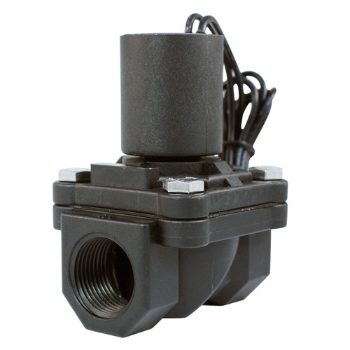

You bet, I'm waiting till they open on Monday to call and put my order through. Eric and Lisa may have a little insight on this.
I am removing the Hudson float valve to add about 8 - 10 inches of water in the buffer tank.
Two simple parts.
Float switch $17.00
Valve $32.95
