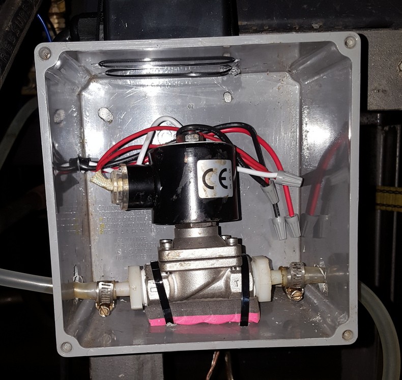

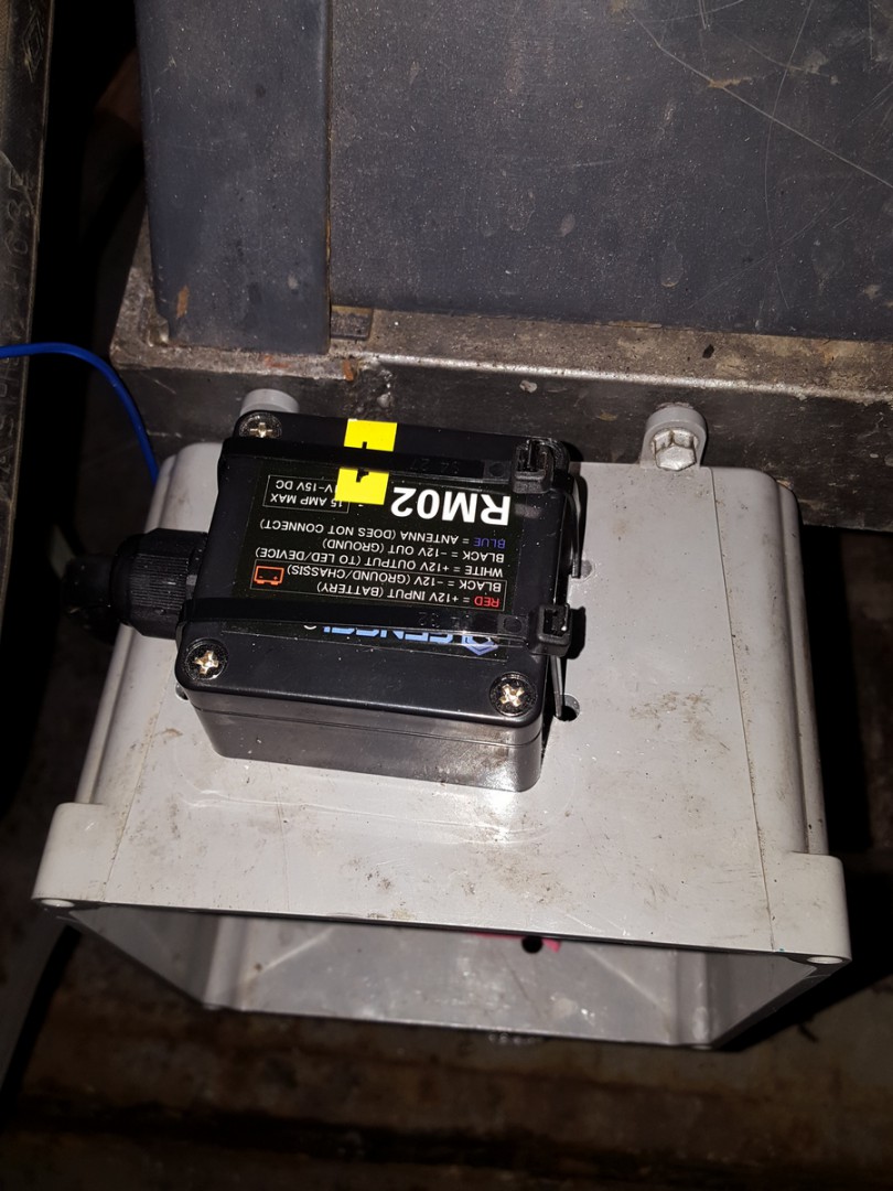

A new remote for down streaming with a waterproof sealed remote switch and the 1/2" solenoid valves. I installed to the exterior for ease of maintenance of both the valve and switch. I didn't want a bigger box so this should work.

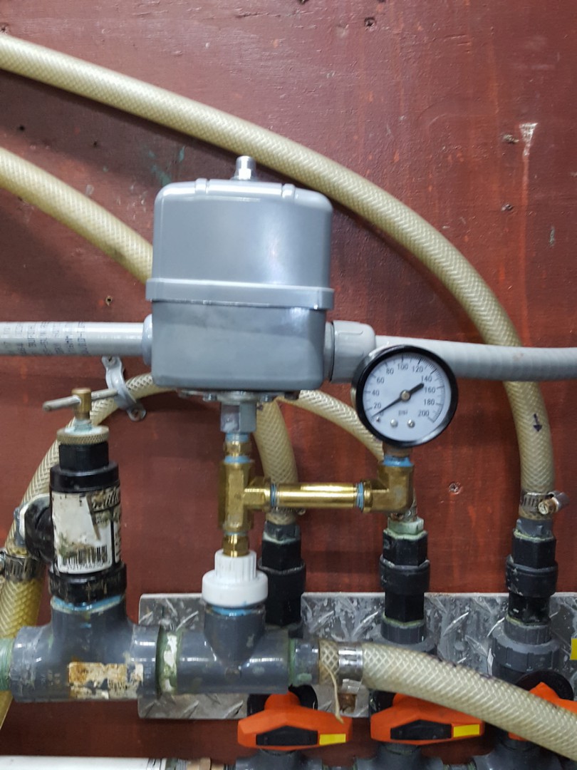

The booster got an isolator and a pressure switch. Due to the weather I am not able to test it yet.

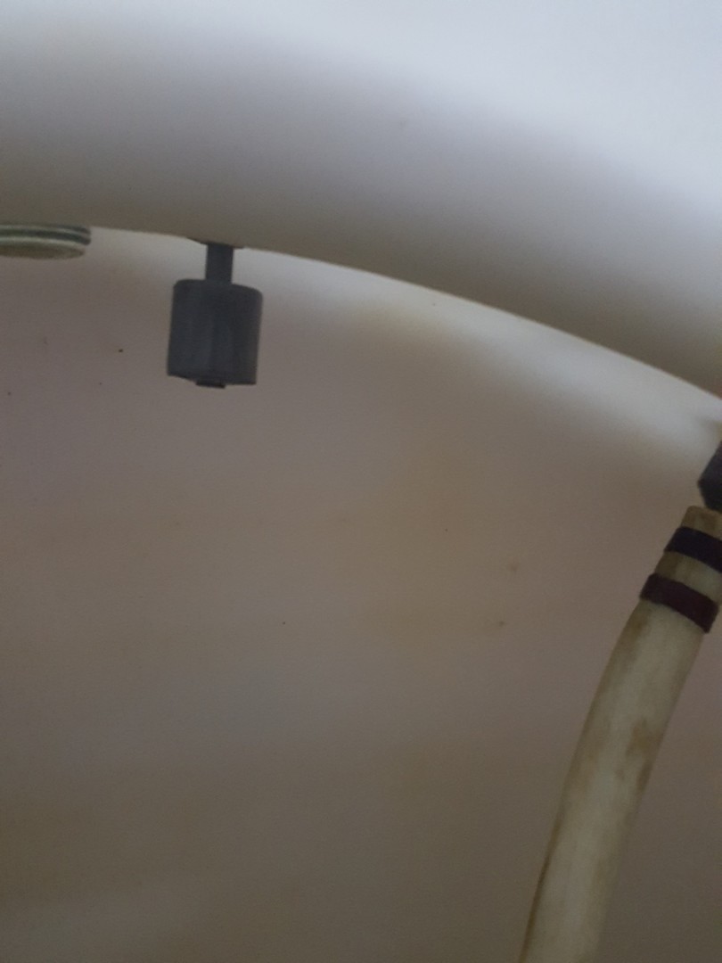

More to come while I finish the 12V valve and switch for the buffer tank.

The new float switch and 12V valve got to get a test yesterday and worked well. Now the tank gets about 6 - 8 inches more water.
I think that is the same type of float switch I have in the tank now. In the previous tank I had a Hudson, very similar to what is in the toilet tank.
