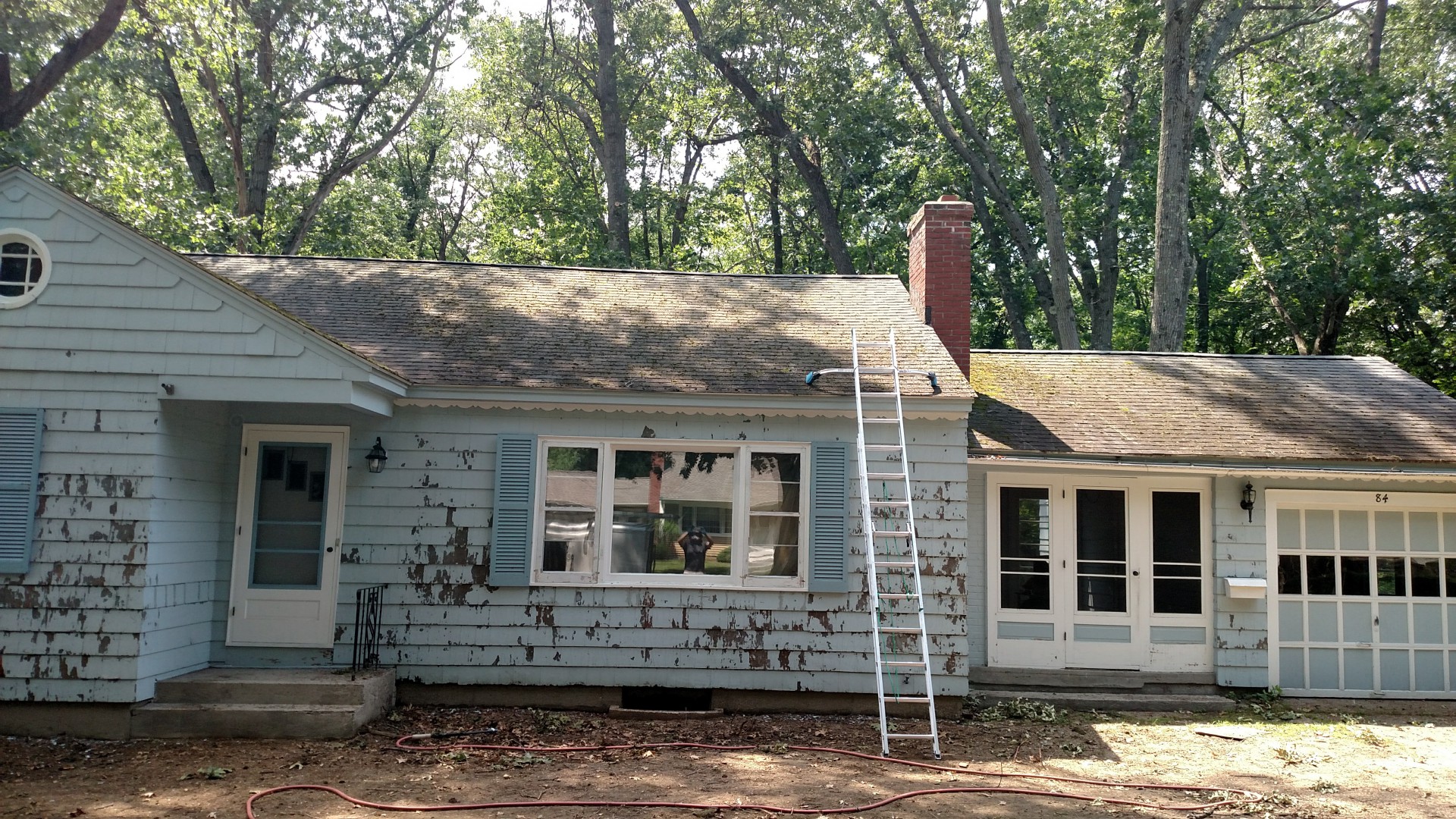

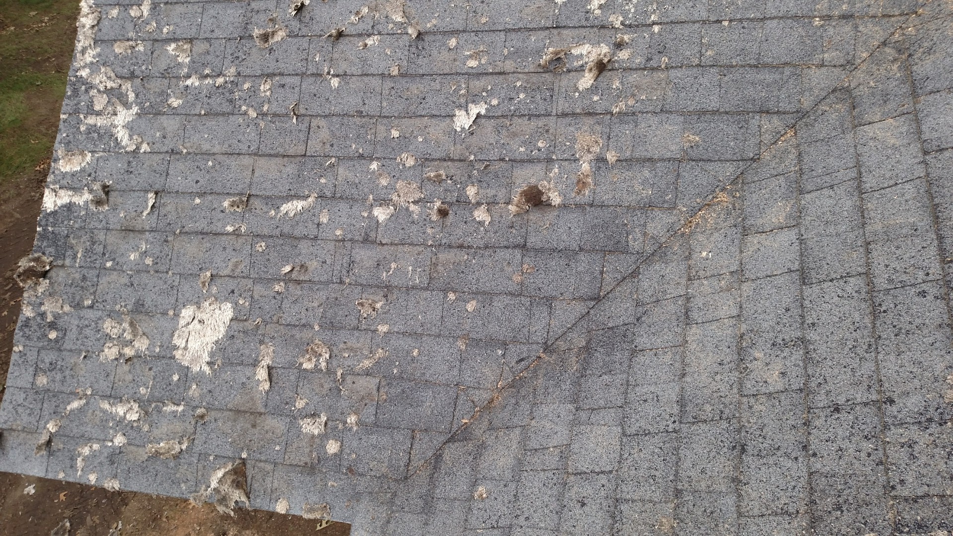

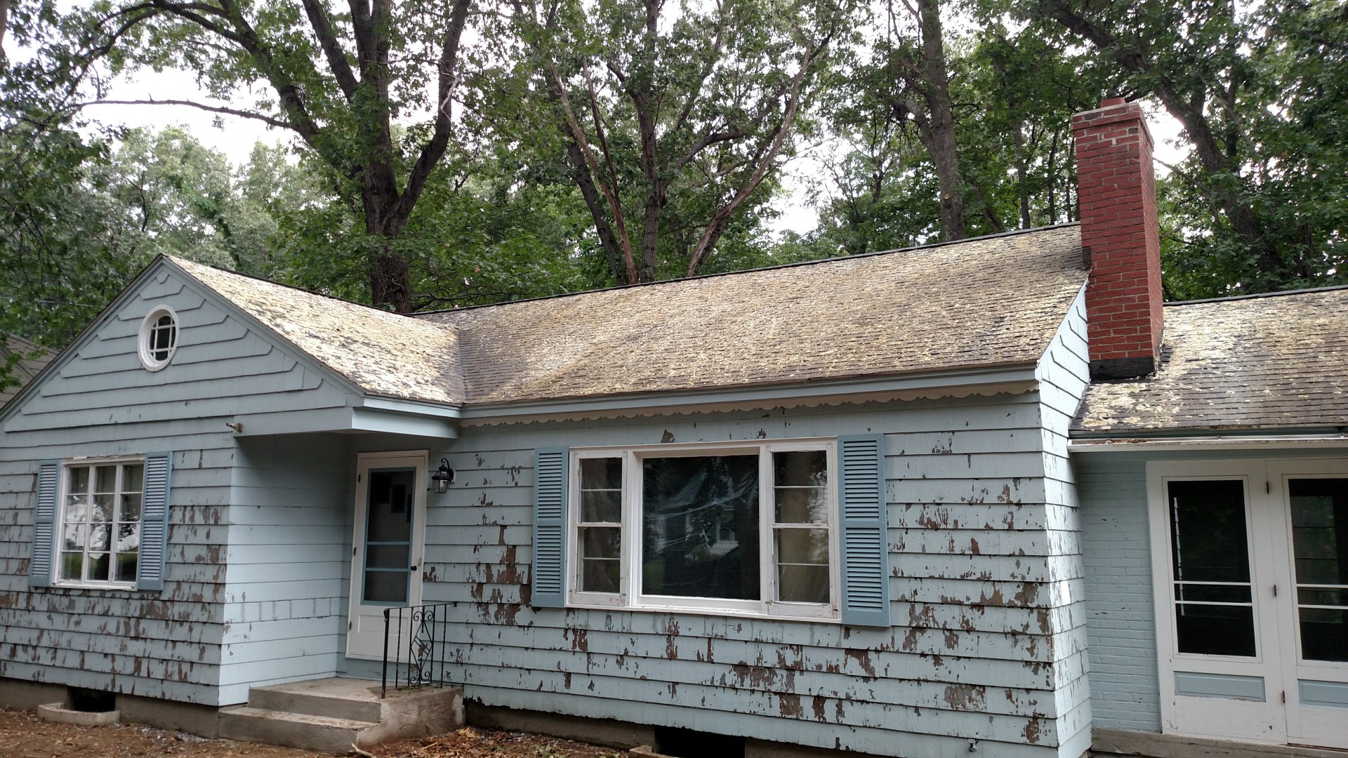

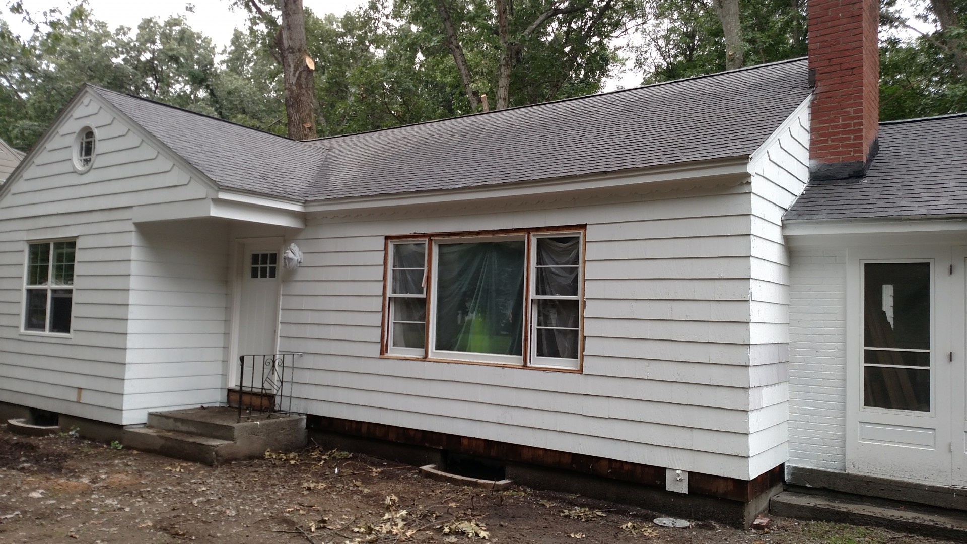

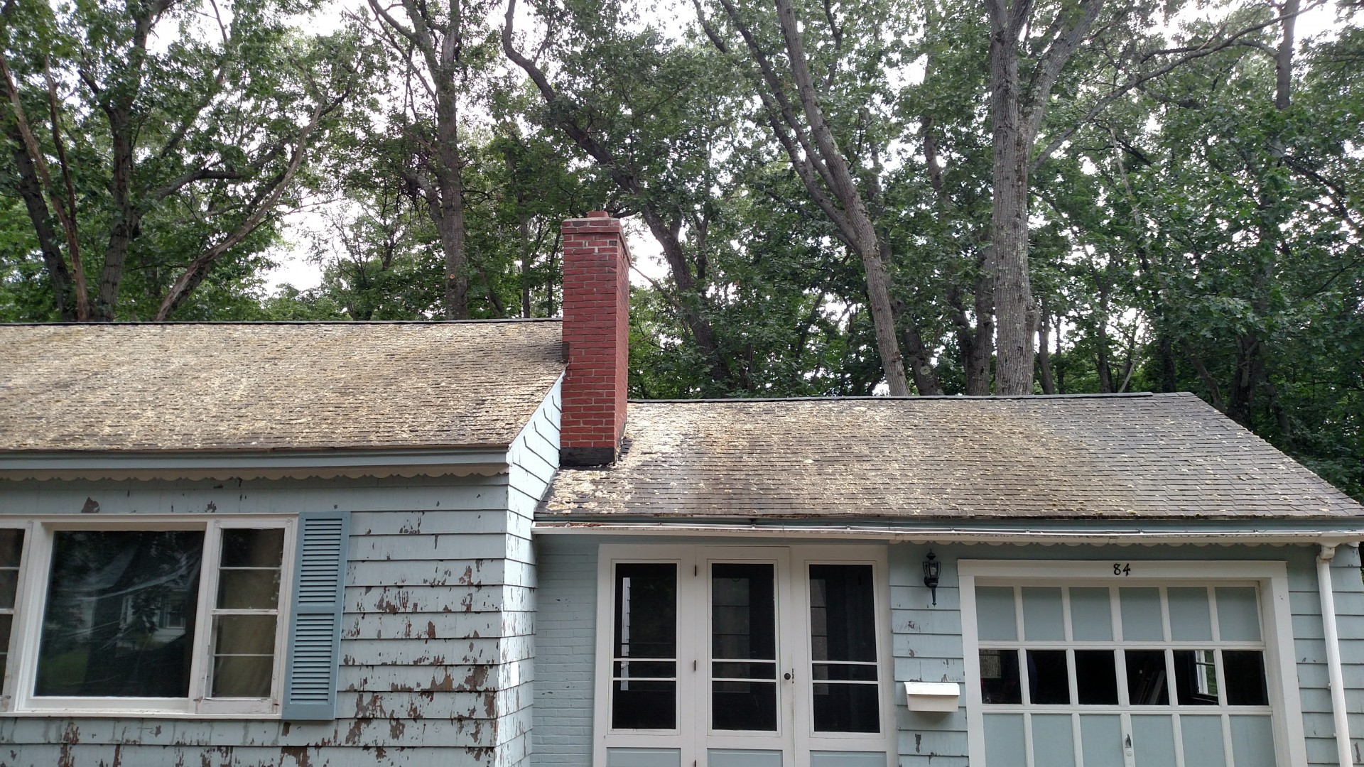

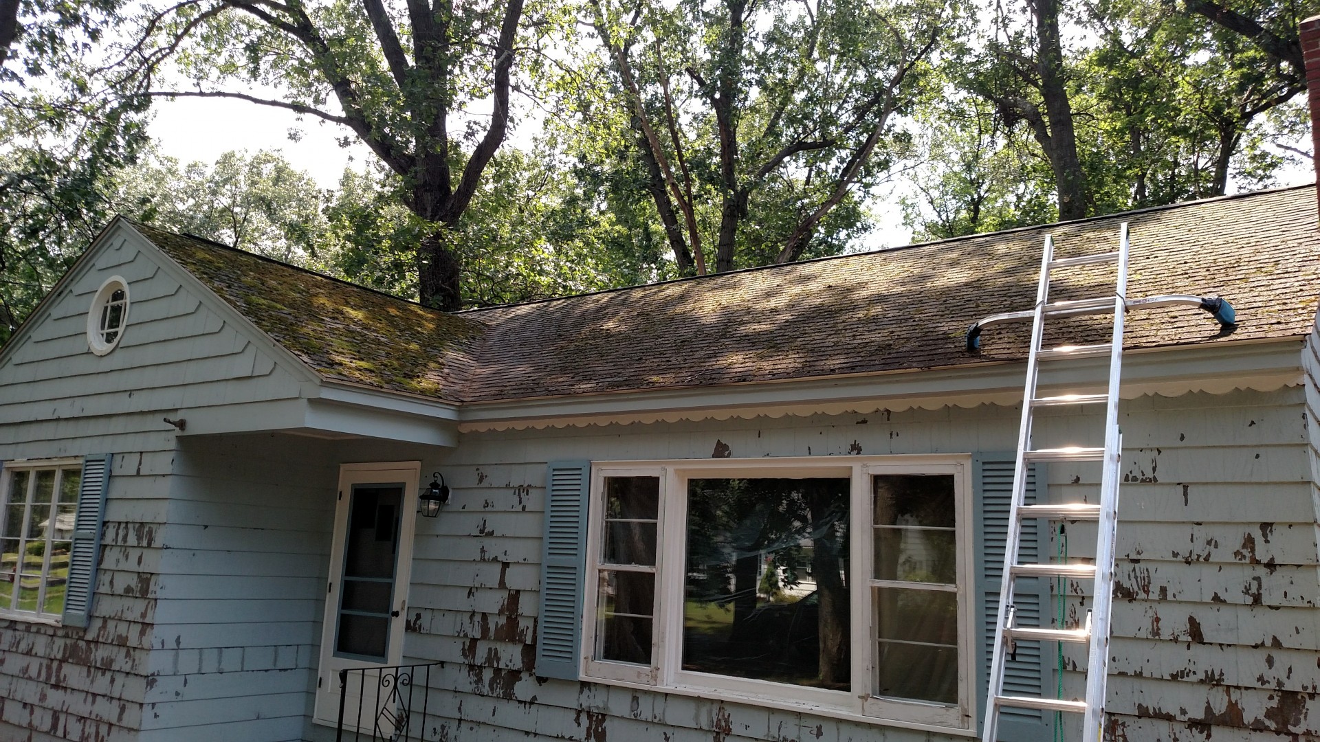

I got a call this summer from a guy who was buying a foreclosed home and the roof was in rough shape. Normally when I have mossy roof, I spend the time to do a rinse for more of an instant result. I have tried in the past to spray and wait, but I got impatient and I believe the customers did as well. I decided on this one that I would try to spray and come back in 2 months to see how it was looking with hopes that a good portion of it rinsed away with the rain. Knowing that we had at least 4-5 good rain storms during the two months, I returned to see that most of the dead moss did come off, but there was still a good amount on the roof. I ended up spending about 3 hours rinsing the remaining portion off (front and back of roof). I did get $1000 for the job, but I would love to get to the point of being able to apply my solution and move to the next.
All sorts of different approaches (and opinions). It's all in how you sell the job. I tell them that it will take 2 to 6 months for the lichen and moss to fall off (this is in writing). I'm not having the crew sit there for hours rinsing moss and I think it can even lead to damage (if it's lichen). Either that or bid those jobs high enough that it all works out financially.
