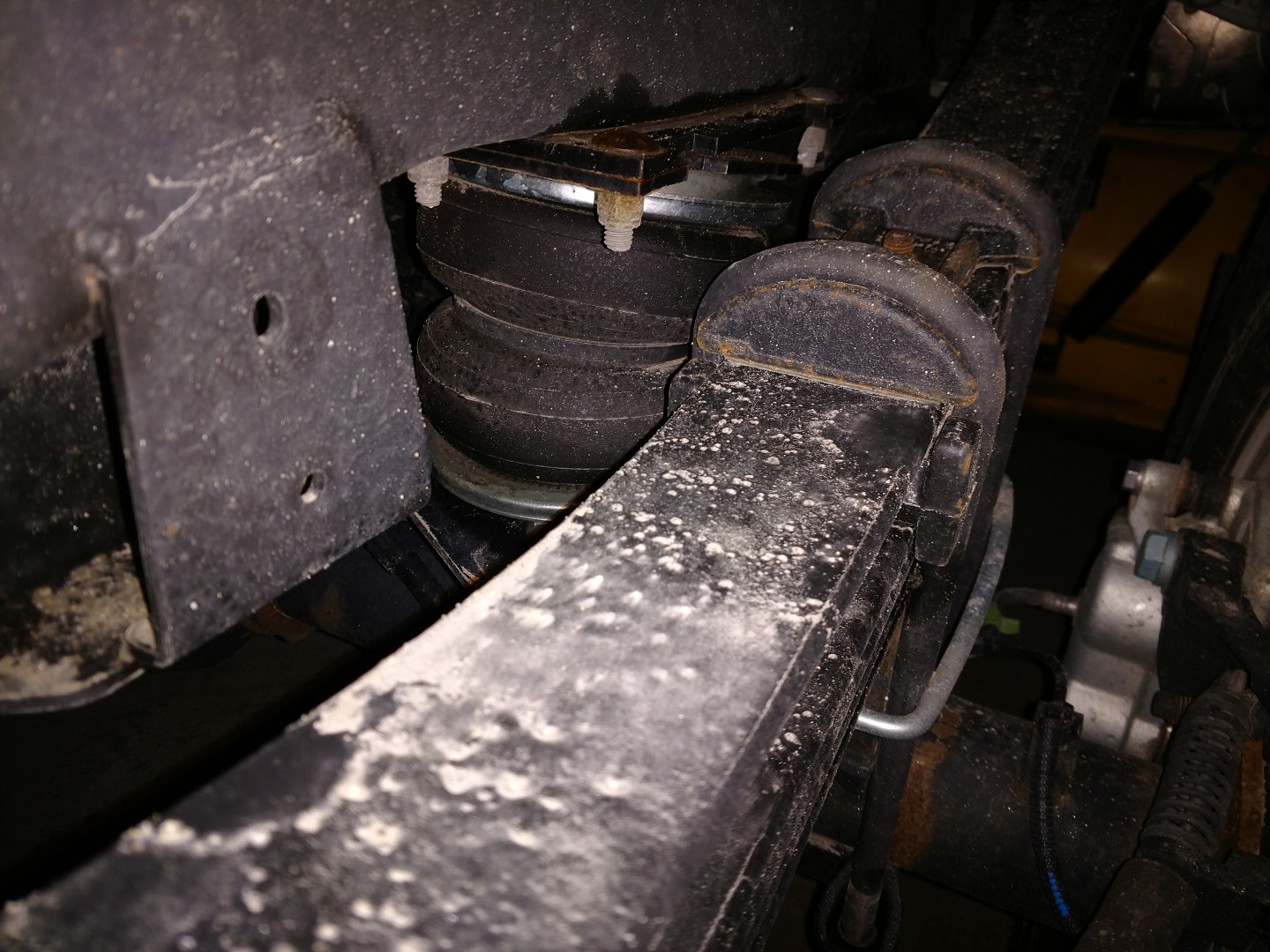

I chose to install Airbags instead of an additional leaf spring to help out the suspension on our new truck. We did buy the f350 and it does hold our new skid with out any sign of the suspension sagging. What we found out is that the skid is heavier on the hose reel side (Passenger side) which made the truck lean to one side. And once we loaded the truck up with water ( 200 gallon) bleach 2-(55 gallon) House Soap(7 gallon) Roof Soap(7gallon) Gas Tank (11 gallon) Hot water heater ( 8 gallons diesel) Ladders all the accessories in the tool box. We could see the truck needed a little help. Airbags was an easy install and was half the cost of of an additional leave spring and one of the things that is easy is adjusting each side of the truck to keep it level and not leaning to one side.

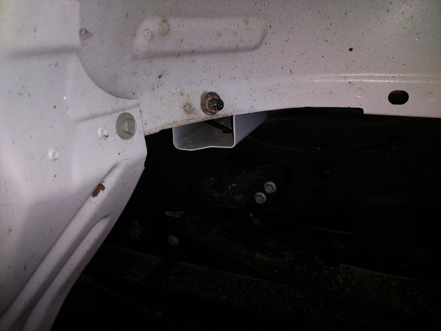

The last picture shows we're the fitting is to put air in the air bag. You can actually use a bicycle pump because it does take much air to inflate the bag. I used my compressor.
Driver's side has 7lbs of Air
Passenger side 11 lbs of Air
I just use a tape measure to take a reading off the suspension to frame and compared it side to side .

Every situation is different. And if I was just adding weight and it was staying in the truck 24/7 365 I would have done spring's. But we're the skid was heavier on one side the air bags was the best install. And were the skid comes out in the winter we can just let some air out of the air bags to readjust the suspension
