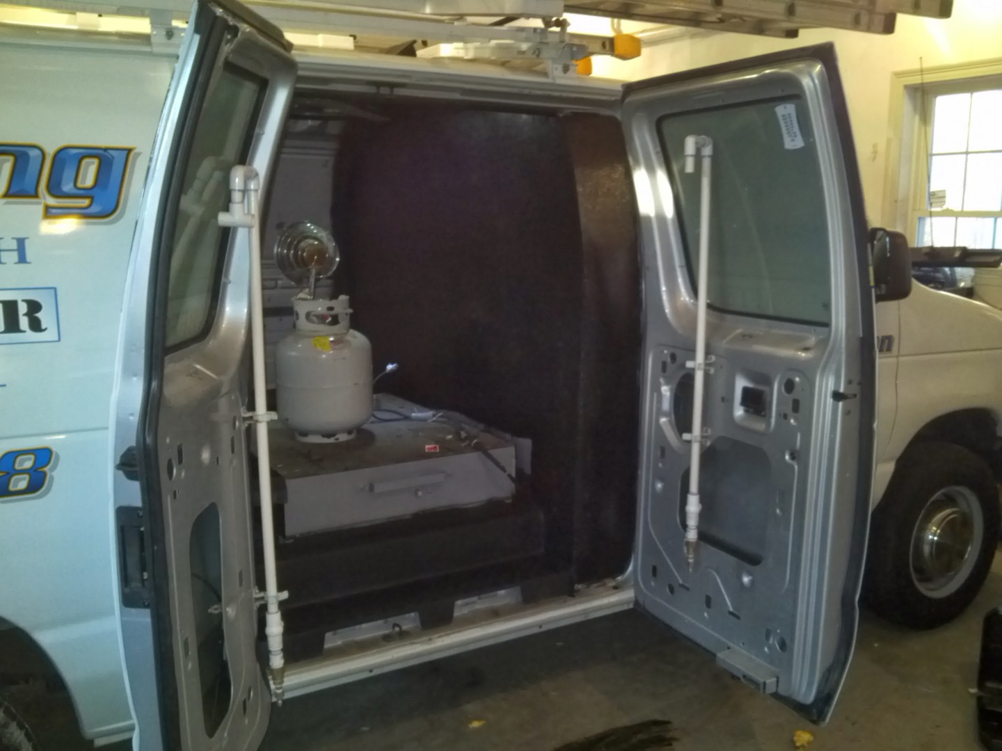

No.. I put a roof vent on top and drilled vents on the bottom of the van. Kind of like the vents on an enclosed landscaping trailer so the gasoline fumes from the mowers can get out and I also put a 12 volt fan on the roof wired to a switch so it could run.
But I would also vent the tanks down through the floor also. I will try to find a few pictures

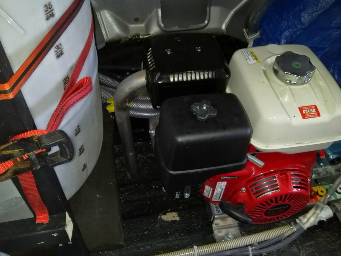

Also have the exhaust of the PW vented through the floor.

I exhausted the PW and compressor through the floor
This is a pic of exhaust the PW through the floor

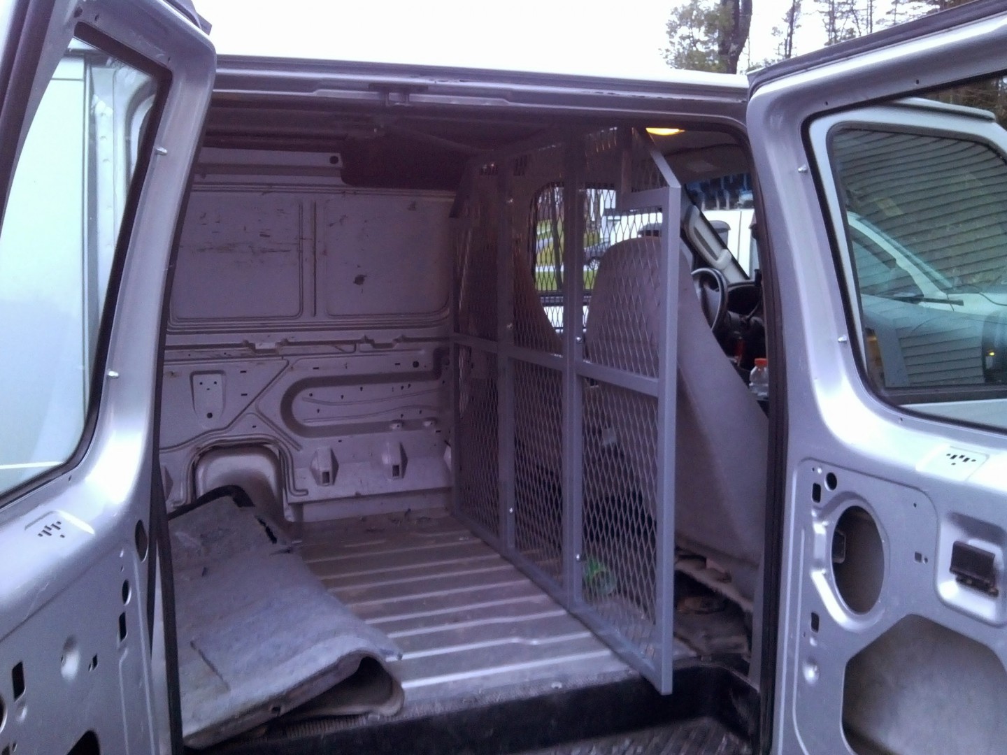

I bought the cage and installed it
