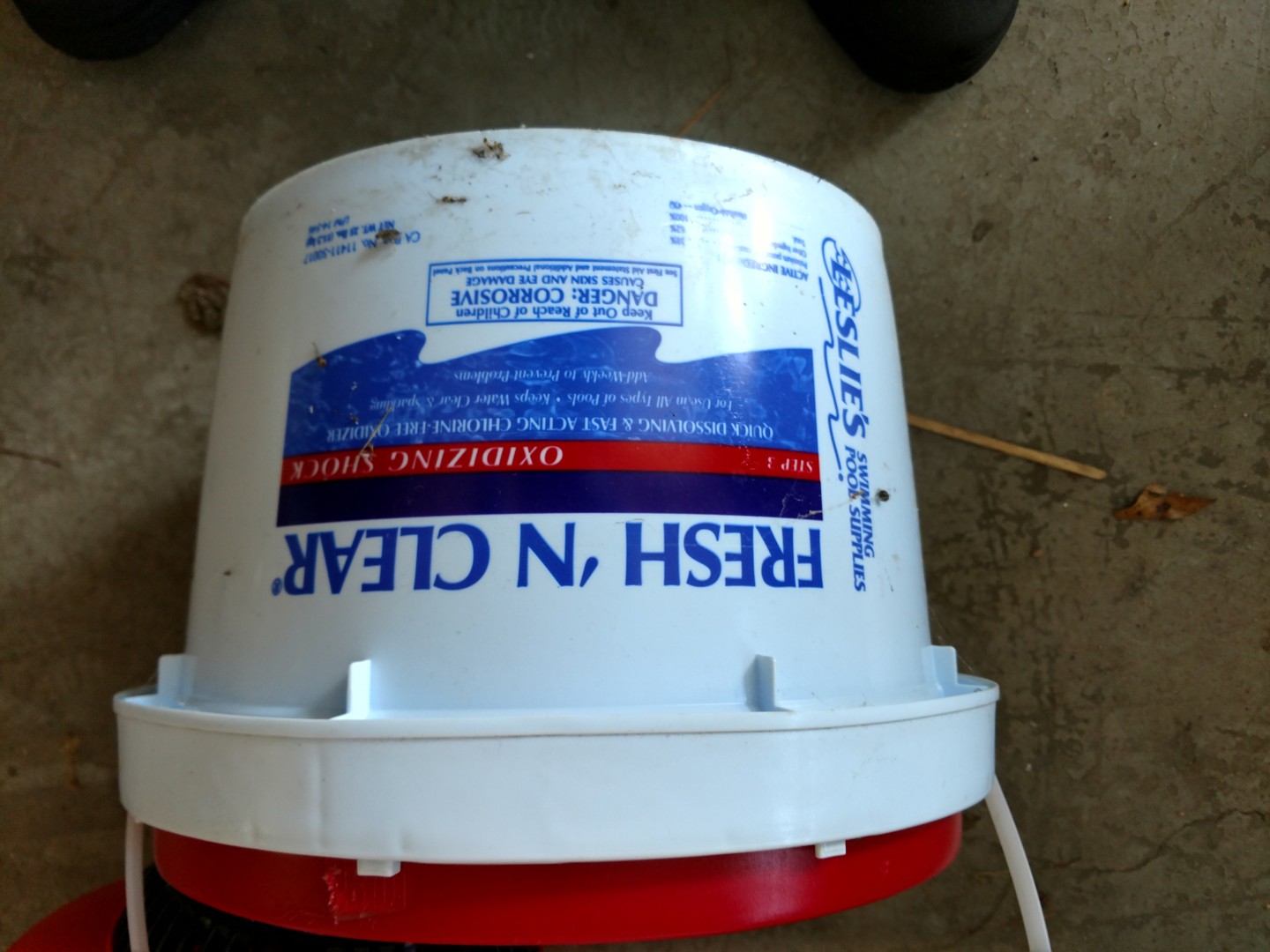

How many guys use a chlorine enhancer. I now know alot of guys are mixing certain enhancer's in with there soap. I have never mixed and enhancer in when I batched mixed because I was rumored to kill your mix quickly. I actually bought a bucket of Fresh n Clear a fee years ago to try to boost the mixes early on in the year and later in the year but I never ever used it. Now that I have the Proportioner I'm thinking about putting and enhacer in my roof soap.

But what more effective/Faster/cost less.. mixing The Fresh n Clear into my roof soap and just mix it at the proportioner? Or using the cost of Diesel to heat up 200 gallons of water.
