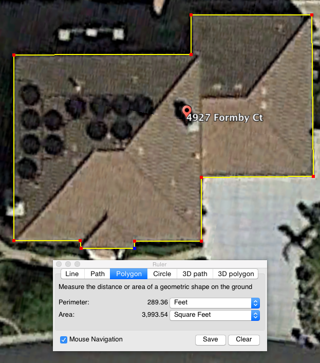

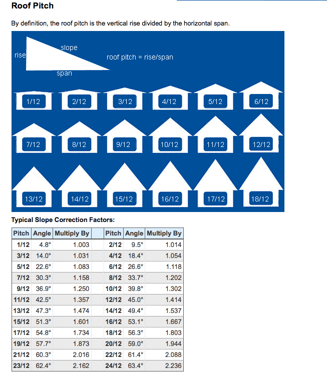

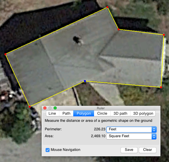

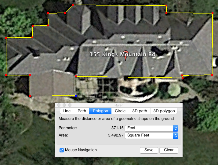

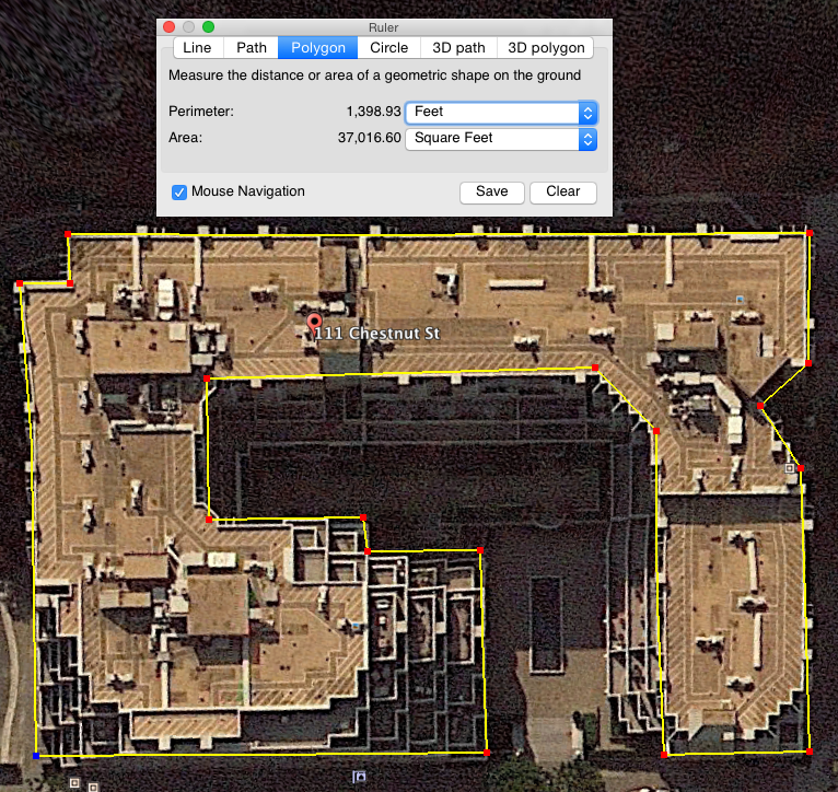

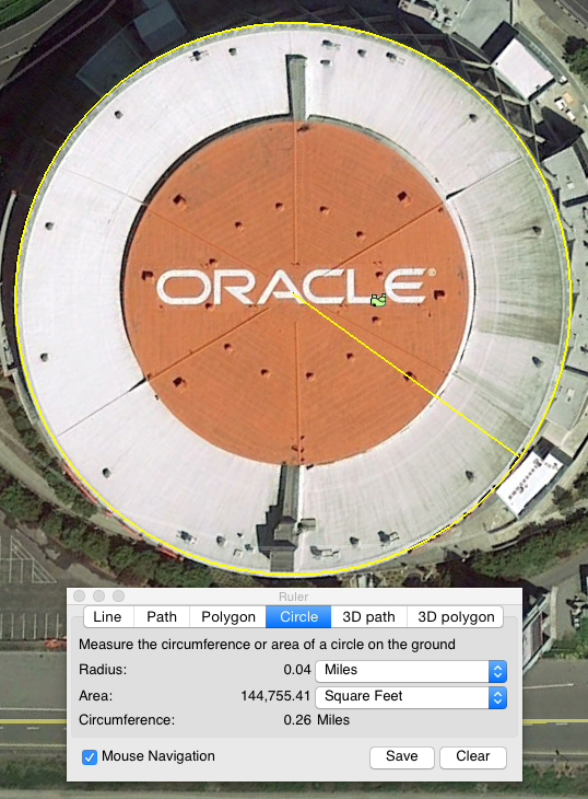

I do the same as Brett, have for a few years now. Yes, the ability to go back and get photos from the past is great for finding the best image for clarity, find a winter photo and you can see through tree coverage. I also use it at times to find out how old a roof is or when an addition was done or if they have gutters. Measuring the house and taking a screenshot is the first thing I do for jobs. With street view, you can see the pitch so I just multiply accordingly. Attached are some examples. I name the job after the street its on and put the actual square footage after the street name. I always send the screenshot along with my proposal.
I use another cool trick for measuring building exteriors (mainly for large commercial projects). Click on the '3d Buildings' feature (bottom left) and at the bottom right of the screen, it shows the elevation at the point of your cursor. You can get the height of the structure with this feature. Multiply the lineal feet of the building by its height and you have the square footage of the exterior. It's not perfect but it is very close. It also impresses customers. An example of this is the Lombard image. I actually have a lot of fun with it.
One thing we do differently Eric is I measure each segment of the roof and add them together. The square footage is close enough without guessing on pitch.
We have been talking about changes this year and one is to either send the satellite view or the street view. I need to play with the #D part of this. Thanks!

If I measure each section, the measuring tool sees it as one flat surface. No need to be concerned with pitch. I add them all together and get a pretty close total of the roof surface.

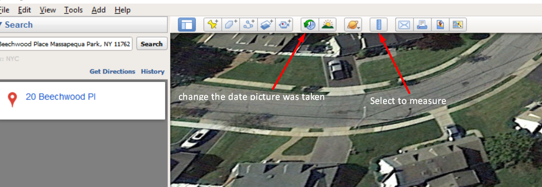

Download Google Earth Pro and you can measure all the segments of the roof or anything else you can easily see.
The first picture are the two tools I use the most.

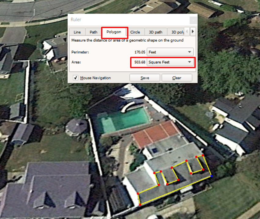

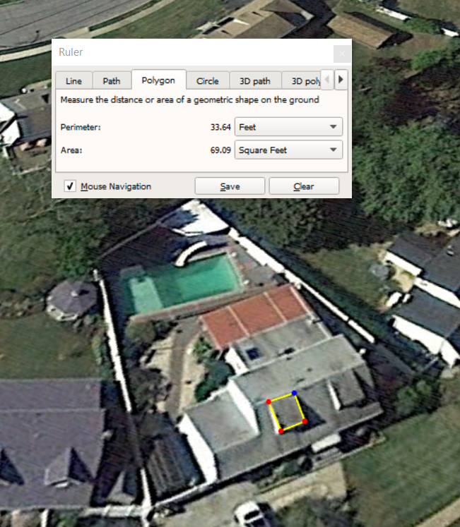

Second picture, after selecting the measuring tool select polygon, now you can select the are to measure.
Third showing the measurement of the dormer.

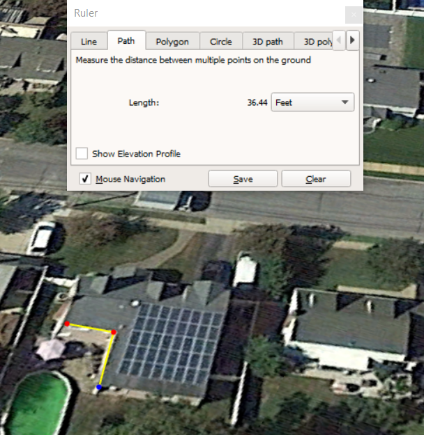

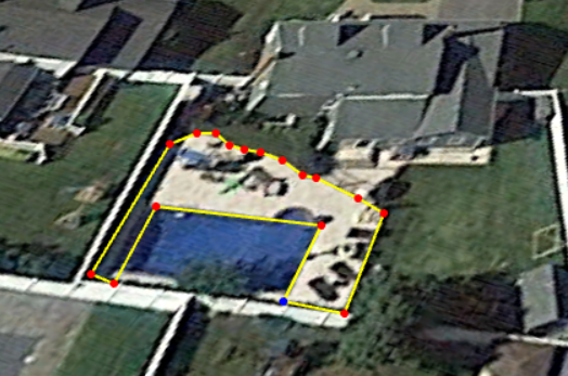

Fourth and fifth showing other things it helps with. Concrete and gutters.
In picture five I choose path to measure those two as one length to measure the gutter.

Brett, just wondering why you measure each facet individually?
