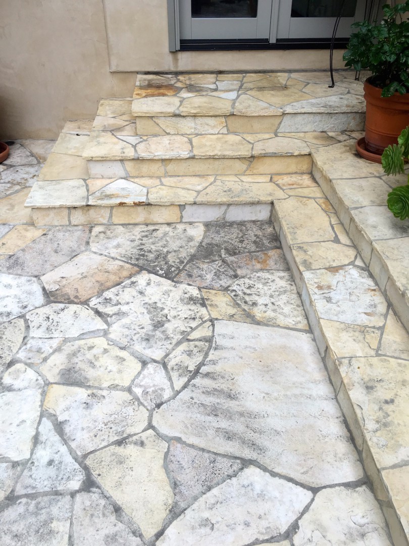

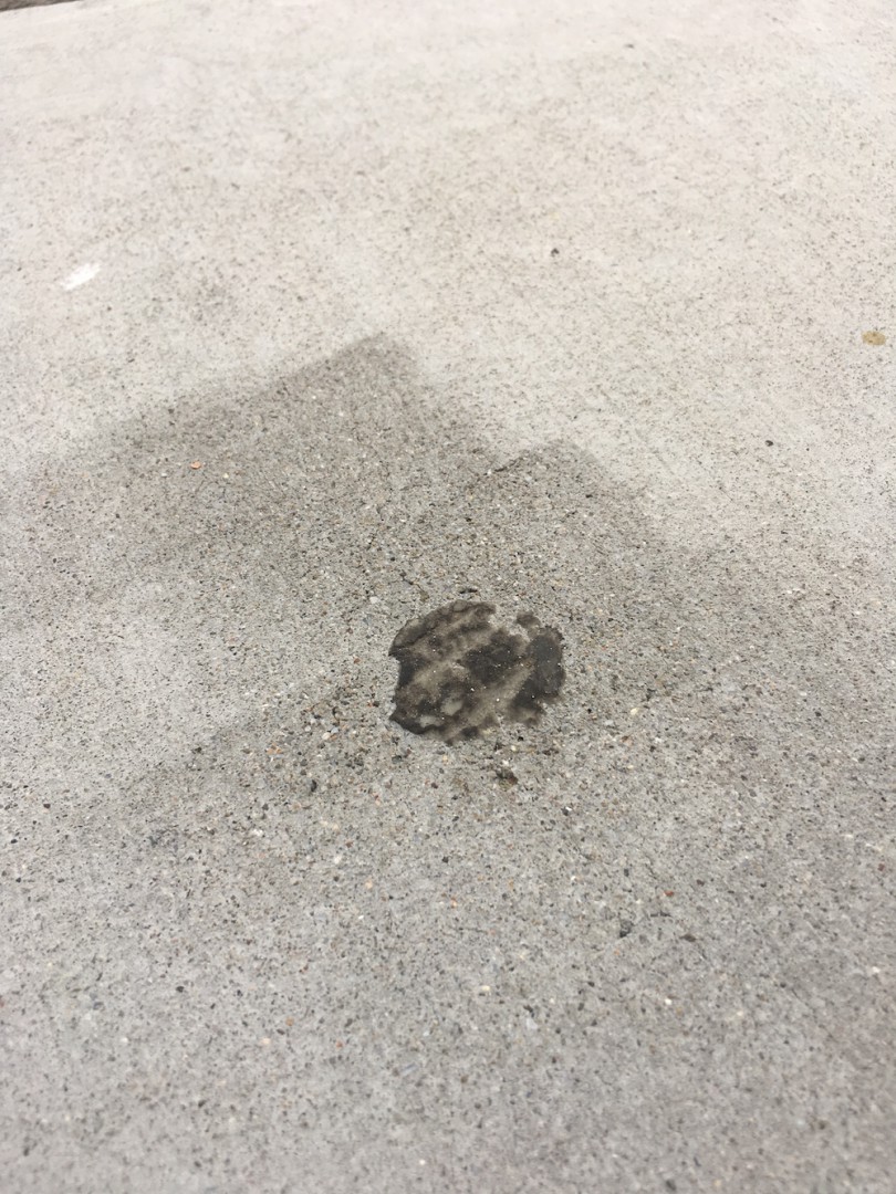

I wrote an article which was published recently in Concrete Decor magazine, one of the leading trade publications on decorative concrete and hardscaping. Although most of us successfully use power washing as part of our business, this article has specifically to do with modern high-end finishes that can be damaged using pressure washing. I would assume some power washing contractors may have a problem with some of the information I share in the article. However, we are the National Soft Wash Alliance. I will be posting this as a promotional post later on but I am interested in your thoughts, so I wanted to post it in a thread as well. I am including photos which unfortunately were not included with the article.

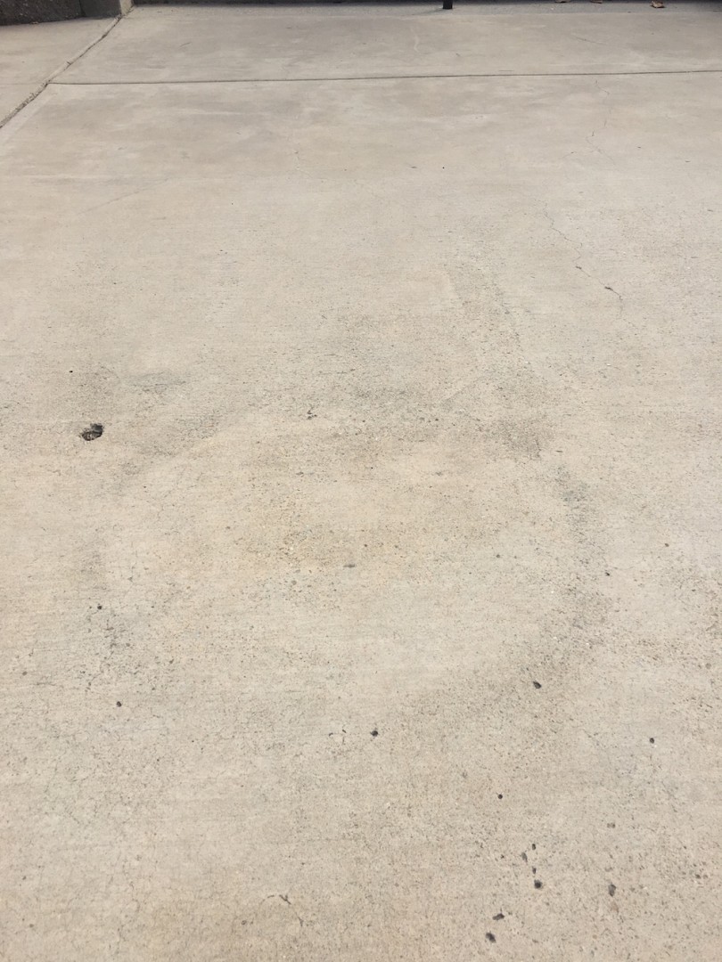

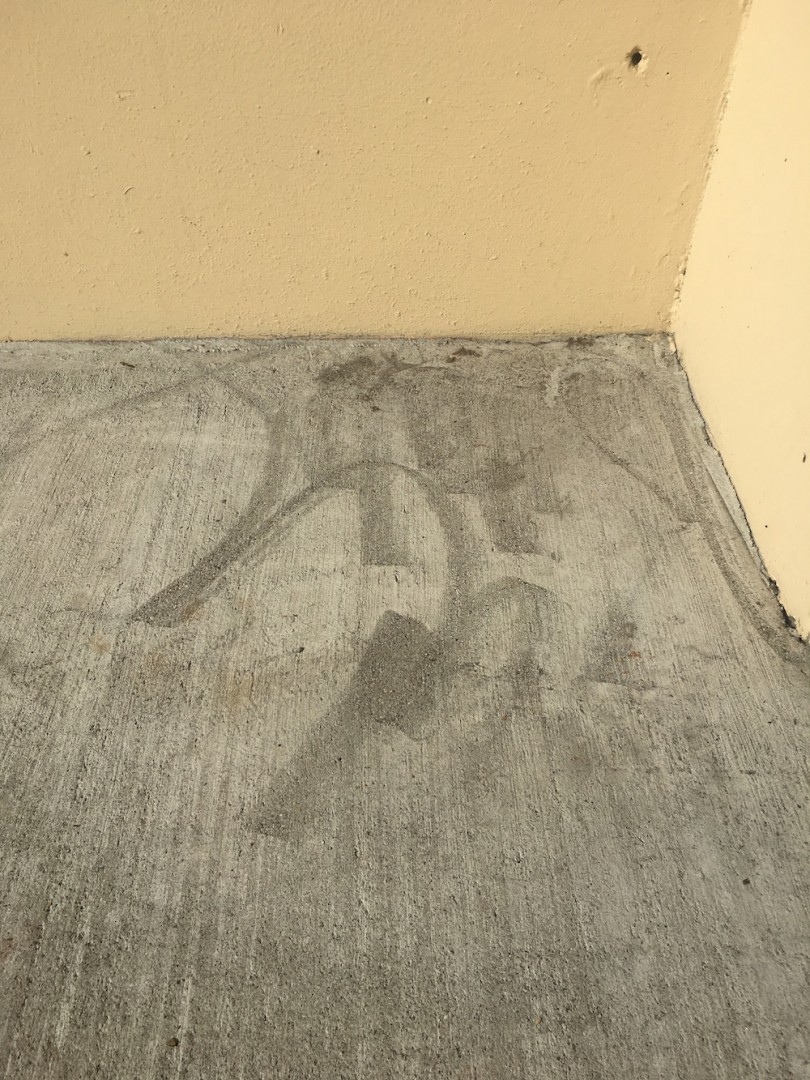

Typically when a pressure washing wand is used, keeping a consistent distance from the surface is simply ergonomically challenging. Use of a surface cleaner greatly improves this problem for field areas. However, surface cleaners are designed for close proximity to the surface, spray tips generally ranging from 1" to 2" from the surface. This is simply too close in many cases to safely clean without causing damage to costly, fine hard surfaces.
The facts show that professional surface cleaners can and do "cut" into the finished concrete surface, and the circular rings of damage are unmistakable. While power washing will always have a place in exterior cleaning, many modern materials and surfaces dictate that it should be used as an effective rinsing tool from 1 or more feet away from the surface, not inches.

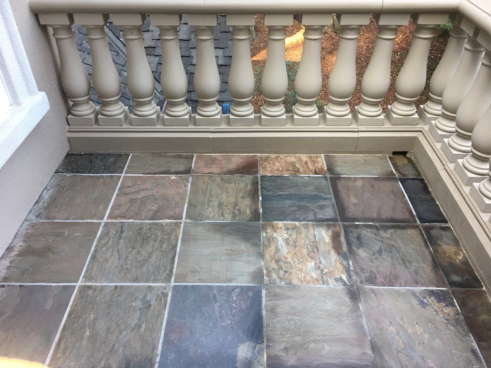

Other hard surfaces, such as stone, can be severely damaged using pressure. Many hardscapes use softer stones, such as sand and flagstone, which obviously need to be handled delicately. Sedimentary stone such as slate, flagstone and limestone can have a relatively high resistance to direct, vertical pressure but are highly prone to delamination and can be severely damaged by the use of pressure washing.

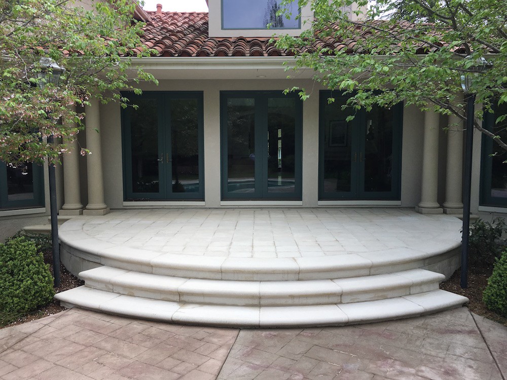

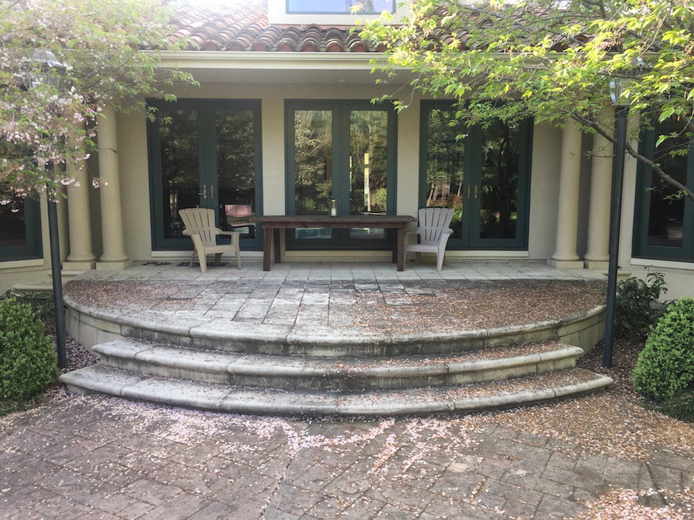

Well done Eric! Did you clean all in those pictures without a surface cleaner and just soft washing?
Mar 3, 2018
Thanks Brett, Yes those were done without pressure (other than for rinsing). We have all the equipment and definitely use PW's and surface cleaners but probably less than others.
Mar 3, 2018

Really looks great! You can see such a difference with all the colors restored in the hardscape

Great before and afters, the steps look amazing.
