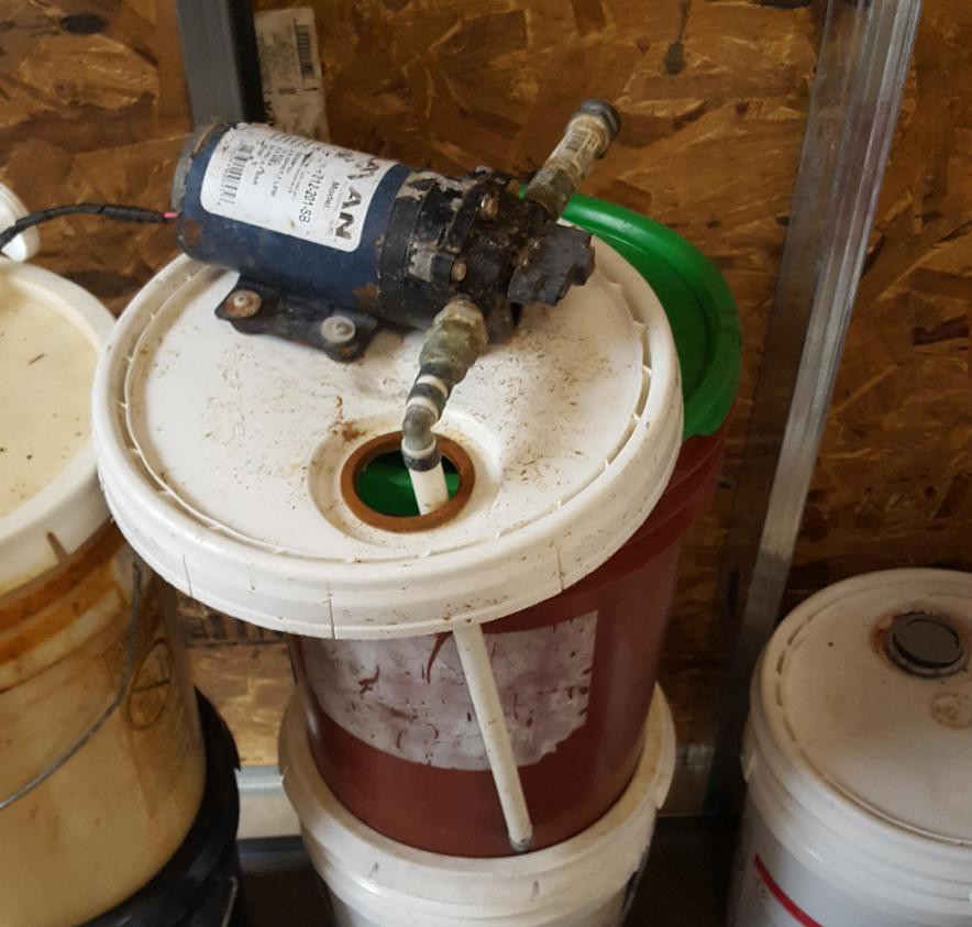

Thanks to David (Pinky) I learned how to clean wood. I built this simple 5 gallon applicator. Simple and easy.
For 15 years I had the pump & motorcycle battery bolted down inside the bottom of a plastic tool box The battery wasn't bolted down. I wedged a piece of wood and ran a couple screws into the wood to hold it in place. Drilled a hole on both sides of tool box, 1 for the intake and 1 for the out. Used 100' air hose for the out (cut it to 70' which was long enough for most decks.) & used 5' for the intake. Attach anything heavy to the end of the intake to keep it on the bottom of the bucket. You can put a quick connect on the end and attach your pressure wash gun to apply chemicals then remove the gun & attach it to your pressure washer hose. Or you can use what ever spray wand turns you on. You wind up the hose and attach it to the handle of the tool box with a Velcro strap. Carry it in one hand and a 5 gallon bucket of your mix in the other and you are making money! Mix the oxalic acid and stir it. It will dissolve. Most people think you have to use warm water to get the Oxalic to dissolve but that isn't true. Just stir it and it dissolves pretty quick. I don't know why this myth is out there unless they are getting some shitty Oxalic.

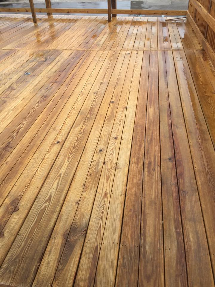

Here's the results using sod. percarbonate and oxalic acid. I'm pretty happy with them. Thank you all for your advice.
Looks great.
Are you planning on staining it?
If not it'll prob re-"grey" within a few months (or even weeks) from the UV rays.
A high iron oxide xontent stain will protect the longest.

That looks awesome
Renuwashing said
Apr 24, 2018
Thanks guys, the customer was going to seal it with a natural color sealer themselves. I haven't seen yet if they got around to it or not.
Thanks Brett! That is a pretty clever idea.

That looks awesome
