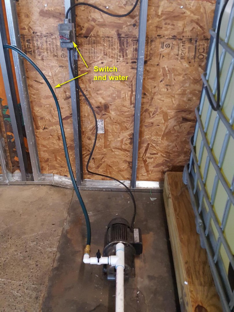

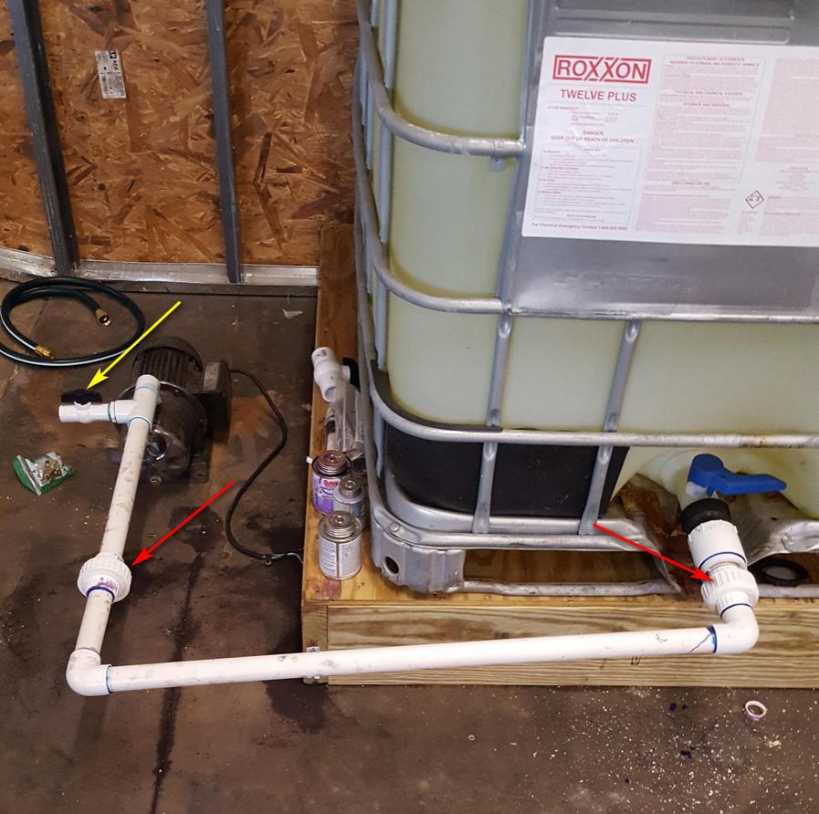

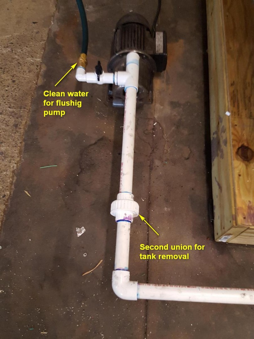

I am so tired of messing with SH we now have 300 gal totes delivered. We built a platform so it's higher than the pump. In the picture, the red arrows are unions so we can easily remove the plumbing and replace the tank. Yellow is for fresh water to clean out the pump. This is what I got done today and will hopefully finish in a few days. All 1" plumbing to the tank in the truck.
